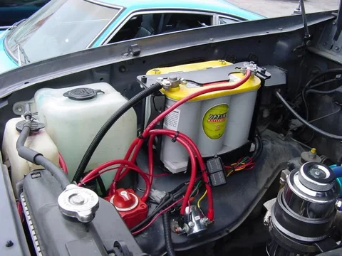

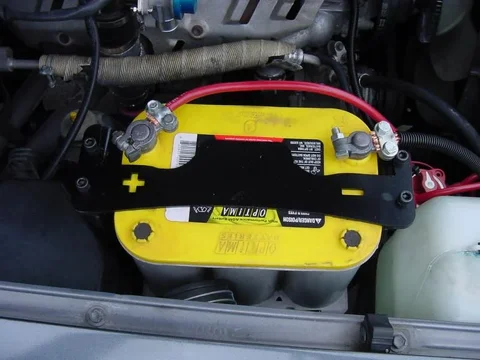

Also threw in another battery. Not that the original battery would not handle the extra load, but just because. Which I believe is a great motto around this forum, "just because" ;p
Bought a $40 mount off ebay and threw in a Yellow Top. Connected to a solenoid and Marine Switch, 2 relays, blah, blah, blah, works great. Have not cleaned up the wiring just yet. Plan on installing a 2000+ watt inverter soon as well.
