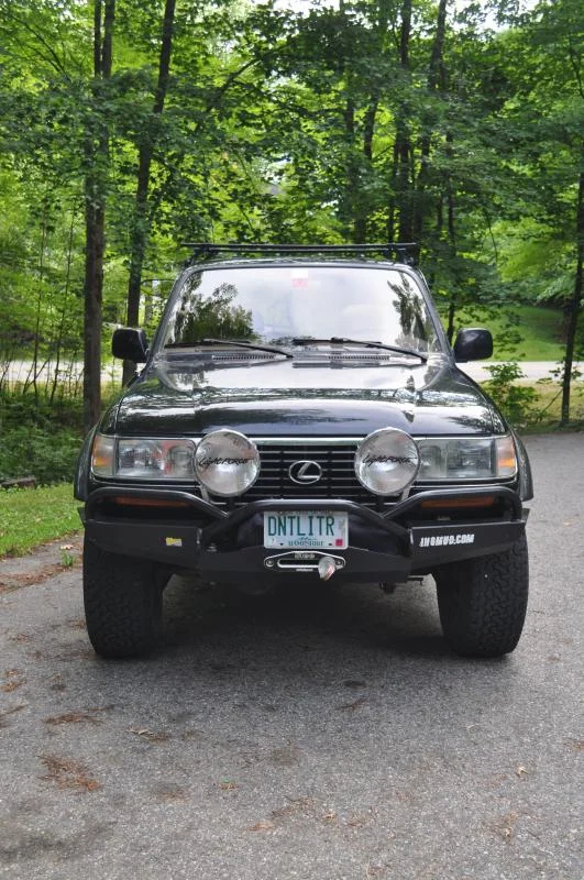

I picked up some used LightForce 240s from fellow mudder hewinutah (thanks for the easy transaction and good communication :cheers:)..
They are definitely big and my reaction of "man, those look ridiculous" is wearing away as I get used to them.
The lights came with clear covers and I also ordered a set of "Clear Diffuser Covers" and a set of "Blue Snow Covers" from Slee Off-Road. I had the chance to use the Diffuser Covers on a night run a few weeks ago and they worked well to push the light outward to illuminate the left and right sides of the trail (without shining upward to the mirrors of the truck in front of me).
They are powered with the Slee "Upgrade" and "Auxiliary" harnesses and switched in the cab with a $10 4-Runner/Tacoma fog switch (P/N 00550-35976 info here: https://forum.ih8mud.com/80-series-tech/312727-how-wiring-toyota-oem-fog-light-switch.html)

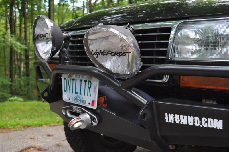

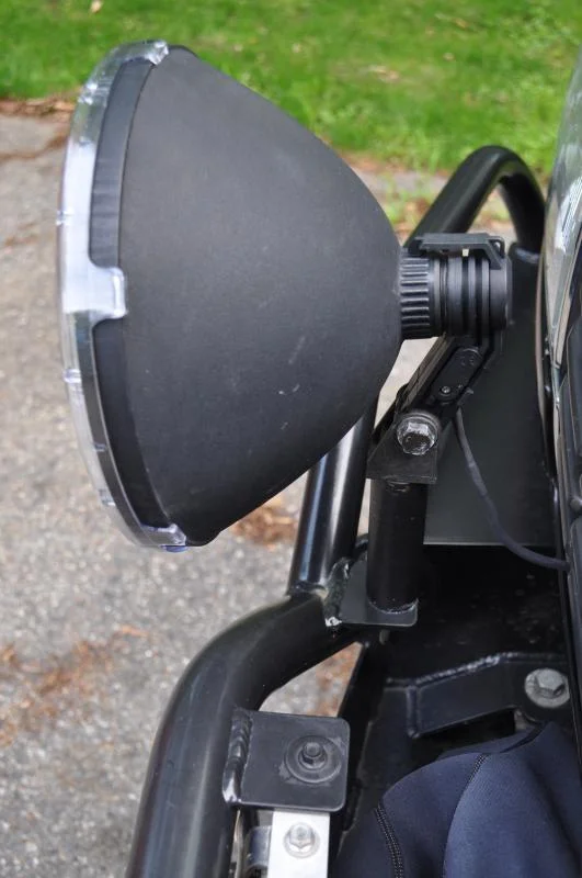

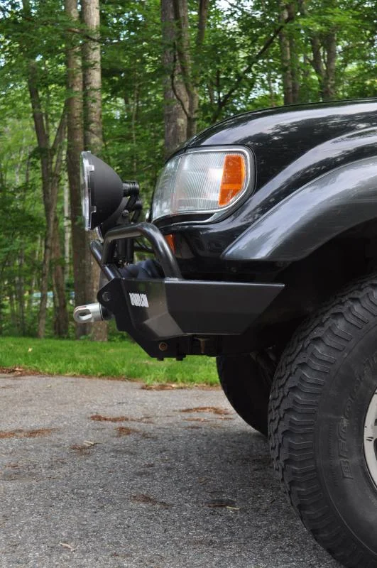

When mounted on the light tabs in the valley of the bumper, there wasn't any room to adjust them side-to-side or up-and-down (they were pointed a bit upward and out to the sides). I made some 4" spacers (two washers welded on either side of a section of pipe) to give them some room to move around. I made the spacers 4" so that I could point the lights downward fairly far (last image in the next post, below). However, after the recent night run, I realized that I would never need to point the lights downward that much. If I were to do it again, I'd make the spacers shorter by at least an inch. A shorter spacer would also look better as the light would be tucked into the valleys of the bumper a little more.
There aren't many pictures of these lights mounted on Shortbus bumpers, so here are some.
