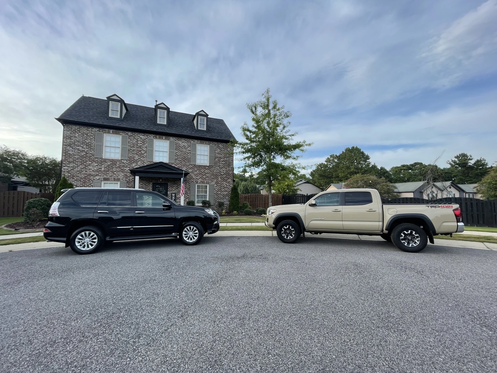

Wanted to document the mild build of my '15 GX460. I plan on doing a few extended trips in it this year, but its main job is to continue to be my wife's daily. The first thing she told me after we purchased it was to make it look "less like a soccer mom SUV". Challenge accepted.
We had plans to use it to haul a small camper behind it for the entire summer traveling, but those plans had to be postponed due to our first kid on the way. She still wants to do a shorter overland trip so the modifications have begun.
We'll be sleeping in the GX so a platform will be built to accommodate for that, but I need to get into our new house first to get my shop organized before I can start fabricating again.
First I'll focus on the exterior and all the things I can "bolt on" to help make the trip successful.
Here it is fresh from the dealer where we purchased it. Looks like a "soccer Mom's SUV" apparently.

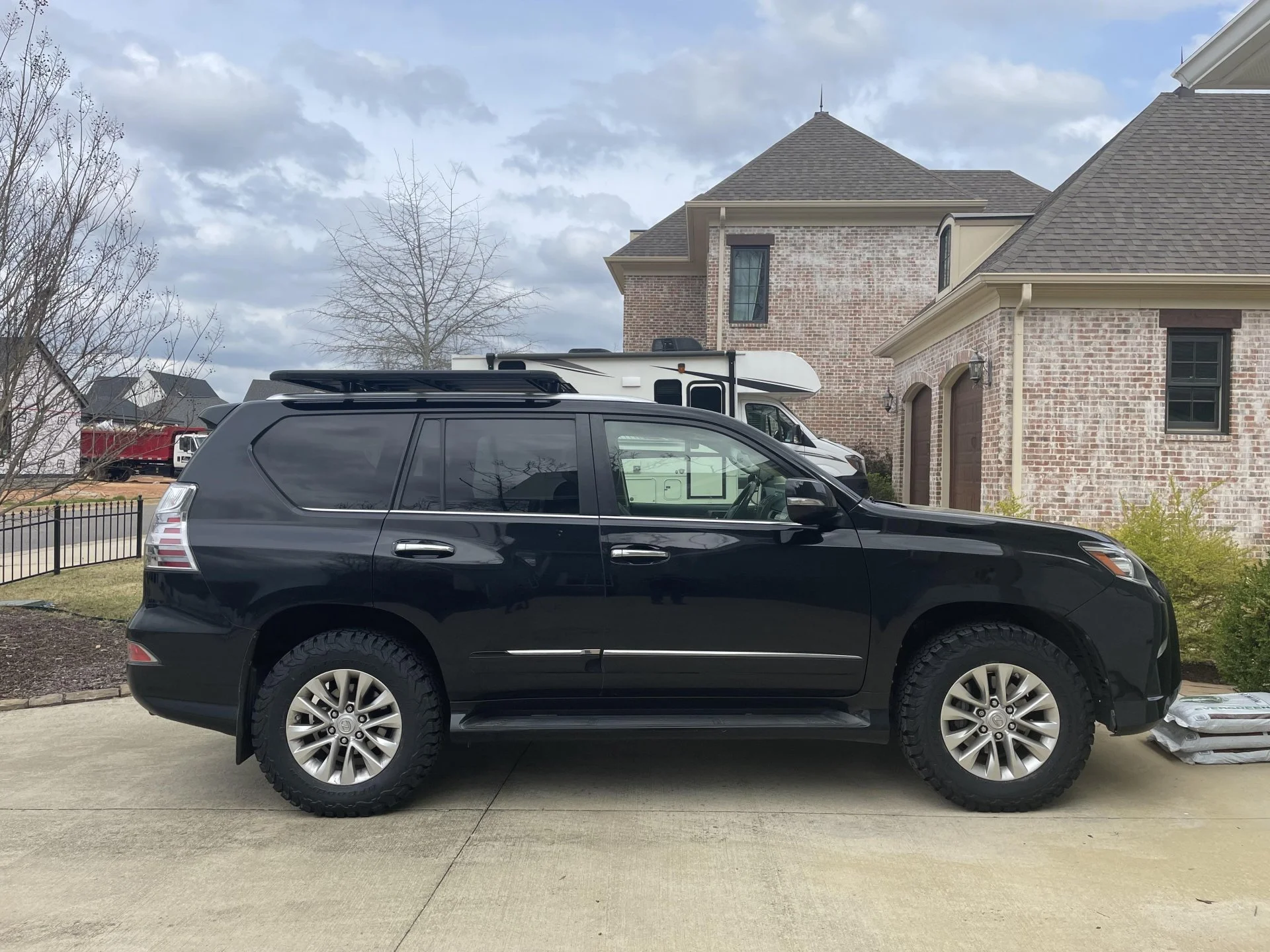

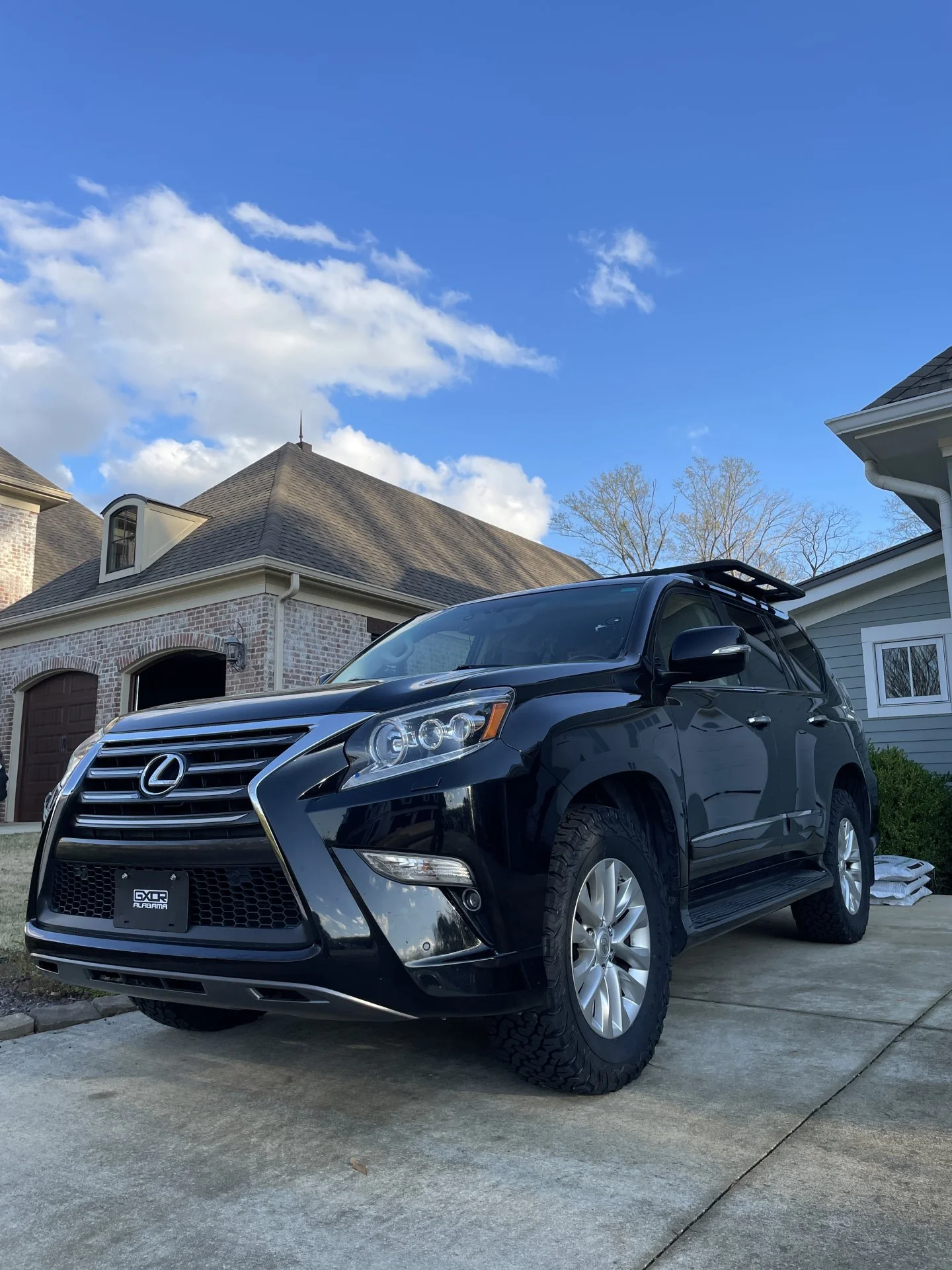

First order of business was to add a platform for carrying items outside of the vehicle. For that, I scoured FB marketplace and found this Rhino Rack Pioneer Platform for a Jeep Wrangler for dirt cheap. $75 to be exact. I ordered some LFD Offroad Ruggedized Crossbars to mount the platform to and voila, a large platform to kill my fuel mileage!
The next step was to fit the rig with some decent all-terrains for when we boondock out in the national forests and the roads get mildly treacherous. For that, I had a set of 275/65/18 KO2's installed on the factory wheels. It's the biggest I wanted to go as I have no intention to lift the vehicle aside from a set of 5100's to level the front out. She rides well with the E-rated tires on but I do feel the unsprung, rolling weight that was added. There is a little rub when reversing at full lock, but I'll either get the heat gun and fix that, or ignore it. My average fuel mileage feels it too sadly. I'll gladly compromise for the reliability of this motor and transmission from Toyota for fuel mileage though.

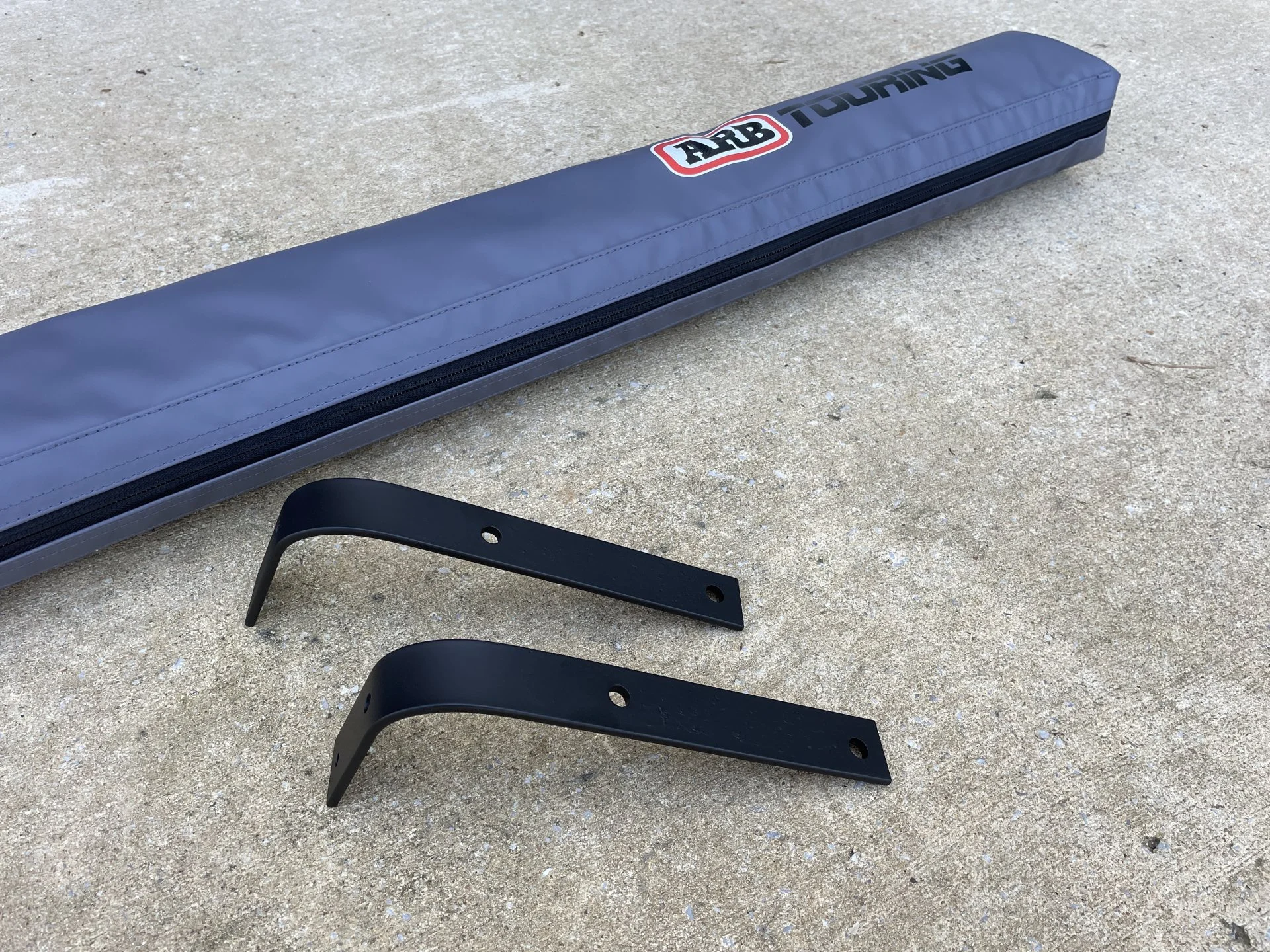

I'm installing an ARB awning onto the rear of the Pioneer Platform this weekend with brackets I have fabbed up using basic hand tools. Stay tuned for pictures of that install. Is it pretty? No. Will it work well? Certainly.

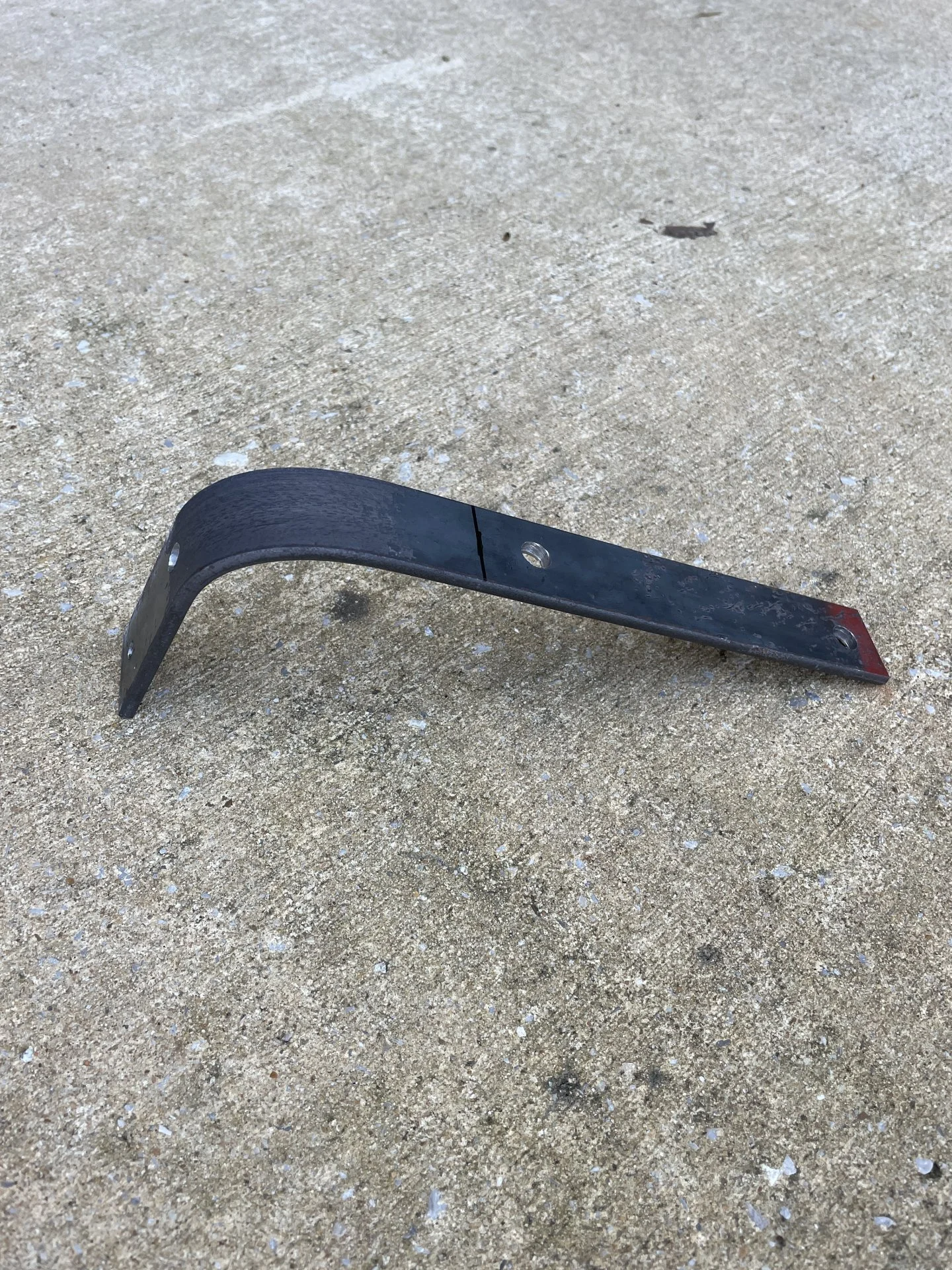

As I mentioned before, I have not yet set up my garage to be the shop that it can be as I am waiting for my tools to get out of storage from moving. Thus, I had to channel my inner-caveman and get my hammer and c-clamps out to fabricate a couple of primitive, yet sturdy angled mounts to attach the ARB awning to the rear of the GX on the pioneer platform.
I did not document the entire process of the simple fabrication of the mounts but imagine a man with a hammer, hacksaw, drill, and a can of spray enamel.
Here are a couple of pictures of the result. The wife has the GX today out of town so I will have to mount the awning tomorrow.

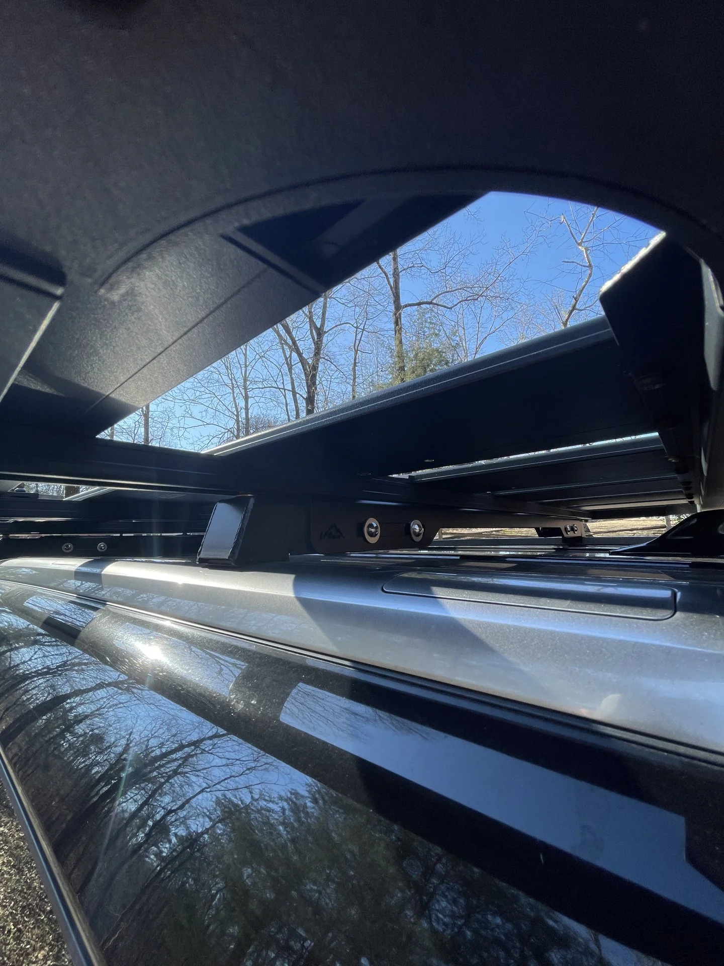

How are the ends of the pioneer rack put together? Can the 90 degree ends be removed and the center bars cut shorter? Looks like a good platform option. Seems like a lot of overhang due to the narrower GX. The most soccer mom looking item is the steps, the minute you remove them it really changes it

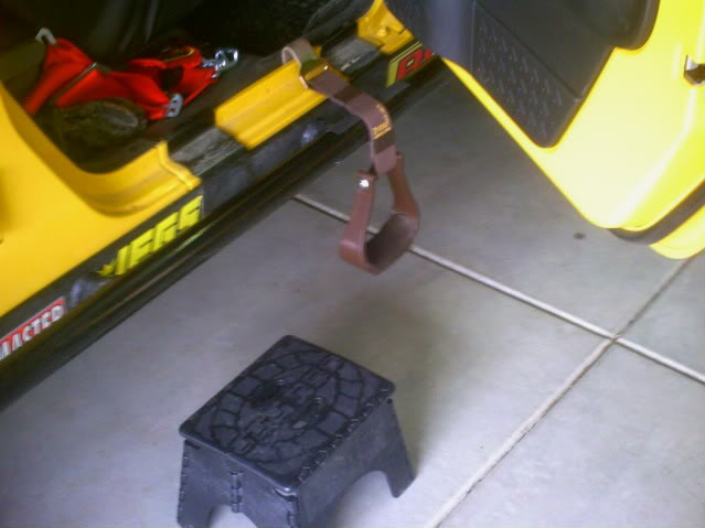

There is a lot of overhang, but the photos make it look more pronounced than it actually is. I actually bought it for my Tacoma and was going to cut it down to size it for that roof, but there is a lot of drilling and tapping that would need to be done in order to assemble the way it comes from the factory. Thats how it ended up on the GX. Possible? Yes, and I would probably prefer it that way. One day I'll unbolt it and give that a whirl.
I REALLY want to take the steps off, but the wife is short and wants them to stay... :( Maybe I can find a slider with a step?

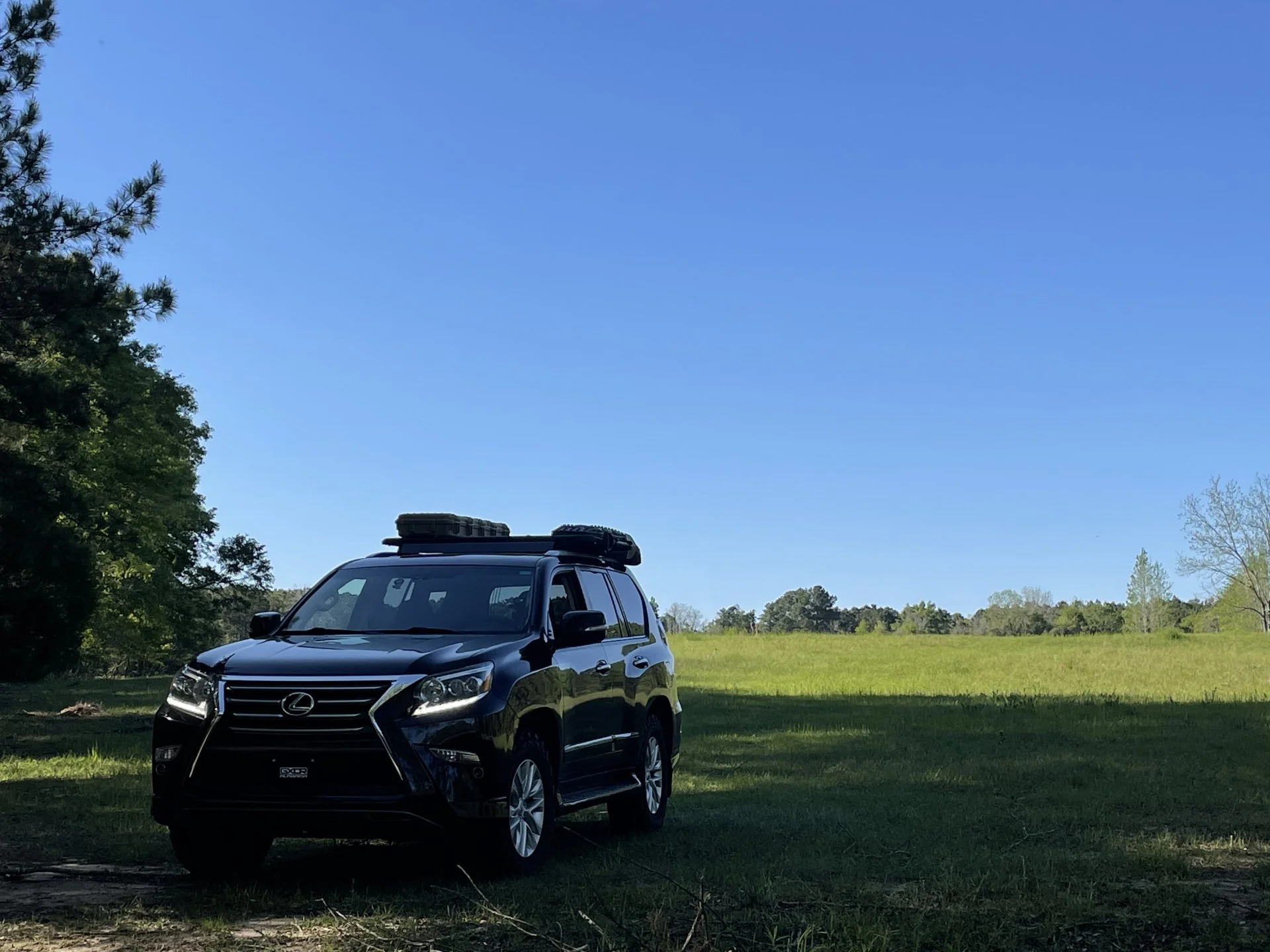

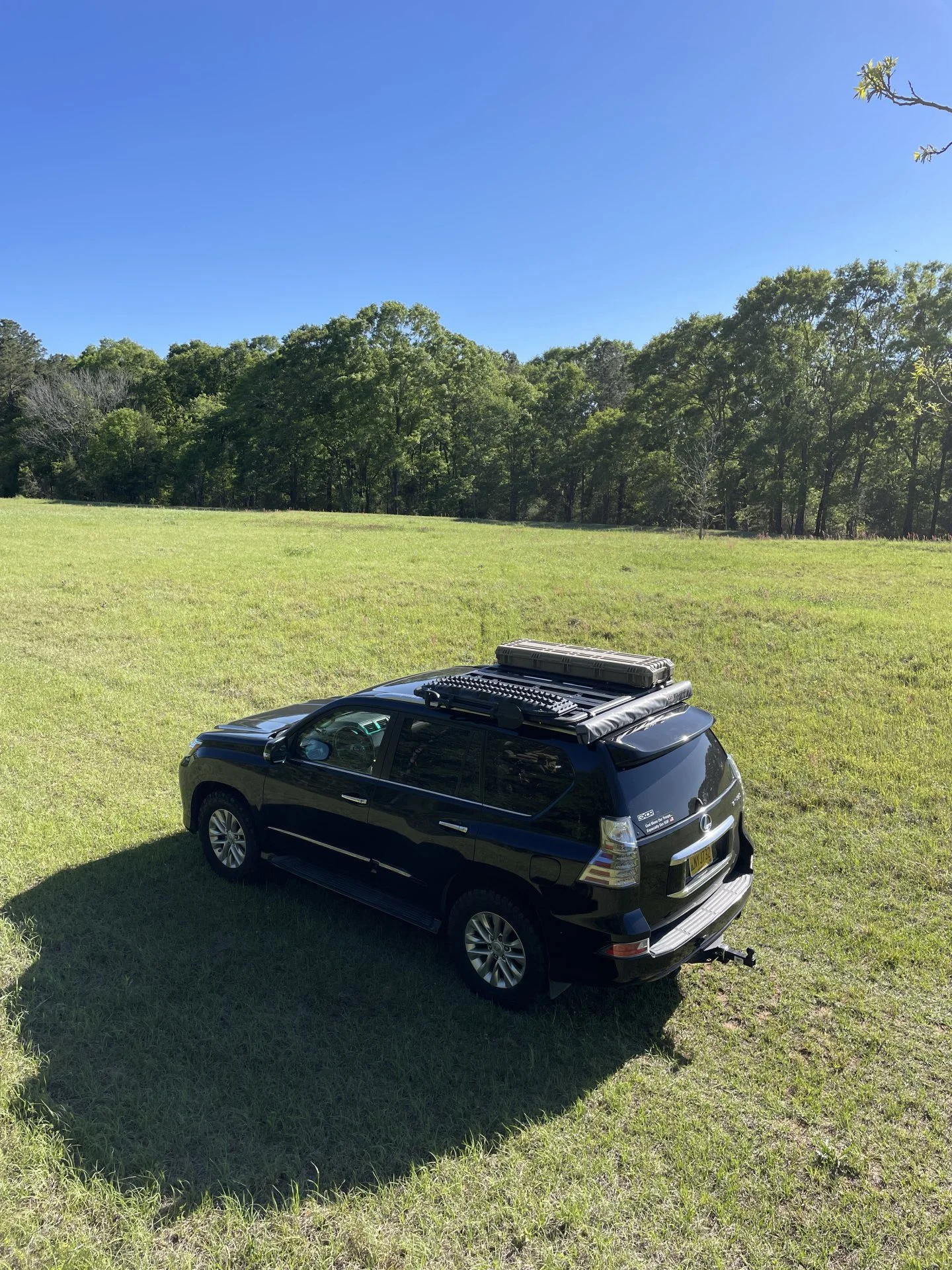

Here are some pics I took quickly while on the farm this weekend. The one from above was taken from a deer stand. I'll get some more close-up pictures to post here soon.

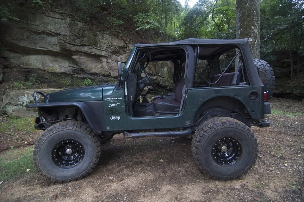

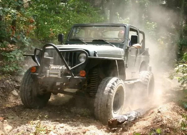

I have a lot of crawling/wheeling experience over the years so I am fairly versed in the art of wheel placement and recovery tactics (sadly..? Lol.). This build and its uses are just staying very modest by design.
Here is a TJ I built and wheeled HARD over 10 years ago. Full internal cage, regeared, double-locked goodness. Not to mention a full set of ungodly-expensive Dick Cepek Crushers to boot. I spent a lot of time over on Pirate4x4 in those days...
