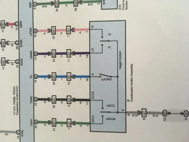

There must be a way to keep the OFF switch active so the air pump doesn’t run when under load or not level.
I think my plan in the future is adding some helper air bags and tie it into the factory air pump and leveling system. But I agree, it would be nice to be able to disable the pump without getting any dash lights.
I wonder if there is a way to wire in a resistor so that the car thinks the pump is running without turning it on. Not sure if this could also be an issue running down the battery, since on a trip loaded down would be the worst possible time for that to happen. I've never really paid much attention to what the car does when its not parked level if it stopped after a certain period of time or just doesn't try if its so far off level it can't do anything about it.
When I get some time I will pull up the wiring diagram and take a look.
You may be able to tap in at the console switch pin 16 and go to ground. It’s just a momentary ground going into the ecu. But that may also cause it to throw a fault for having a constant ground.
