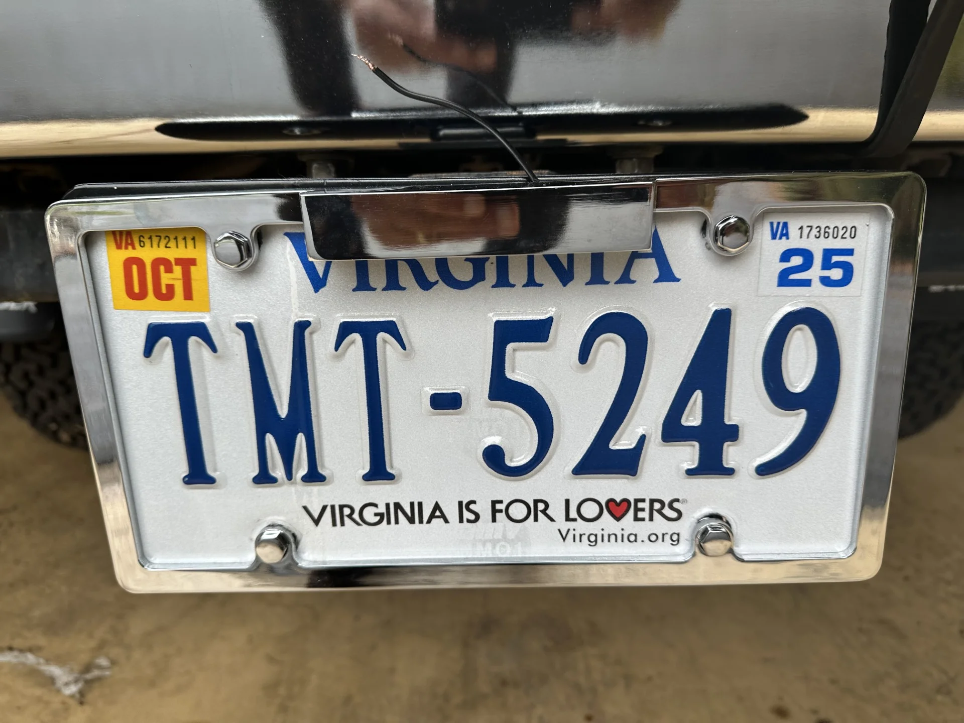

I bought a license plate frame with 12 volt LED light. The light is not working when I connect the wires to the license plate wires from the truck. Does LED lights need a transformer to work with the trucks wiring system?

Ahh. Bumper mount. Can you give us a picture of the bulb holder and that wire connecting to it?

Yes the Hot Dog stand is till operating. I found the issue regarding the light. It was a grounding issue because I had a powder coated mounting bracket it was not making a connection. Light works now. Thank you for your help!!
