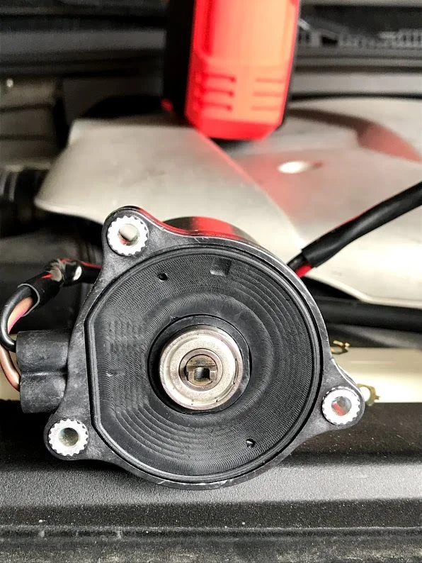

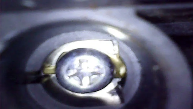

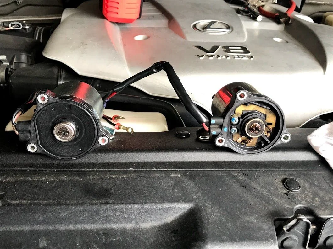

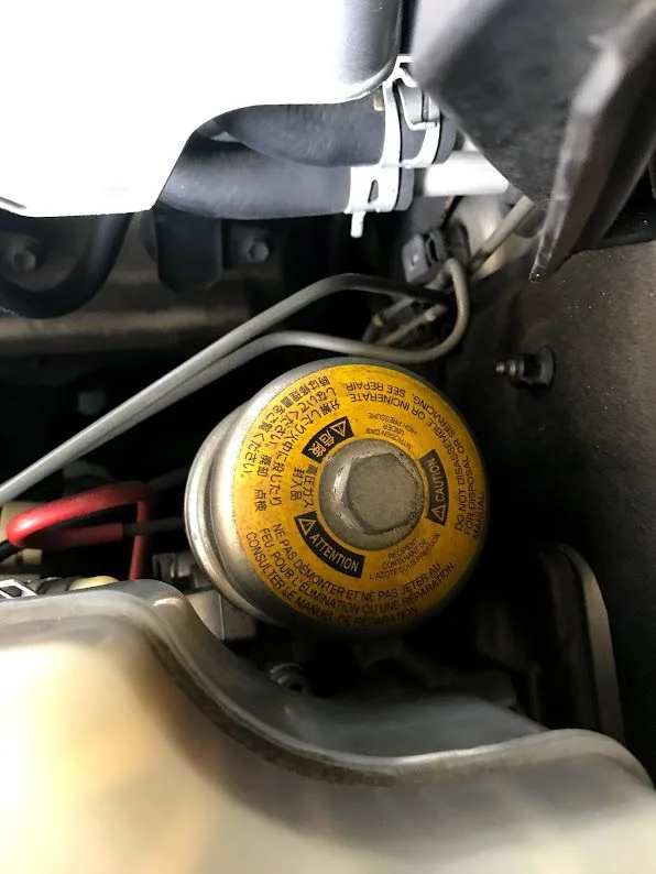

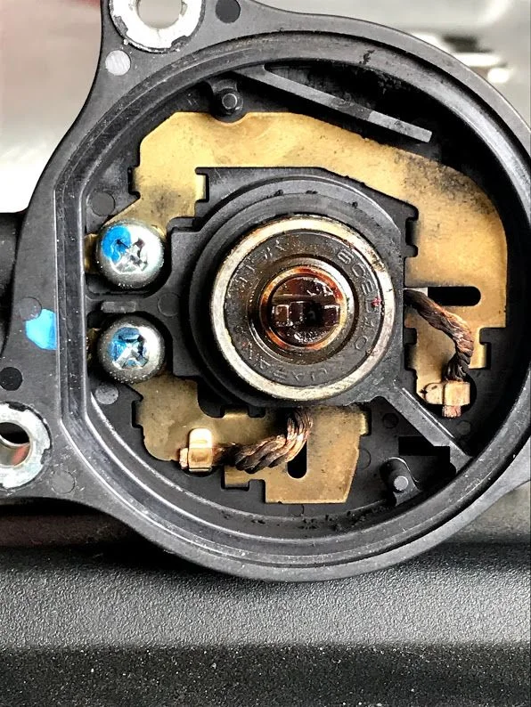

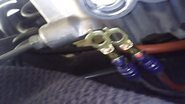

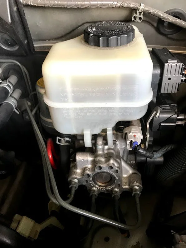

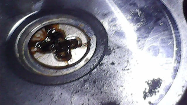

Hi everybody, I did it, I replace the Electric ABS Motor without removing the MC on my Lexus GX470 2006.
The MC on 2006 - 2009 is a little bit different. Just need to have a lot of patience, few tools, and regulars skills on your fingers.
I bought the Electric Motor for $254 at Wholesale Parts Express 888-241-8277.
