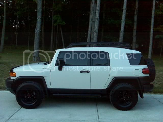

Would 17's with 35's or 37's be the best without having to re-gear, I am very new to this. Fell in love with Fj's after seeing my brothers fj40 and 62. The Fjc just caught my eye and have heard of only great things about them. Thanks for the help.

I was thinking you might want to look at 17"s with 35s, but then again, those tires look aggressive enough to take off and have some fun with. Not much airing down, though.

Thanks, those 33's are so damn expensive I don't really want to go tearing them up, and yeah, no airing down.

35's are really the biggest diameter tire you can put on an FJ without regearing. Even then it is recommended that you regear, but not everybody does. Your choice. You could do a 17" wheel if you'd like with a 35" tire, lots of people do this size setup. If you thought your 33's were expensive wait till to check out the 35's. Of course this all depends brand to brand, but generally the bigger the tire, the higher the price.
When I put my 34" tires on, the cruise control drove me crazy until I re-geared. There's no way I would go bigger without re-gearing but YMMV, my truck is real heavy too so that affects it some. If you never drive on the highway or use your cruise control you could get by without I guess.
