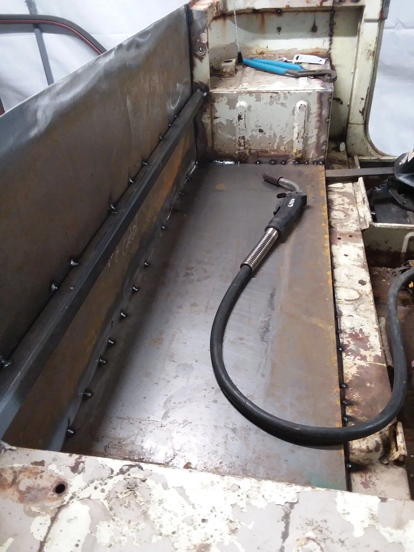

Last picture of the day. Floor for the rear of the tub cut and tacked in. This will go from side to side and tie all of the sheet metal together. I'll have to brake a corner for the front to tie it into the actual floor unless I decide to get creative there. Then the slow process of welding it all out starts. After that I can finish the tailgate structure and the front panel.

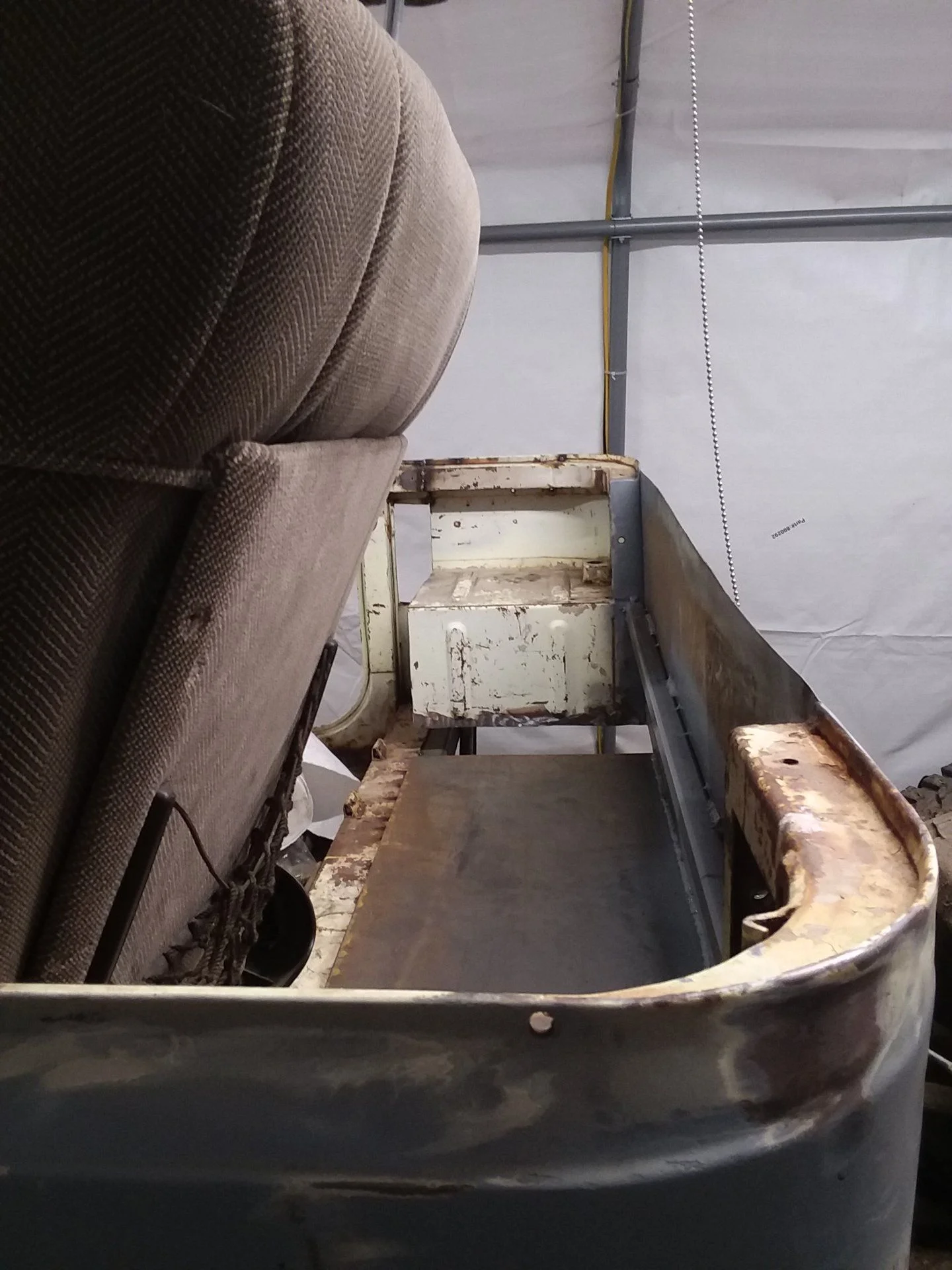

Knees and back are shot finishing out the stitch welding on the sheet metal, so I decided to mock up the seat and place the hard top pieces for an idea of what I was working with space wise. With the factory 80 seat mounted 7" from the floor pan, it felt like it should. The steering column placement was spot on. Tilted right where I wanted it. Behind the seat, with the seat laid back a little but comfortable I have 9" before it contacts the hard top in the rear. I LIKE IT! There's still a good amount of sheet metal work that needs to be done. I will most likely get it all stitched together in the next few days. Shoot some primer on it so that I can set it all aside as one piece to start on finishing up the harder work on the frame. Looking at all the half- A$$ mock up stuff that I did down there is killing me.
Looks nice and will be very serviceable, you got go slow to go fast.
Very true and it will take a few more hours to get what I have tacked welded out. I'm trying to bounce around on the pieces to keep the warping to a minimum. I already got carried away and warped one section. So took a break to play with other things. At least most of this will only need to be shot with primer before covering it up with another sheet of steel. I have some outside beads to grind and I'm sure I will be creating many more.

It's nice to get a visual of your seat placement and how much space you still have. I'm still in the planning stages and trying to decide on how much of a stretch I want to do.

ON the 80 chassis I was concerned with the room left over for a bed without having to stretch the frame. Initially I figured It would be essential to do but I didn't want to make any decisions until the tub was sitting on the frame. I was pleasantly surprised that my minimalistic approach to the cab left a nice area for the bed without any stretch.
In the end you can make it as long as you want but there comes a breakover point of diminishing returns with just building a crew cab. As it will just be me on the trails, perhaps a friend as co-pilot the need for two more doors was non-existent. Add to that it didn't fit into the design I had in my head. I wanted a comfortable pickup with lots of leg room and storage behind the seats. I feel like I got exactly what I wanted there.
