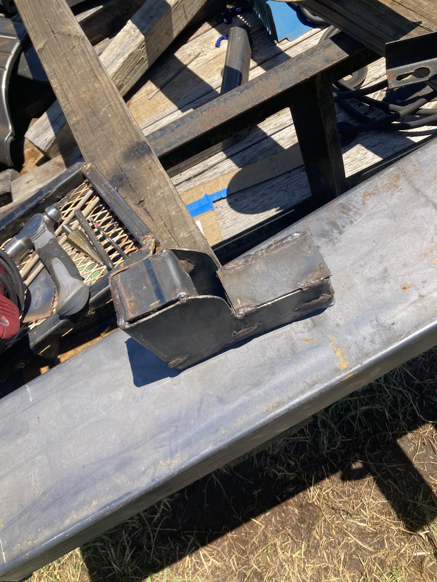

Fabbing a reinforced stand off for the AUX battery
