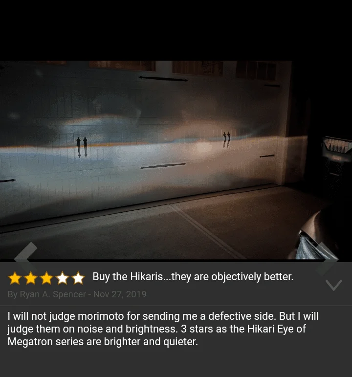

While reading the reviews and looking at pictures on Amazon for the morimoto 2stroke bulbs I came across Hikari eye of Megatron bulb in picture comparison. The Hikari had better results but a few people said the bulbs dies In a year, under 2 years, and one guy at 8 months out of about 2000
However at a price tag of $120 for the Morimotos I thought I would try the $40 hikari light bulbs first. See what they look like, if I like LEDs, and rotate and play with them in the housing. If one of the Hikari fails quickly then I can get a pair of the 2strokes and then I'll have a spare bulb to use if the Morimoto ever fails and there is a wait time for delivery.

Morimoto 2strokes vs Hikari comparison I saw. The second picture is the morimoto 2 strokes in the high beam housing.

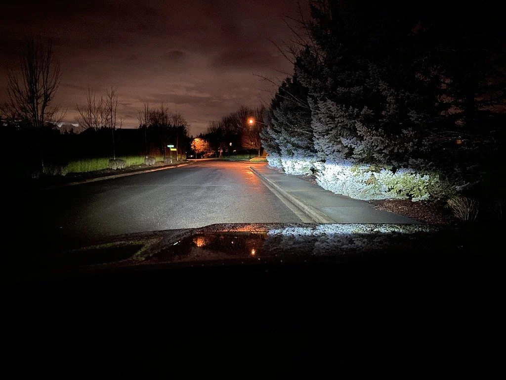

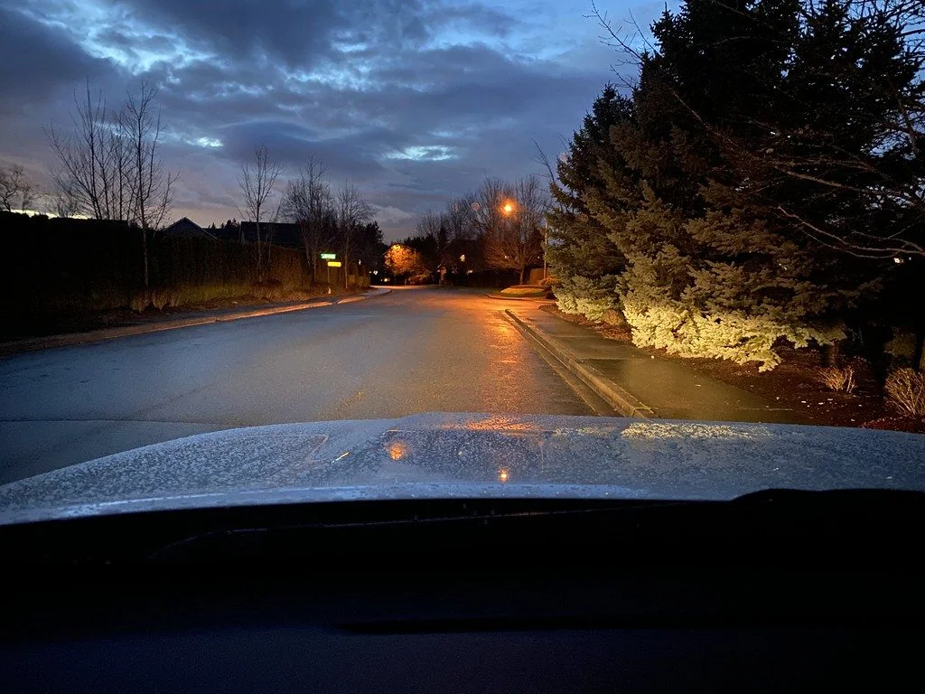

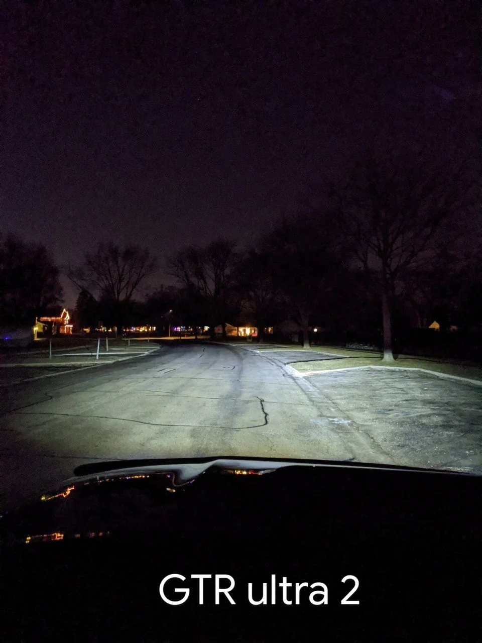

Another one that fits under the dust cover is the GTR Lighting Ultra 2.0
See before and after pics below

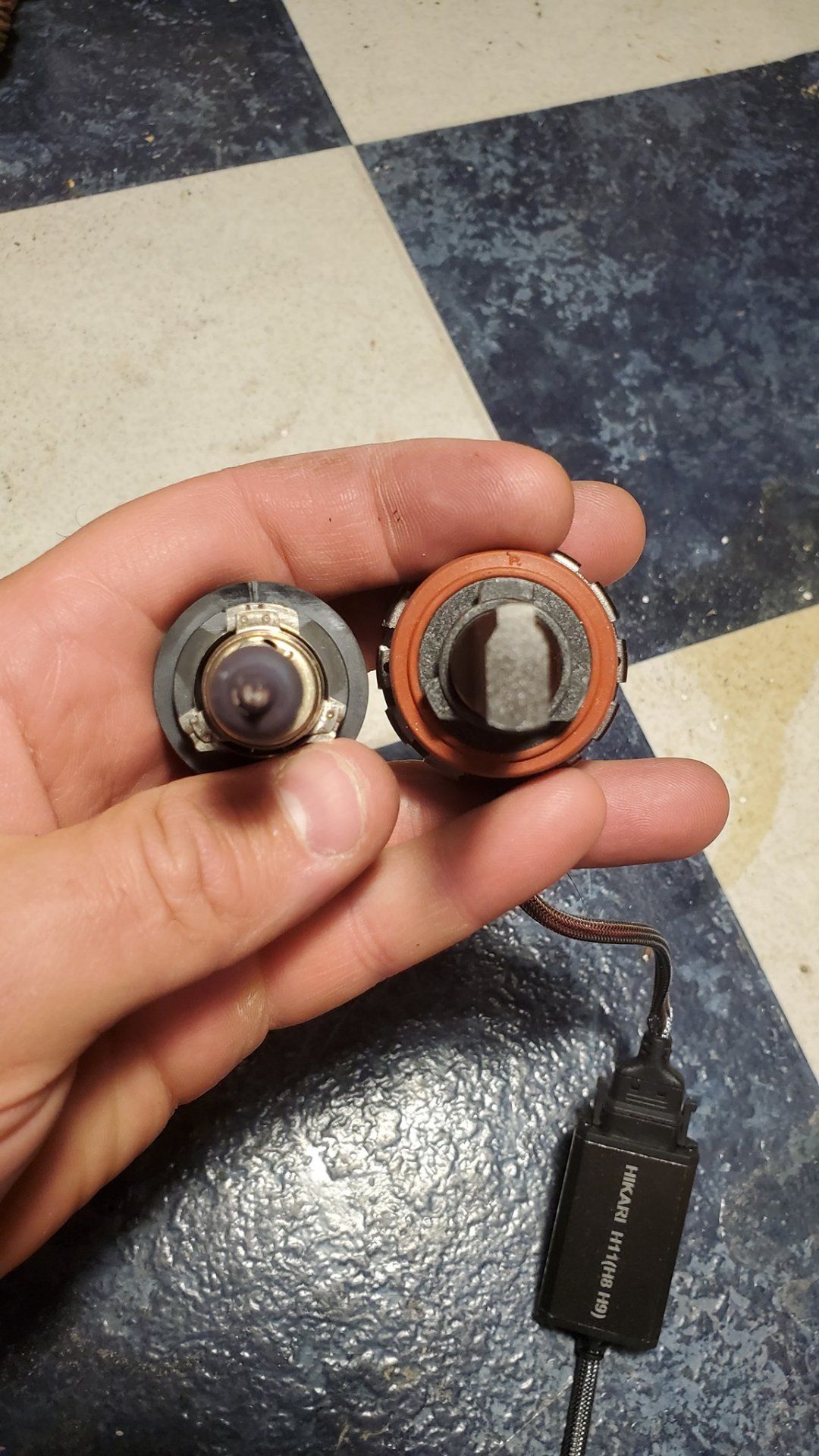

So some fans and fins at the back of the bulbs are too big. They are used to cool the bulb. If too big it won't go into the bulb notches. The dust cover won't snap back on if the fins are too long and sticking out of the back of the housing.
The mods are to grind or file down the fins/aluminum so that it fits. I personally just want a good bulb that fits with no issues. I also would prefer not to spend $200 on LED bulbs if I don't have too. If I need a new bulb down the road asap, the last thing I want to do if I'm too busy is mod a bulb. This way if I find a good bulb that works well the wife can reorder the bulb if she sees it go out and I can change it quickly.

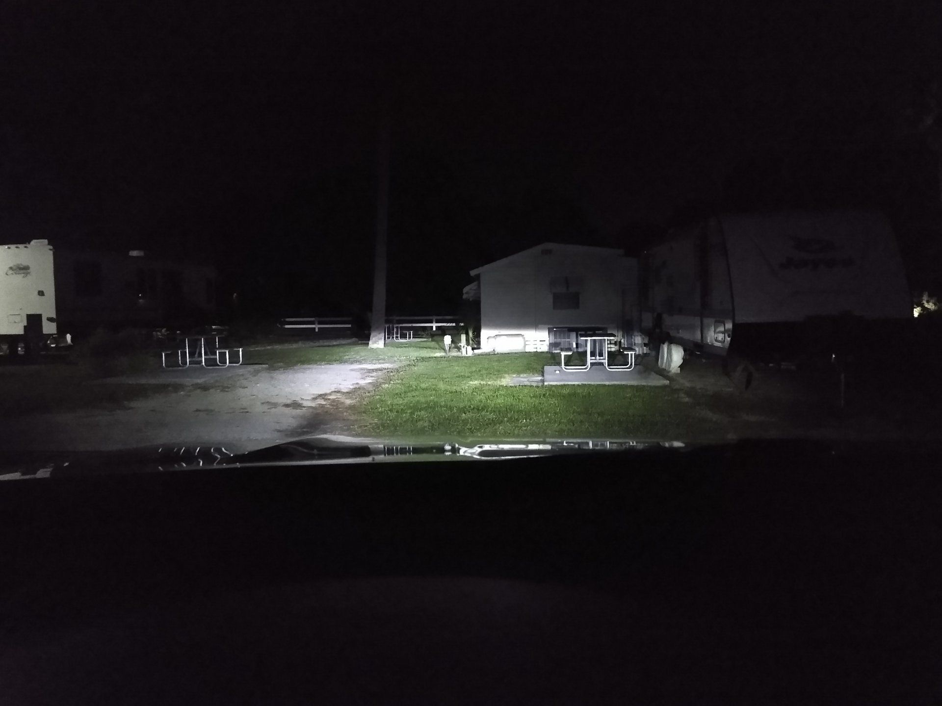

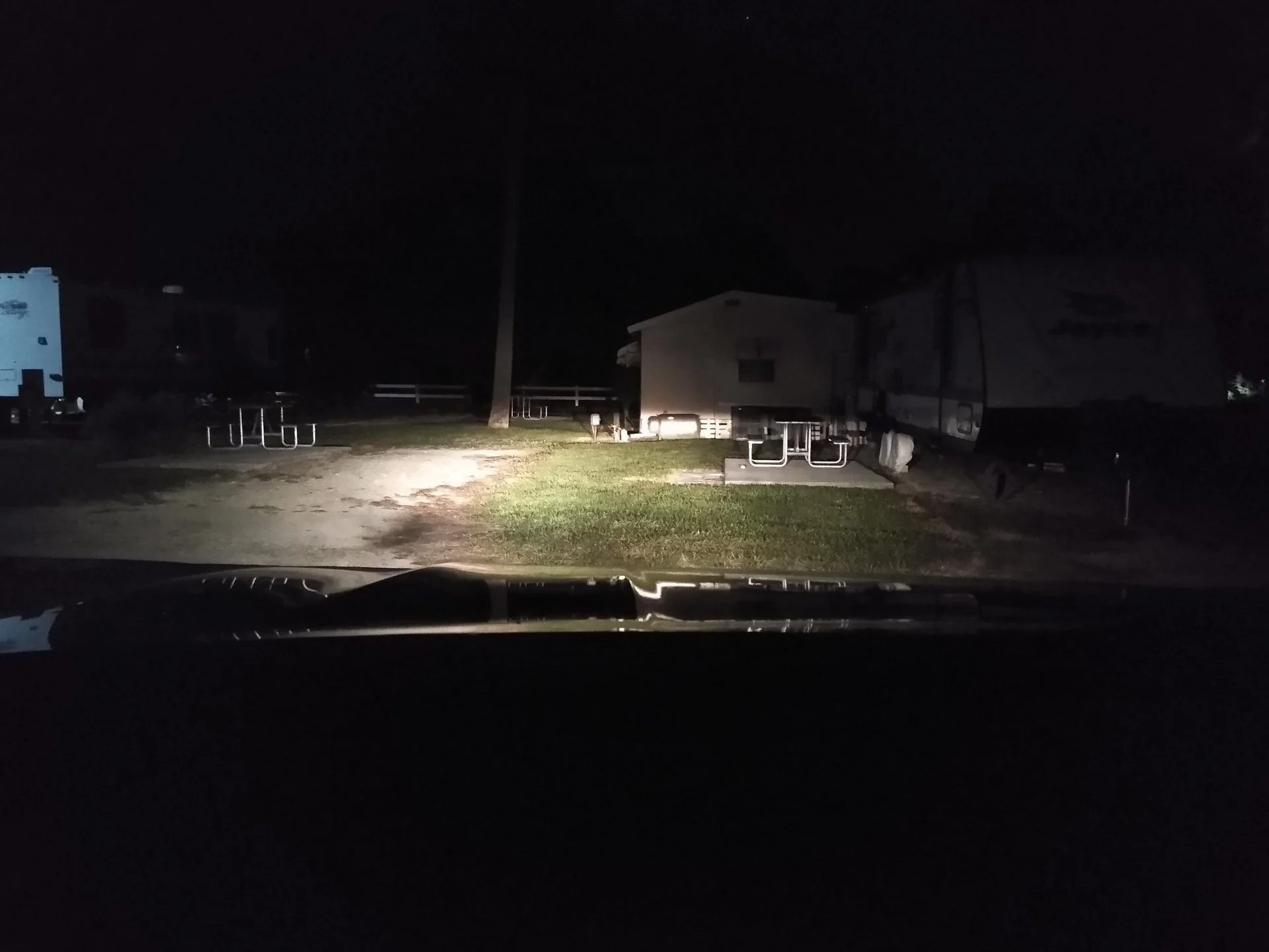

Here is the lower lumen/smaller Hikari bulb comparison. The bulbs arrived just before we headed to a campground for the weekend so it was a little late before I could swap them out, but here it is.
Notice the lighting on the fence and the palm tree in the background. The cut off line looks a lot stronger and brighter on the palm tree. The Hikaris really light up that snow birds' propane tank straight ahead but that may be more because the bulbs are whiter. It's not a huge improvement but a little better. I would say go with the Morimoto 2strokes if you want the best quality and don't mind spending more. These seem like a similar replacement to stock. Even Hikari says these are 10,000 lumens while the larger eye of Megatron bulbs are 12,000 lumens, and those are similar to the 2strokes so 2 strokes will be my next set. I still have to drive around, but it looks better overall though. Good test and worth the money I think.

Here is the lower lumen/smaller Hikari bulb comparison. We got the bulbs just before we headed to a campground for the weekend so it was a little late before I could swap them out, but here it is.

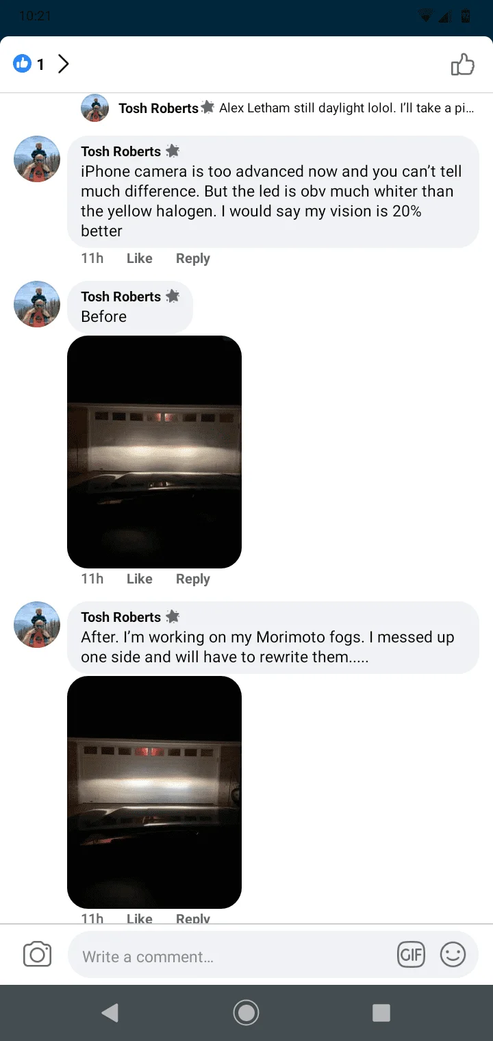

Saw this on Facebook. Morimoto comparison shots, but read the comment right before the pics
I ordered some of those eyes of megatron Amazon product ASIN B077BT6M6Z. They don't fit in my 460.
pretty annoying. I can get them to line up, but they won't twist to lock. No matter how hard or what leverage I use to turn them. Going to send them back and look for something else. So far, nothing really seems THAT worth upgrading?
Did you try swapping the rubber seal? Usually that needs to be done anyway, not sure why but it's common to be done. But I don't think the dust cover will close with the eye of megatron, which is why I didn't get them.
Yeah, tried swapping seals and everything. No dice, they set in the noches, but I can't get them to turn, so I'm returning them.
