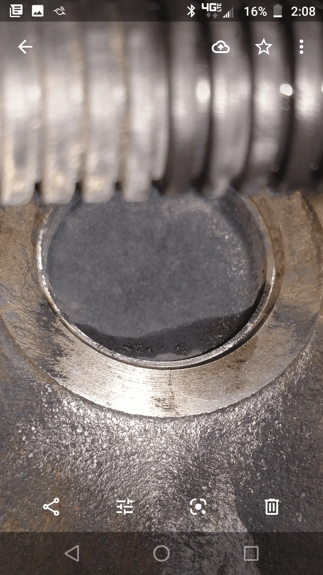

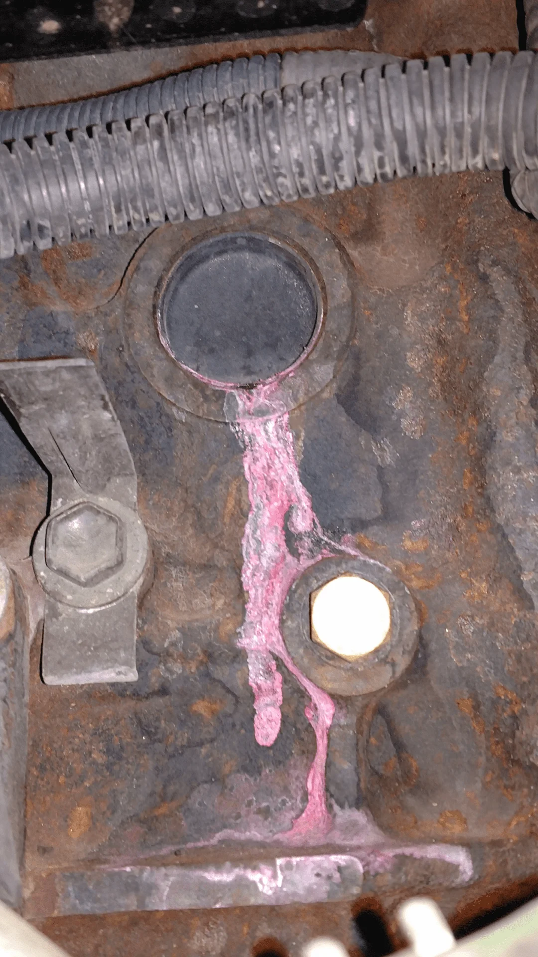

Another bump here... I ground and a epoxied the crack with JB Weld and replaced the freeze plug but my leak has resurfaced.

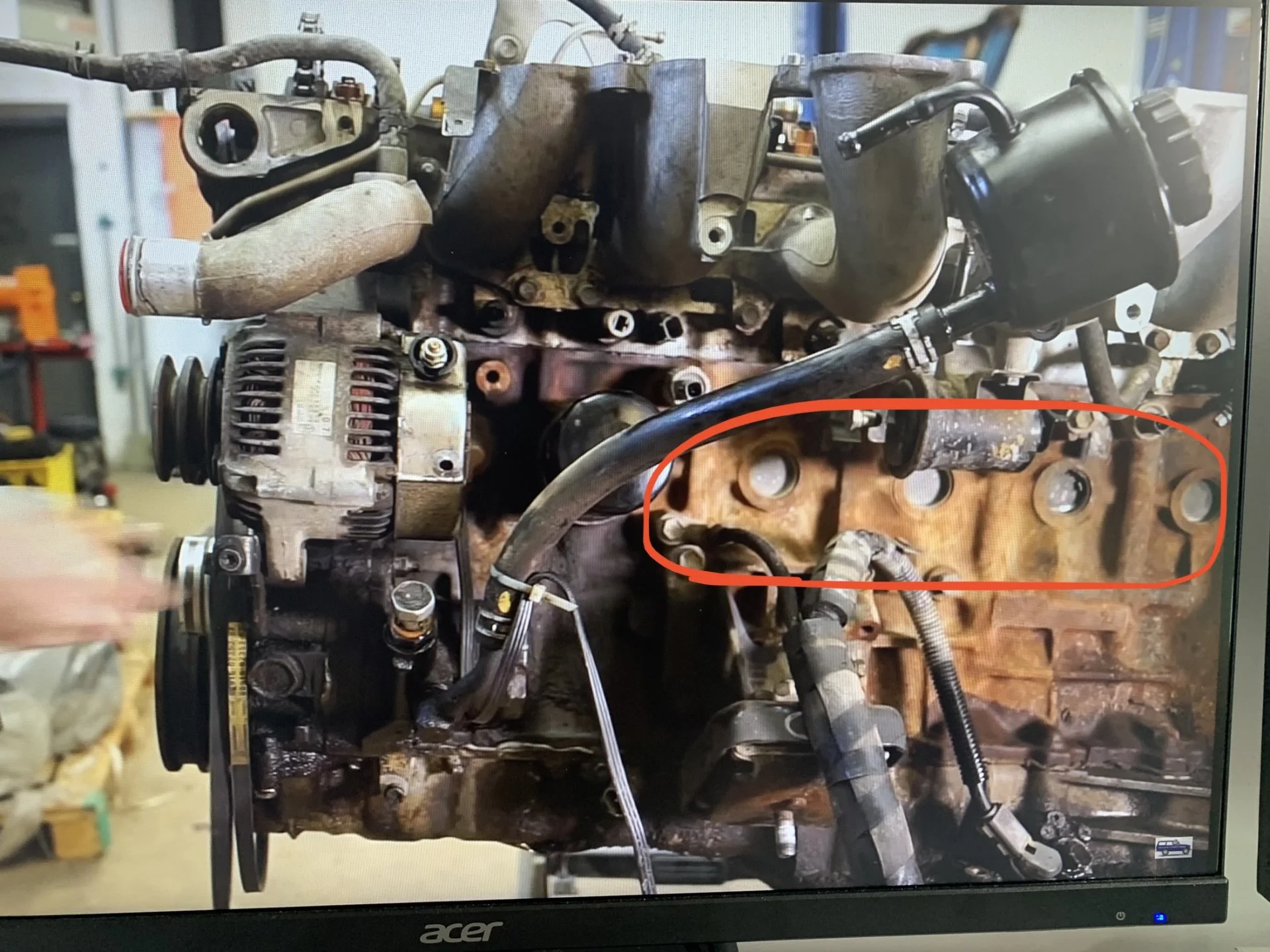

Found this today, the freeze plug is out further than all the others, maybe just tap it back in or replace it?

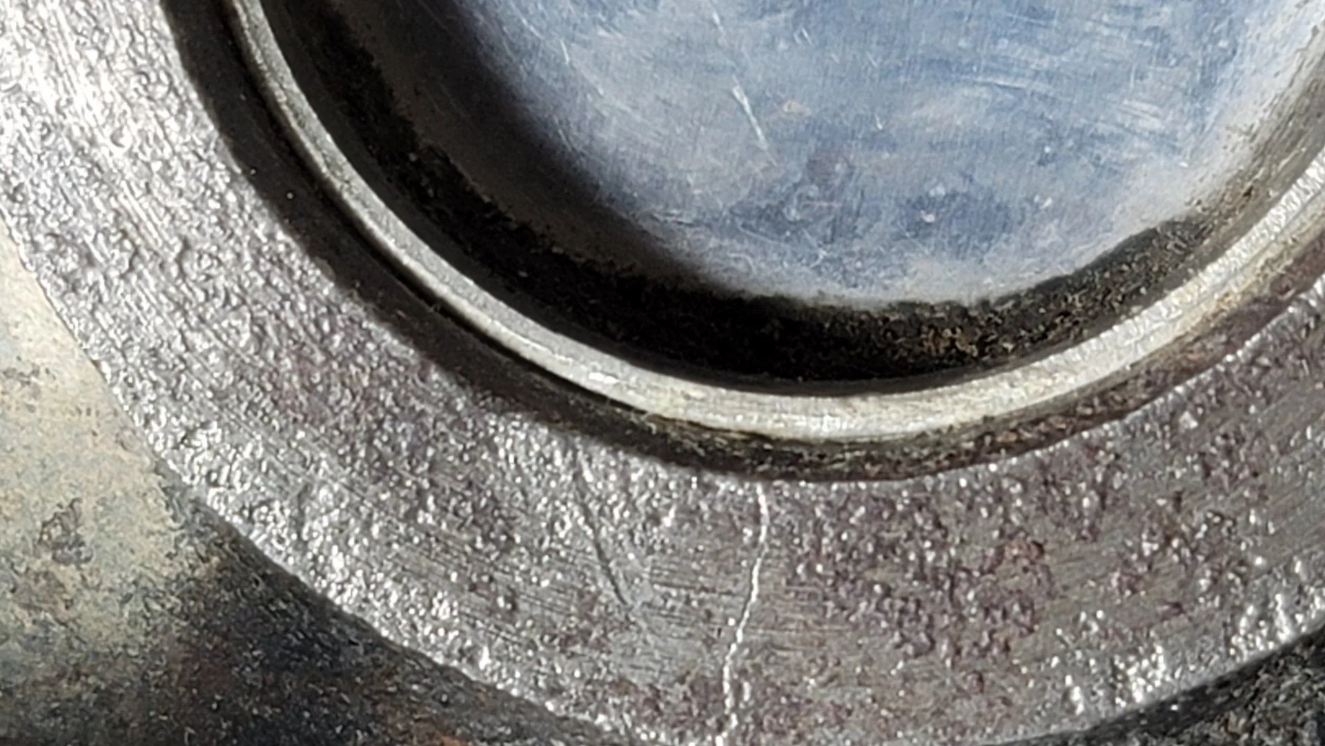

Have you read through this thread? Looks to be the same spot that several people have had coolant leaks, only to find that the block is cracked just under the freeze plug.
I’d clean the area thoroughly and investigate closely to see if you have the infamous crack.

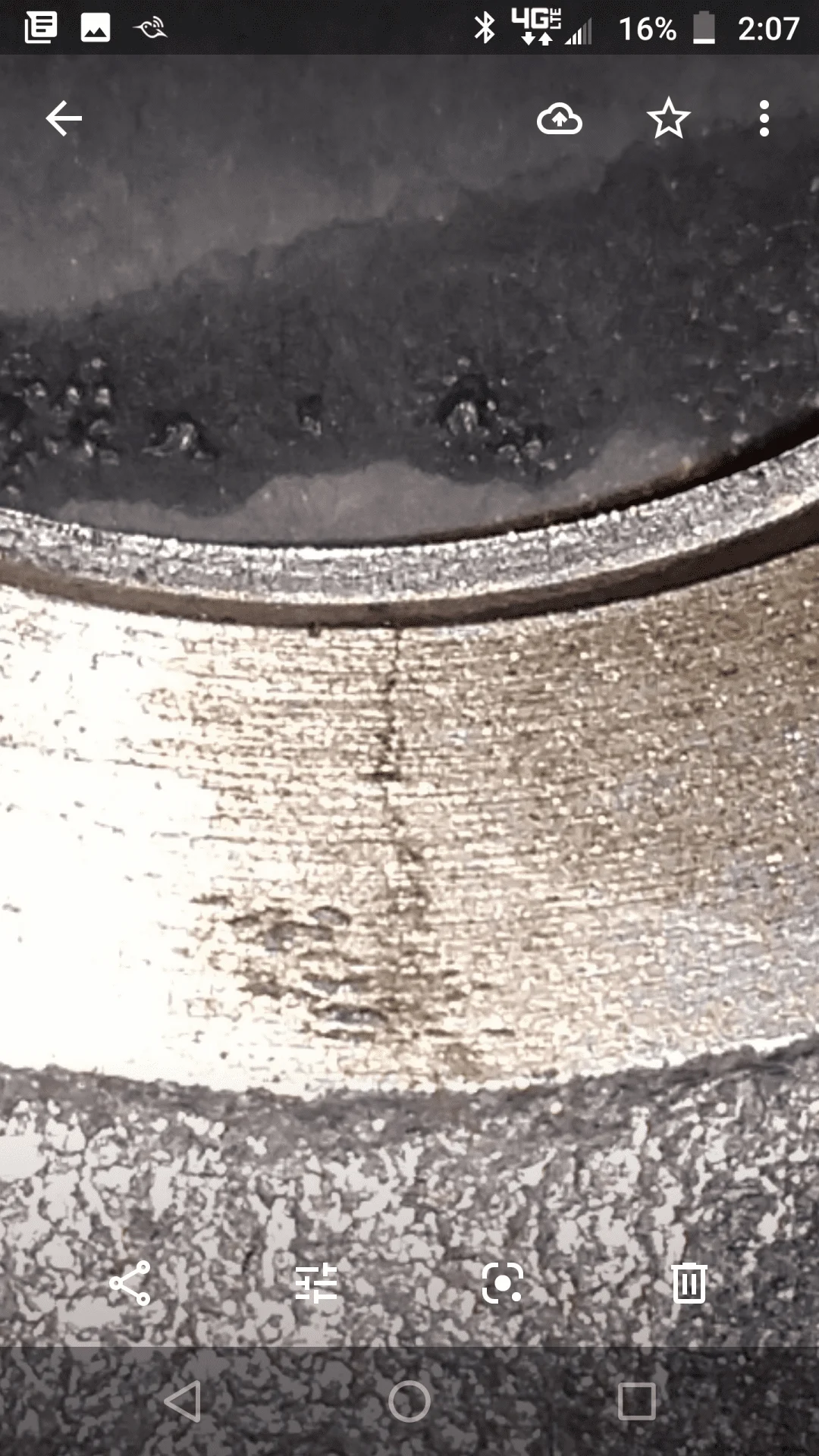

Update
Yes sir, i read through and cleaned her up.
I posted hoping it was only the freeze plug, looks like a hairline crack.
Is it time to pull the engine and get a new short block?
Idk, people take extreme measures for minor issues all the time. I would probably just keep a gallon in the truck and top off as needed unless the leak was to the point that it was too much to practically manage by topping off a bit every tank of gas. How much coolant are you losing and how often?

I ended up draining coolant, pulling the freeze plug, grinding a V-notch along the crack (and tried stop-drilling the crack but who knows if I actually hit the end), then filling the notch with JB weld.
That said, my "fix" only lasted a year or so and I'm planning to try again. The leak is so slow that I just keep a bottle of coolant with me and top off as needed, like @Funner said.
There are more invasive means of addressing cracks like "metal stitching" but most would require pulling the motor anyway.. if you do that, might as well drop in a replacement.

I've never heard anything about catastrophic failure unless you were to lose the freeze plug altogether but I don't see any way the crack would cause that.
I've been driving mine like this for 3 years and I'm sure the crack started long before then - there was evidence of a previous repair attempt when I found the leak. Just monitor the coolant level and you should be fine.

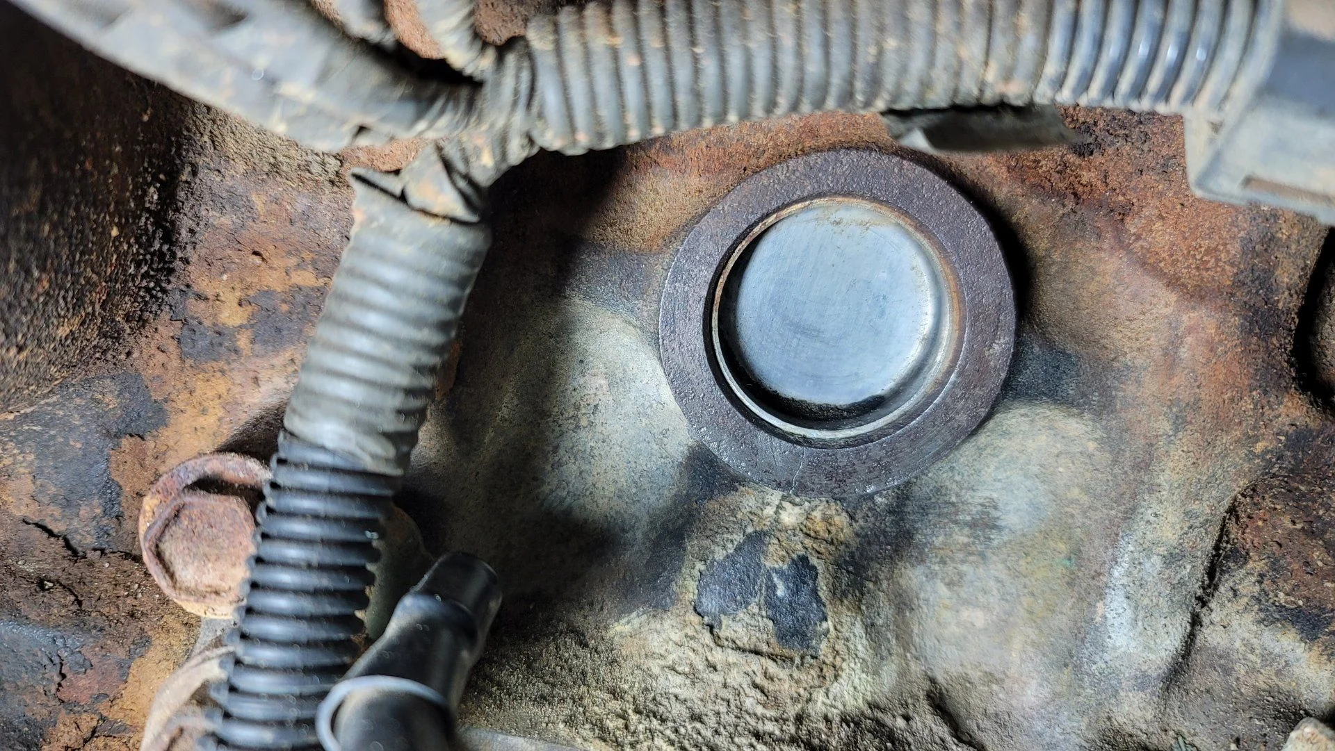

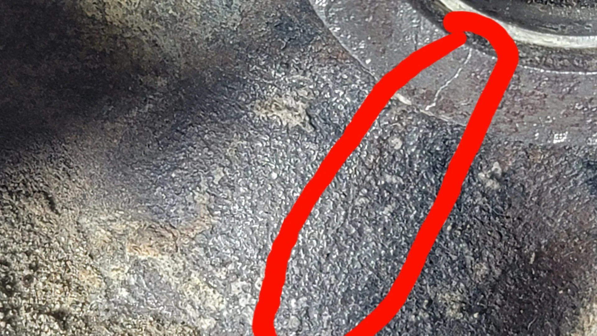

I've neglected the issue until now, and am starting to look into it again. I had a rear heater line rust out and leak coolant all over the garage, so I finally decided to take the time and address all the issues I can do myself at home. Looks like my neglect made the situation worse. Found the freeze plug area that's been seeping for the past 3 yrs with a thick layer of what looks like a calcium buildup. And as I scraped away at it, it definitely revealed the crack and looks like crack has made it further down the block
My hairline crack is of course still there and still weeping a tiny bit of coolant. It's just a sheen of pink on the block.

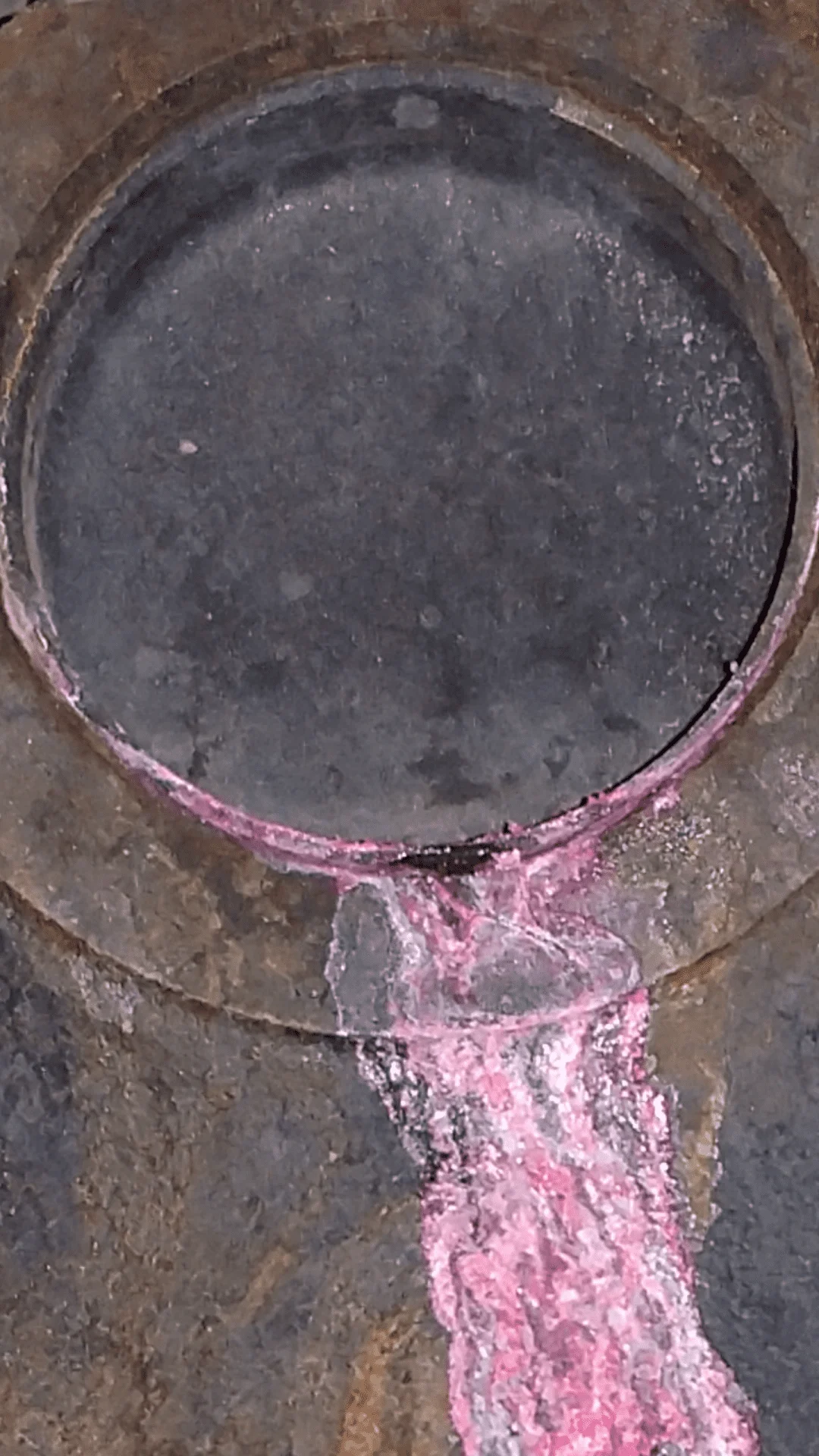

I've been thinking about replacing the freeze plug, but based on my reading, the leak does not go away. Has anyone had any success long-term?
Nope. I replaced the plug and it's now leaking more. I added bars stop leak and that helped significantly
Hey I wondered how you were doing with this. Glad I checked back. Thanks for sharing. Sounds like I should just leave it alone.......
Or add bars stop leak.......
