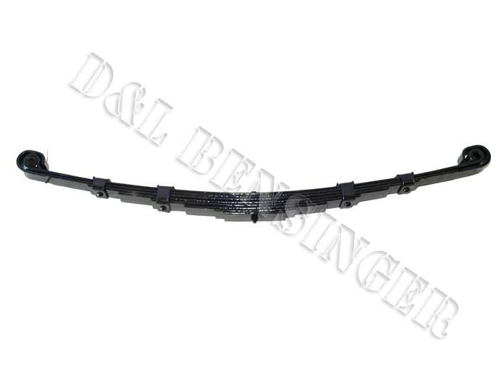

Not totally sure these work on an M101 but for these little trailer (like M100 or Bantam trailers) you can use the front leaves on a Willys MB Jeep as replacements. Seen here:
or here:
Again I know these work for my Bantam T3-C trailer but the M101s might be slightly different in some way I am unaware of. The springs above or not cheap but many places sell the MB parts so you may be able to find better pricing somewhere else. Apologies in advance if you have looked at this before and know they don't work. GL and HTH.
m101CDN2 springs are 36"x2" and the one I saw on quadratec is 35" x 1.75
