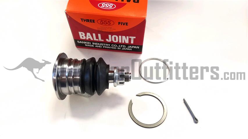

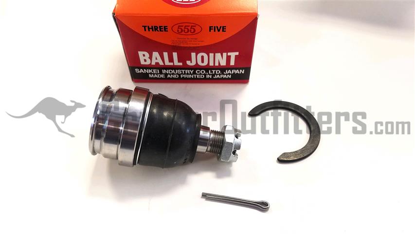

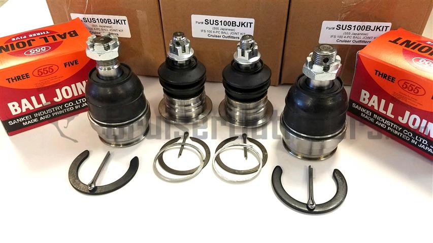

We stock the 555 lowers, same brand we've been selling for 25 years now, fantastic results. We offer them individually or with uppers:
200/570 Series UPPER Ball Joint
Part# SUS43310 - $27.50/each
(Fits 2008-2017 IFS model 200 Series Land Cruisers & Lexus LX570 - Includes one upper ball joint and associated hardware)
200/570 Series LOWER Ball Joint
Part# SUS43350 - $45.50/each
(Fits 2008-2017 IFS model 200 Series Land Cruisers & Lexus LX570 - Includes one lower ball joint and associated hardware)
200/570 Series 4-Piece Ball Joint Kit
Part# SUS200BJKIT- $135.00/kit
(Fits 2008-2017 IFS model 200 Series Land Cruisers & Lexus LX570 - Includes (2) upper ball joints (SUS43310) and (2) lower ball joints (SUS43350) and all associated hardware)
Let us know, we would love to help you out!
