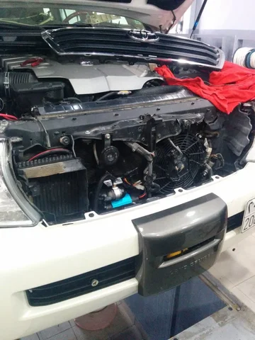

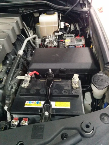

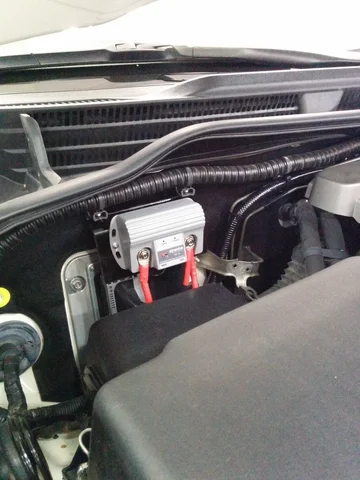

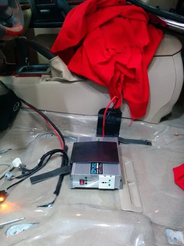

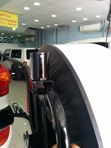

I really curse these huge storage smart phones - you end up taking pictures and never get around to sort them...arrghh... So my smartphone decided to go cranky and I had to back it up - voila - pics from Jan 2014, when I got all the electric-mods done
... pics are self explanatory... enjoy..

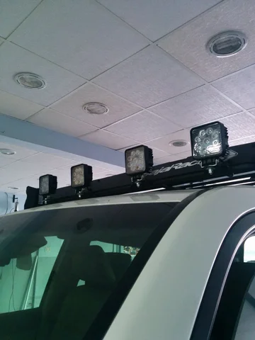

Work carried out:

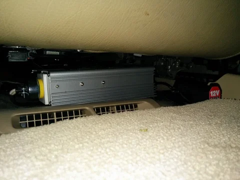

- 600W Onboard Inverter with 2 outlets (F/R)

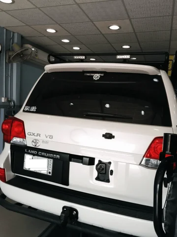

- Roof rack LEDS - Front - 4'' Floods - 27W - 1550Lumens
- Roof rack LEDS - Rear - 15W Spots - 1200 Lumens - bar shape
- Roof rack VHF Radio Mount
- Dash VHF Power/Antenna inlets

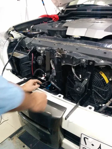

- Front Grill LED - 120W - Southeast Overland
- ARB onboard compressor
- Dual battery Piranha systems
- Bluesea systems fusebox
- Three extra Toyota stock aux power outlets
- Two 12V outlets for 2nd row - Kids DVDs etx
- Two 12V outlets in Trunk area - camping / fridge needs

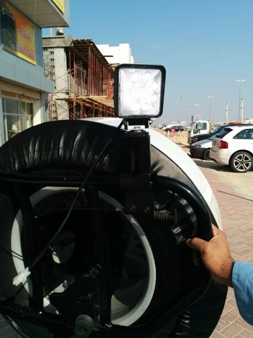

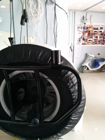

- Aux camping LED mount attached to spare wheel

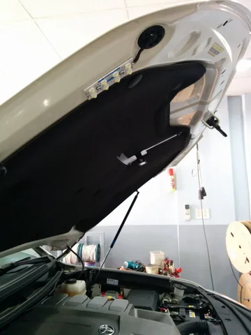

- Hood Working LEDs
- Trunk Working LED
Pictures in no particular order.......
IMG_20140102_161419.webp IMG_20140102_161434.webp IMG_20140102_161452.webp IMG_20140102_163518.webp IMG_20140102_163656.webp
IMG_20140104_125752.webp IMG_20140104_125907.webp IMG_20140104_125923.webp IMG_20140104_125935.webp IMG_20140104_125956.webp
IMG_20140104_130056.webp IMG_20140104_130109.webp IMG_20140104_131409.webp IMG_20140104_192110.webp

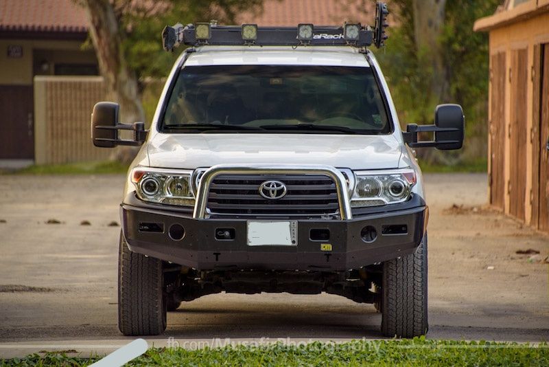

Preparing for the expeditions 2015-2016 season. Finally got the TJM T3, heavy fabrication was needed to get it fixed with the stock winch. And the famous clear view trailer side view mirrors.. .. Mater look ;-)

You mention a stock winch...
Is that it on the side of the license plate?? That would seem an odd winch location if not centered.
What am I missing?
Bumper looks great, by the way.
What am I missing?
It's right under the number plate, hidden by a black plate. I'll post all pics, later of fabrication etx. The plate can be taken off in a minute ..two small nuts..
