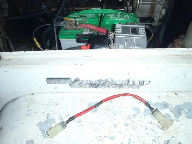

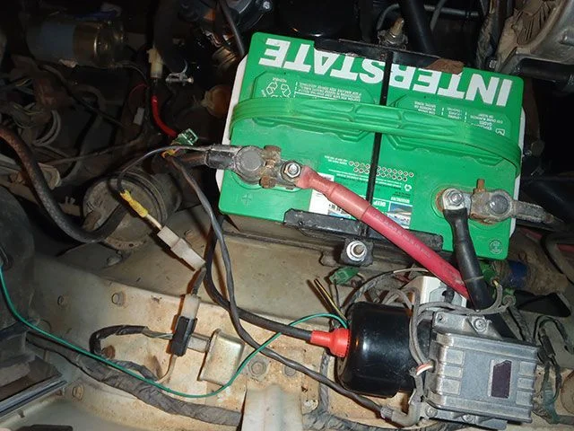

Quick question on my ignition upgrade - I installed the FJ60 coil and igniter in the same location as the FJ40 hardware and figured out and reconnected all of the wiring except for the two wires to the distributor. The wires are about 6 inches too short. Is there anything special about these wires, or can I simply splice in more wire of the same gauge using crimped connections covered with heat shrink tubing?

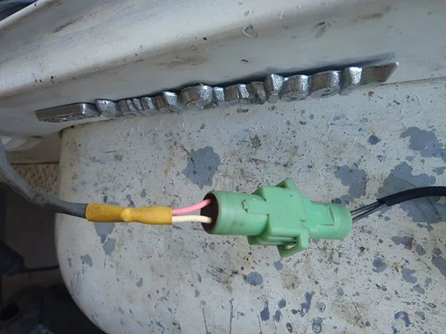

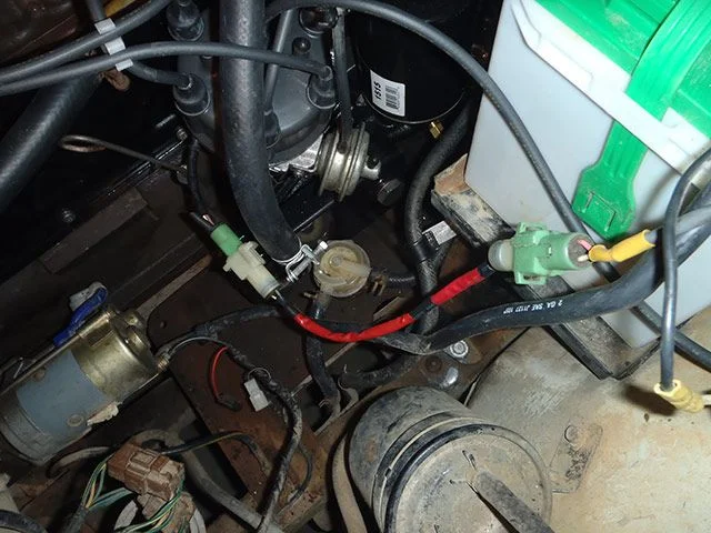

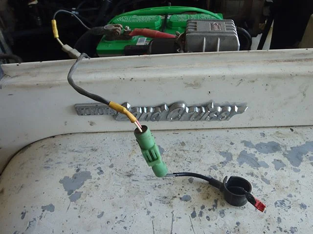

While waiting for the refurbished radiator to dry I got back to the distributor wiring. I went down to my basement to do some connector harvesting and hit pay dirt right away. Down on the bottom shelf of one of my benches was the charcoal canister from my '86 FJ60, which is getting the canister from my '89 FJ62 donor vehicle along with the 3FE. The wiring connector (for the vacuum valve?) is the same as on the FJ60 distributor, and I have at least two complete FJ60 wire harnesses down in the basement. The two wires were not connected to the valve under the boot, and the ends were taped up, I guess it was part of a desmog by the PO. I'll go harvest one of the corresponding connectors and fabricate a short jumper to connect the coil/igniter to the distributor. The wires look like normal wires, so I believe it will work.
I've always been kinda a hack when doing wiring,but after spending time on this forum I now try to take the time to solder all my connections with heat shrink protection.Just my 2 cents.
Well, it turns out I have three complete FJ60 main wiring harnesses, from an '83, an '84, and an '86. The '83 has at least ten of the connectors, six just from the front lighting wiring. Here's the jumper I fabricated:
