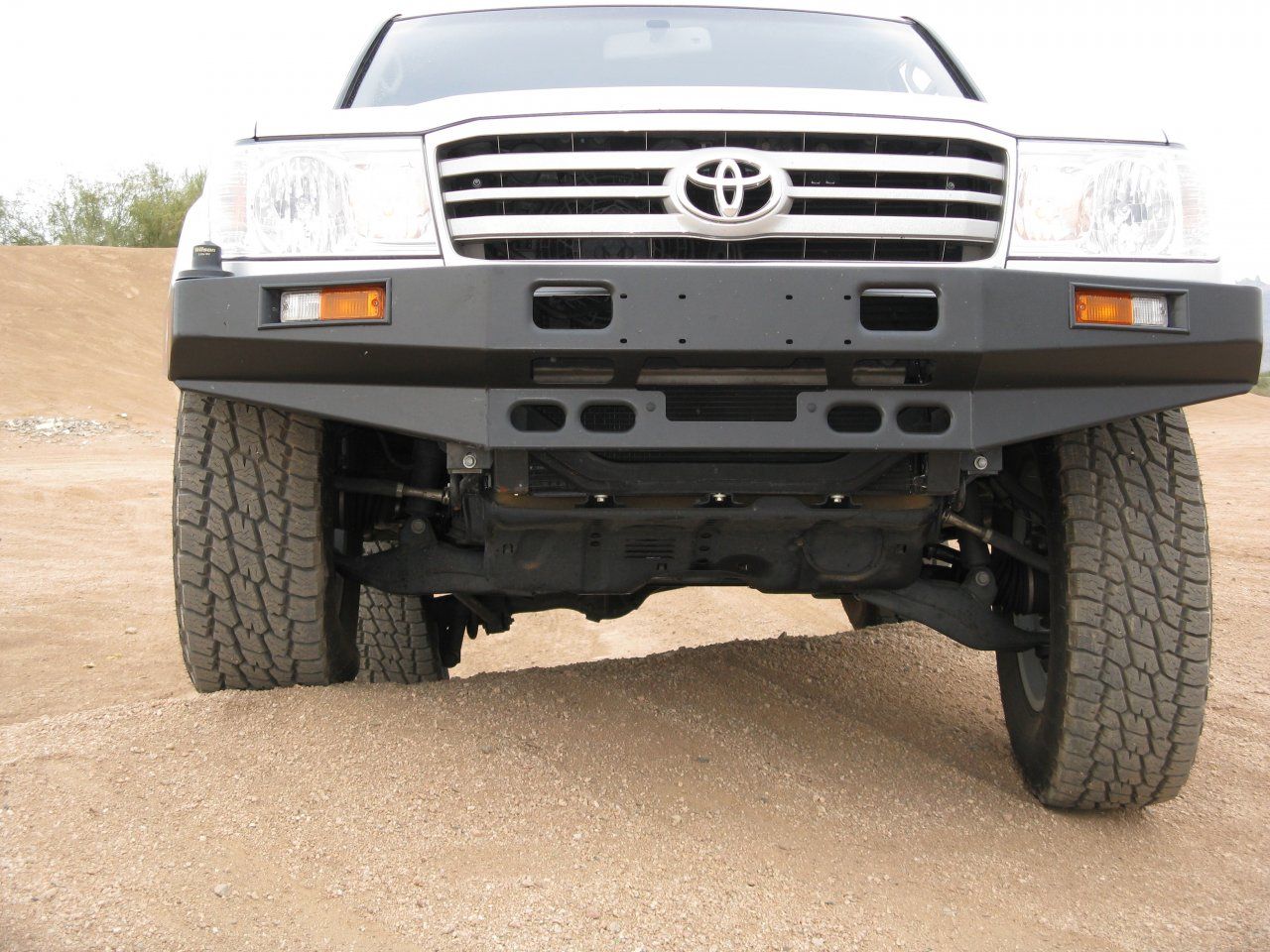

TJM bumper.

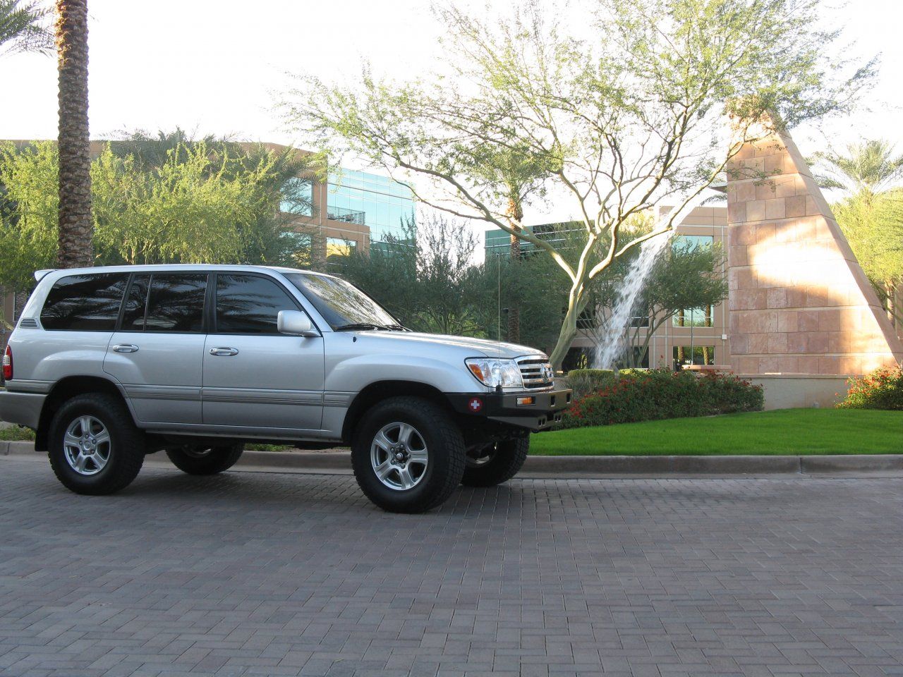

Man that's a good looking 100
Wow, that's nice. I know that's AHC, but how much lift do you estimate that is? And what kind of bumper is that?
TJM bumper as noted above

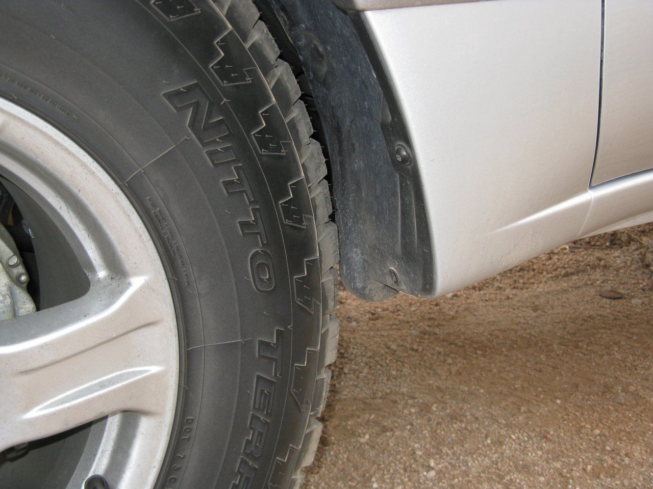

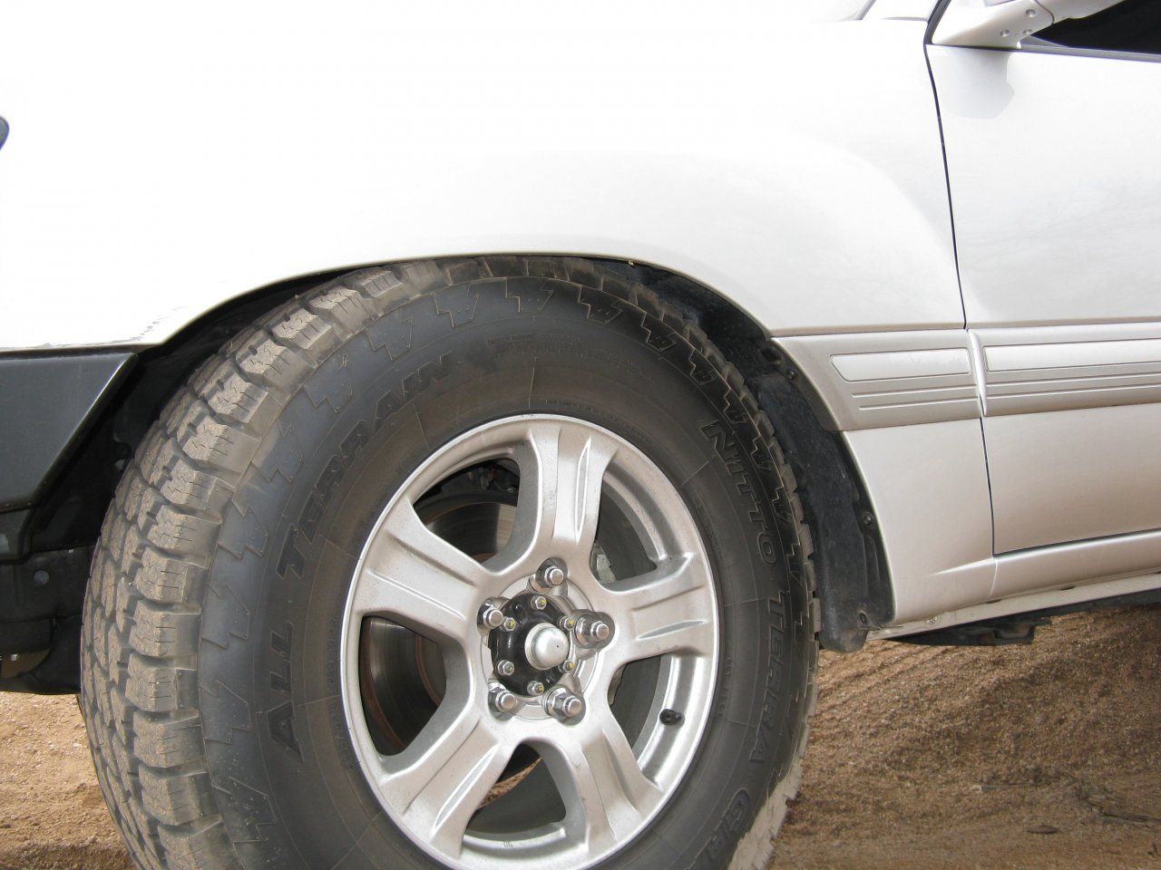

Amount of lift - center of hub to bottom of fender 20.5" Also noted on my AHC I picked up .5" more of down travel over my older non-AHC 100:moon::meh:
In pic 2? I would have figured more. I measured my stock truck at 19.25 front and 20.25 rear.

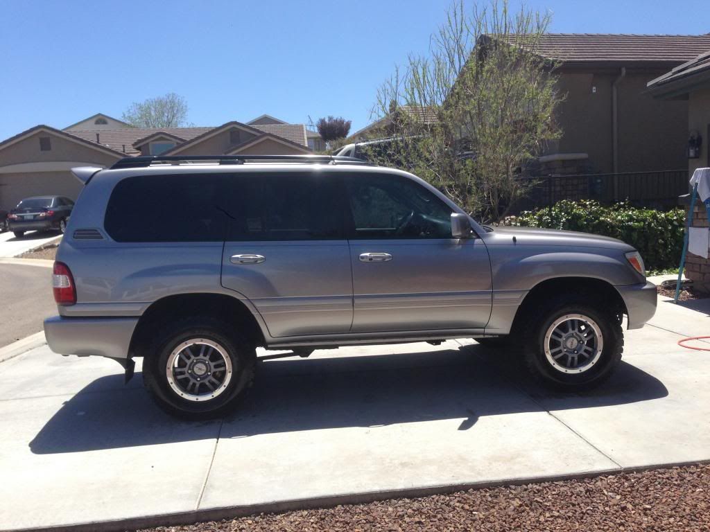

295/70-18 with AHC no other mods other then front bump stops to keep the tires off the fenders when turned View attachment 901573 View attachment 901575 View attachment 901576 View attachment 901577 View attachment 901578
