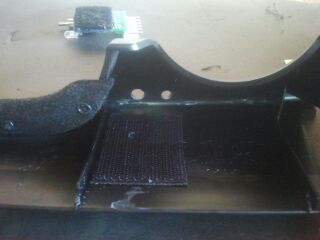

So i ordered the tires and completed the install of the diff drop, over ride and tires. Tires look great!!! I love the skinny look. As for the placement of the over ride switch- The 100s don't have a lot of blank areas like the 80... That was really annoying but forced me to figure out something even cleaner. I decided to use the bezel above the steering wheel and placed the switch just to the left of the key. I figured it wouldn't get bumped accidentally and its easy to locate. The over ride switch doesn't have any mounting brackets so I siliconed some velcro to the bottom side of the switch and top of the bezel.
Next i drilled holes to accomodate the light and switch. The rest of the install went smoothly except for me making a lazy step and not checking the polarity of the 12V+ ignition power... :doh:
