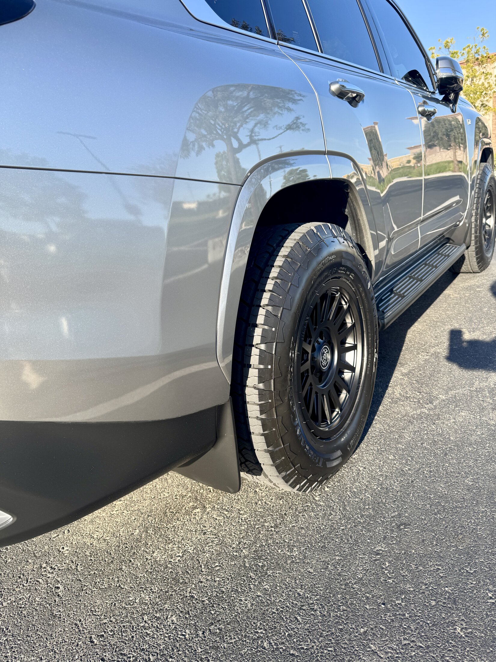

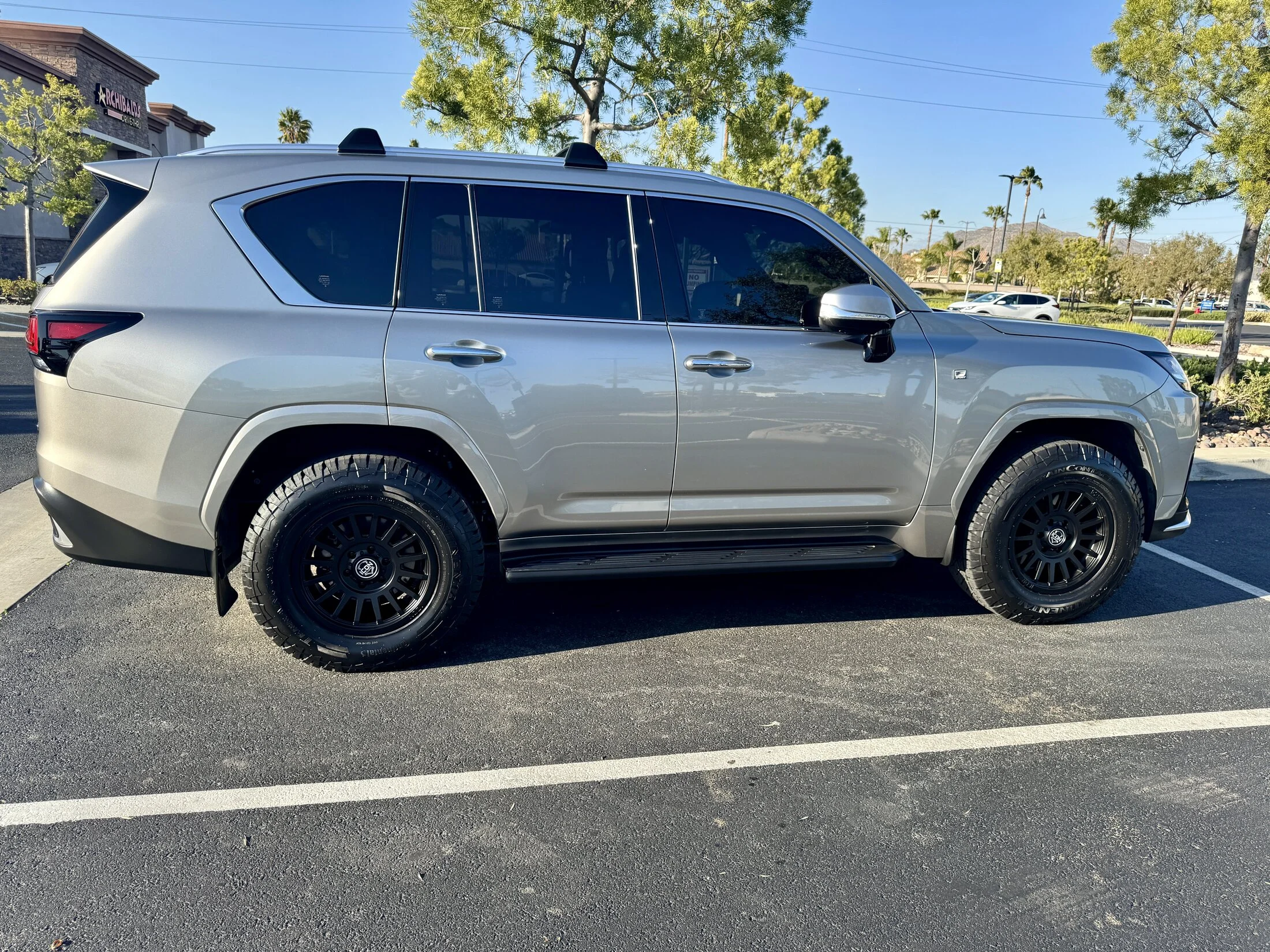

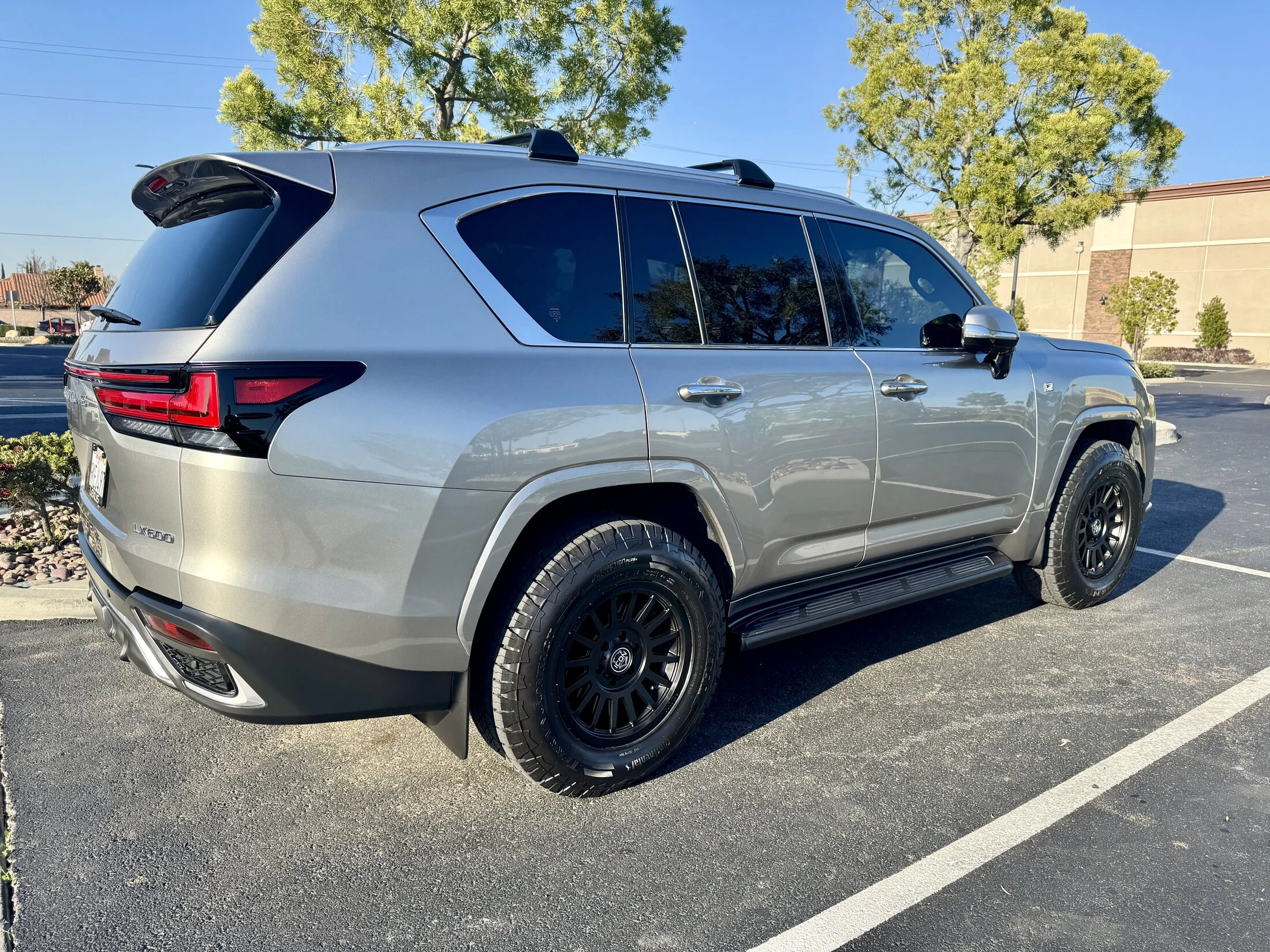

Has anyone ran the 275/70/18 size? 33.3” tall.
I have about 5K miles on my Continentals, 275/70/18. No rub at all. I absolutely love them.
