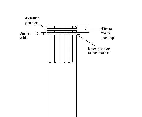

Using Beno's measurements from his part-time thread, I whipped up a quick Paint sketch of where the new groove needs to be on the longer birfs. I'm a visual learner, so I needed to draw it out to see WTF he was talking about :lol:
It's not the prettiest, or even to scale, but it gives a visual idea and came in handy for my machinist :D
Hopefully it will come in handy for other 'Mud members as well.

Nice work Lane. I'm fixin' to get a set of aisin's myself, however, I'll probably go ghetto-style and make a groove with a dremel tool or even better, a hack saw:hillbilly: because I don't have the time to take the axle apart and I rebuilt it only 10K miles ago.
I figure a couple of hose clamps would serve as a good template :hillbilly: and as far as I can tell, I should have enough clearance past the studs to cut the groove while the birfs are on the truck.
