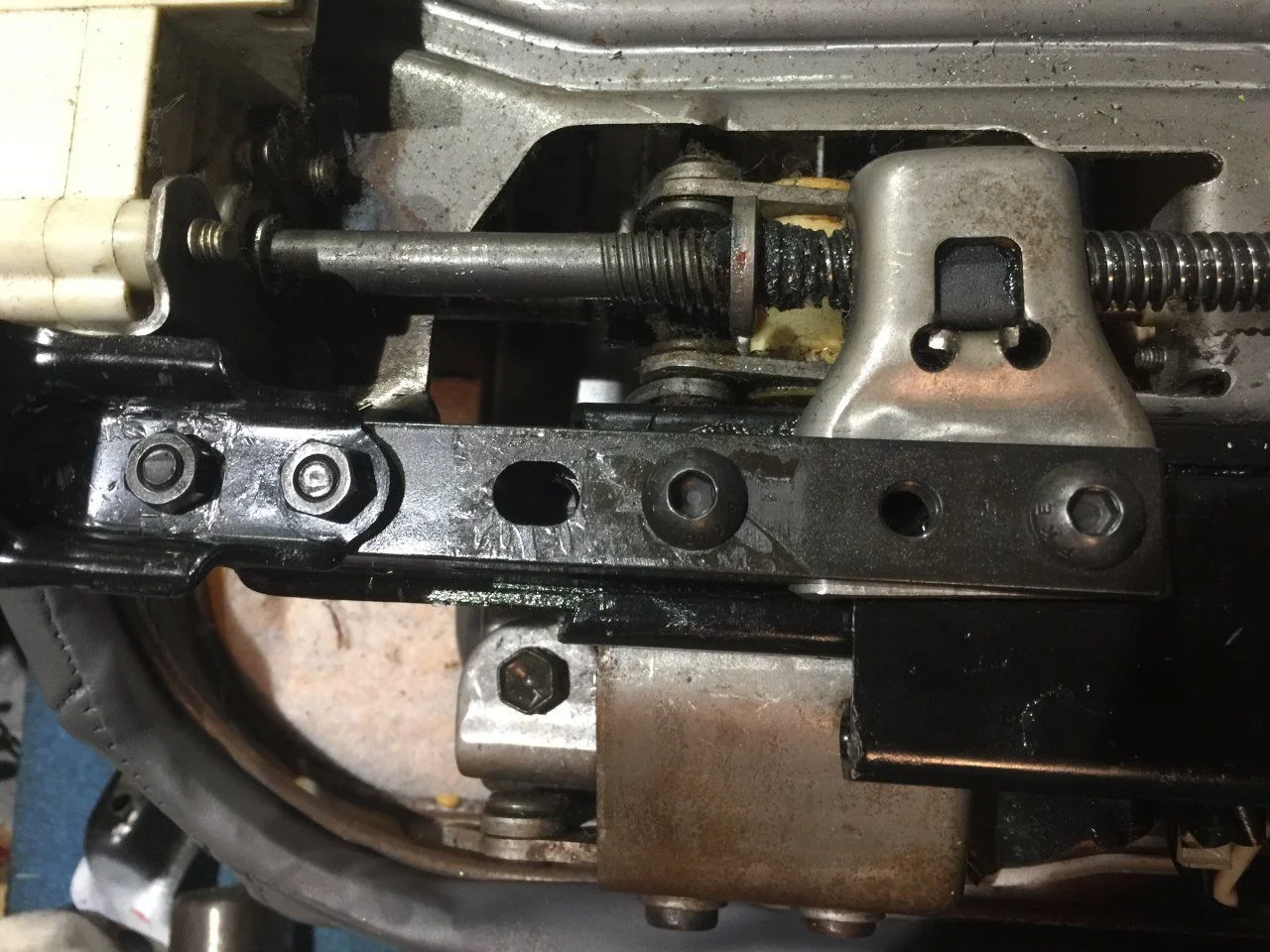

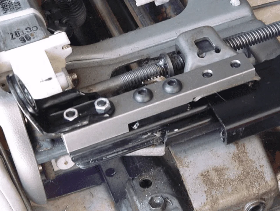

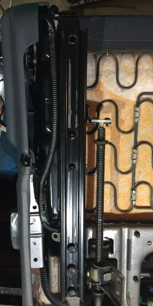

Installing a set of Landtank Seat extensions on my drivers seat. Got the front feet off, no problem. Removed the rails, no problem. Which dimples do I grind off? Which bolt do I replace?
The dimple towards the bolts in front, or the one towards the back?
On the rail, which one?
What size countersink bit did you use?
No matter what I do still have 2 problems.
1. Rail doesn't slide freely on seat. It slides but not easy. Dimples are gone and counter sinks are correct. ???

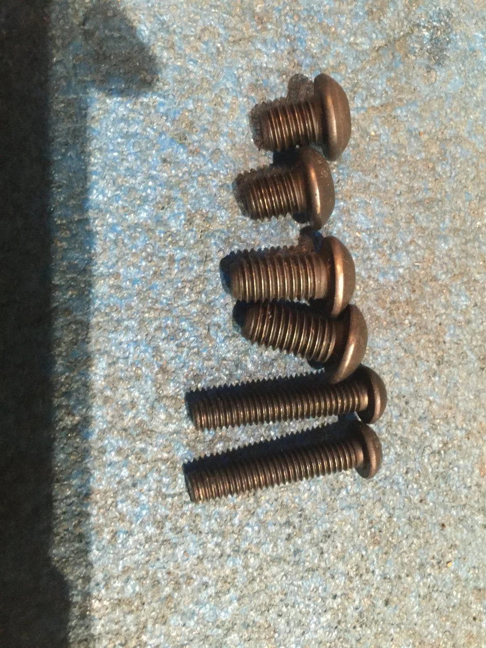

2. The smallest bolts don't fit anywhere that I can tell. You tell me.
Also, didn't see where I would cut a rail for the bracket that fits over. Where do the little bolts go???

The tilt is noticeable, but not awful imo. The biggest thing is make sure the tracks are as smooth as possible and it doesn't bind on reassembly. Take the time to manually run them through the full range of motion a few times before putting it all back together. Make sure it goes all the way to both stops and doesn't hang up anywhere.

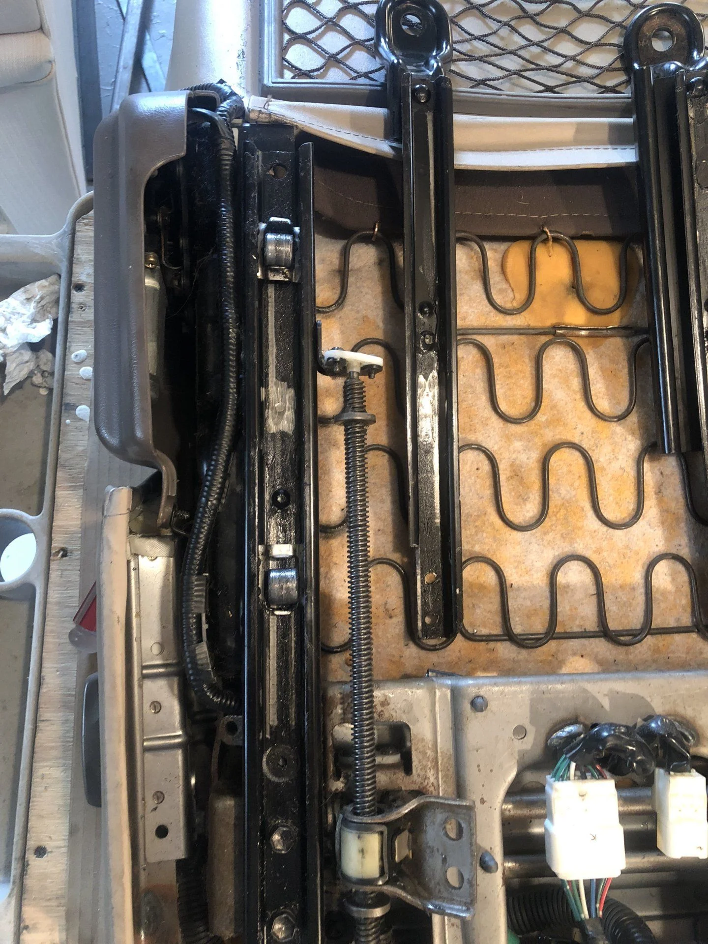

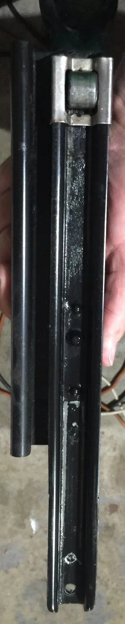

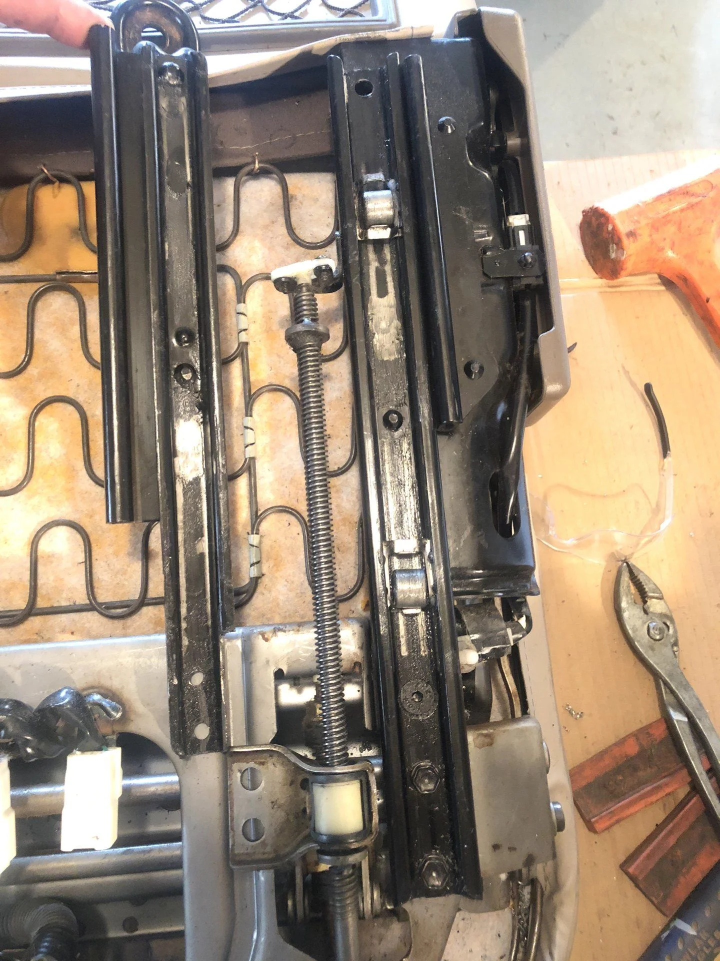

Hey guys, mid-install in the seat extensions and I’ve reached an impass. Can’t get the lower rails to slide back onto the upper rails. I believe I’ve got the correct nubs ground off and both countersunk bolts are flush with the rail. What am I missing...do I have the roller bearings in wrong place?
Just got it, started the tracks with rear bearings out then put them in when lower tracks were almost all the way slid towards front of seat
