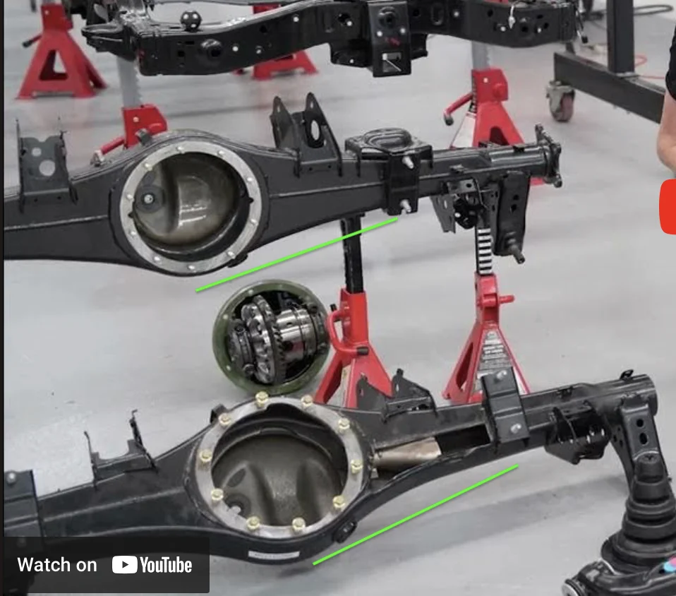

What I noticed about the LC250 rear axle is the trussing underneath the axle is almost a straight line from the diff to the coil spring. A bit of loss of clearance in those areas. The 300 is more of a hyperbolic curve.
And then compare that to a GX460.
There's a difference between 8.9" and 9.4" of ground clearance.
It's an interesting observation about the shape of the lower axle housings. The GAWR for the 300 is 1930kg vs 1860kg for the LC250. Both are a decent jump over the 1560kg of the old 8.2. But 70kg (154lbs) is a relatively small difference in weight capacity if it's 25% thinner material. Although I think the axle rating is tire (pressure) limited, so it may not mean anything other than what pressure is recommended. I hope they share more information about the stiffness and failure strength of both axle housings if they do flex them until they bend. According to what I can find from the Aussie GVM upgrade companies - to upgrade GVM past a certain point of around 2,600kg on the rear axle of the 300, they swap the rear axle housing to a stronger one. I'd love to learn how they make that determination and what the rules are in Australia for upgrading GVR.

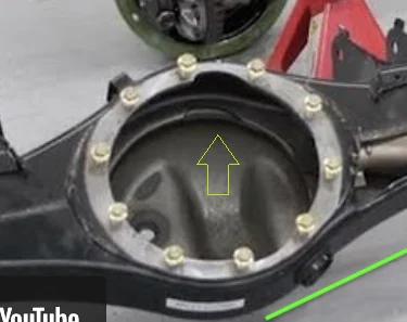

Interesting that there's a ring gear clearance cut out on the backside of the diff housing where it mates to the diff cover. It would have no purpose in that spot - but possibly the blanks used to make the housing are made to be non-direction specific. I think the housing is direction specific or you'd have drain plugs randomly located on left or right hand sides.
Another observation is that the ring gear cut out area is not present on the 8.2" diff. It's at least possible if the clearances are similar between ring gear and axle housing that the 9.5 and 8.2 actually have the same ground clearance because the ring gear on the 9.5 is significantly closer to the axle housing than the 8.2.
The older 8.2 (2010-2024) was a fit similar to the 9.5 in the 300 where the housing and 3rd member carrier are notched for ring gear clearance to have a close fit. The new 8.2 appears entirely non-interchangeable unless possibly the ring and pinion parts may swap.

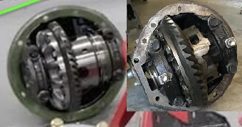

Old 8.2 (non-elocker housing:
New 8.2 Housing:
Old 8.2 vs new 8.2. - I tried to roughly scale the ring gears to match, but it's pretty obvious that the new 8.2 housing is enough larger that the ring gear fits entirely inside the mounting flange diameter where it did not on the old one. It also looks from the image like the carrier assembly (part in the middle of the ring gear) is significantly wider than the old one, the bearing caps look quite a bit further apart, and you can see how the ring gear mounting flange of the carrier has stiffening ribs and is also a lot more robust than the old one. It also is locating the ring gear mounting face quite a bit further inboard. Visually from this image it also appears that the bearing caps are potentially smaller - meaning possibly smaller carrier bearings? The old 8.2 Elocker had significantly larger dia carrier bearings due to the e-locker mechanism, so maybe that's just a result of the change in locking design.
