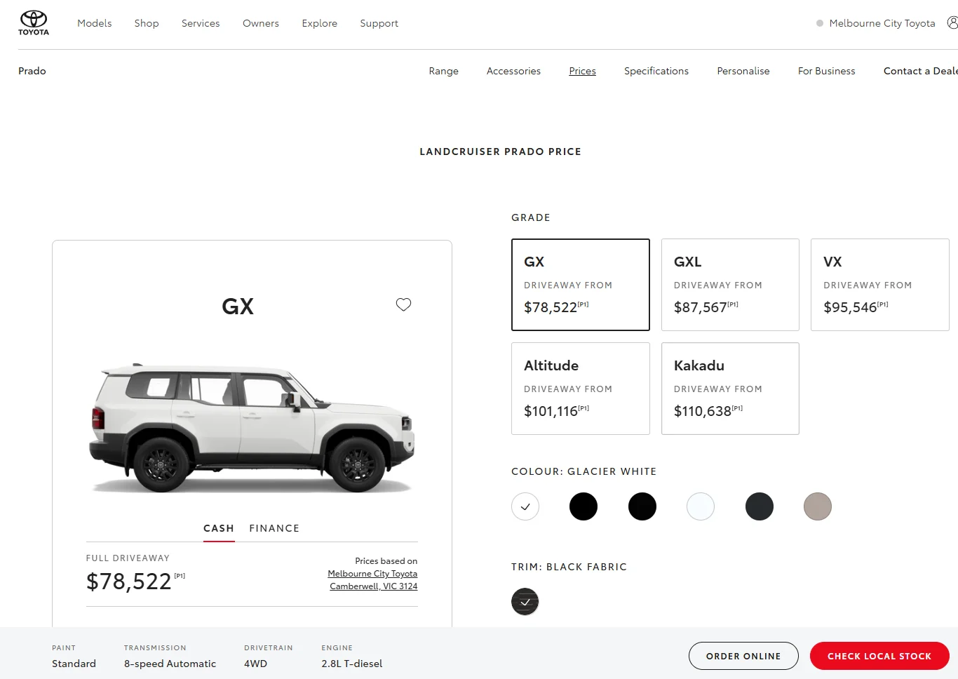

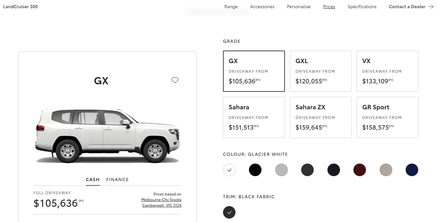

Here is a 250/300 price (Australian) comparison from the same dealership in Melbourne. 34% more for the Land Cruiser 300 versus the Land Cruiser 250/Prado. I'm personally pretty impressed they can build a both as BoF, boxed frame and full-time 4WD and have them in the market with this big of a price difference and even get component specifications close. Toyota has the engineering capacity to choose the differences wisely and the manufacturing skill to source quality parts and bolt them together well.
