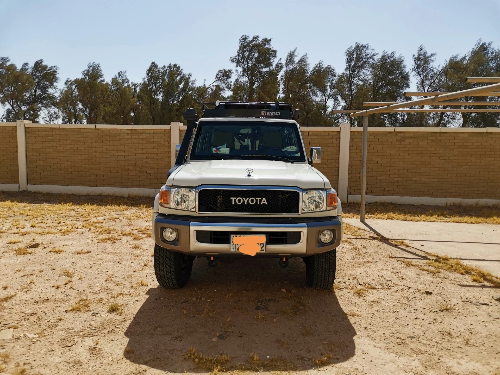

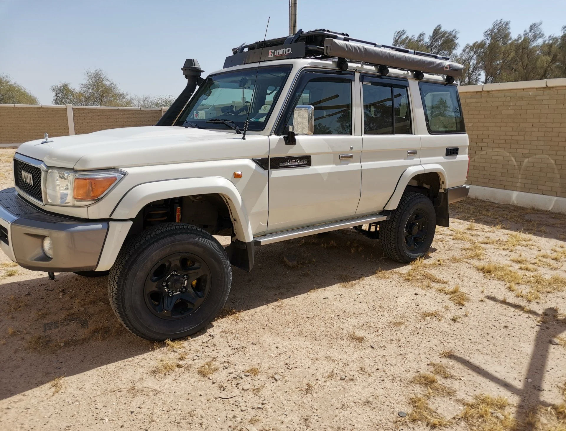

And hear are some pictures 🌹

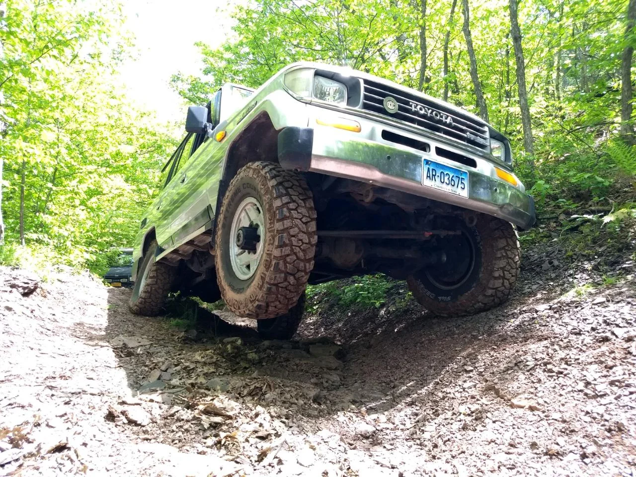

I'm happy with Dobinson 60 mm lift on my LJ77.
I do not have a roof top tent or any weight to make the vehicle top heavy.
I am running 33" tires.

Nice truck u have there
As always the 70 series with wheel lift 😁
To be honest i like the look of the car without roofrack, but i have to use that extra space in the top
So i fitted ironman alloy roofrack, which weight about 25 kg
