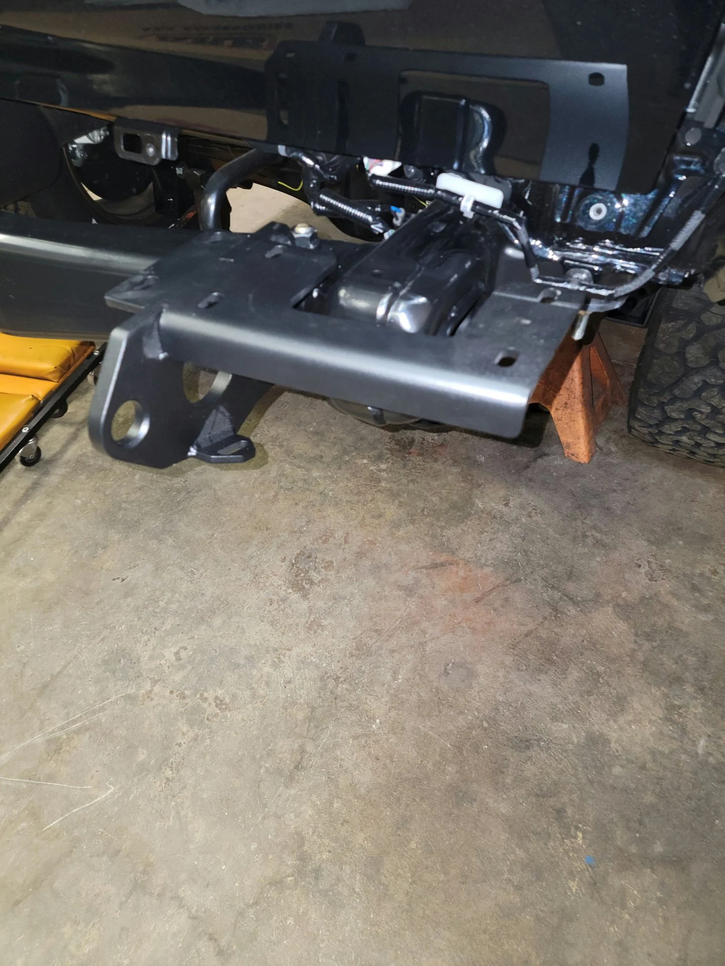

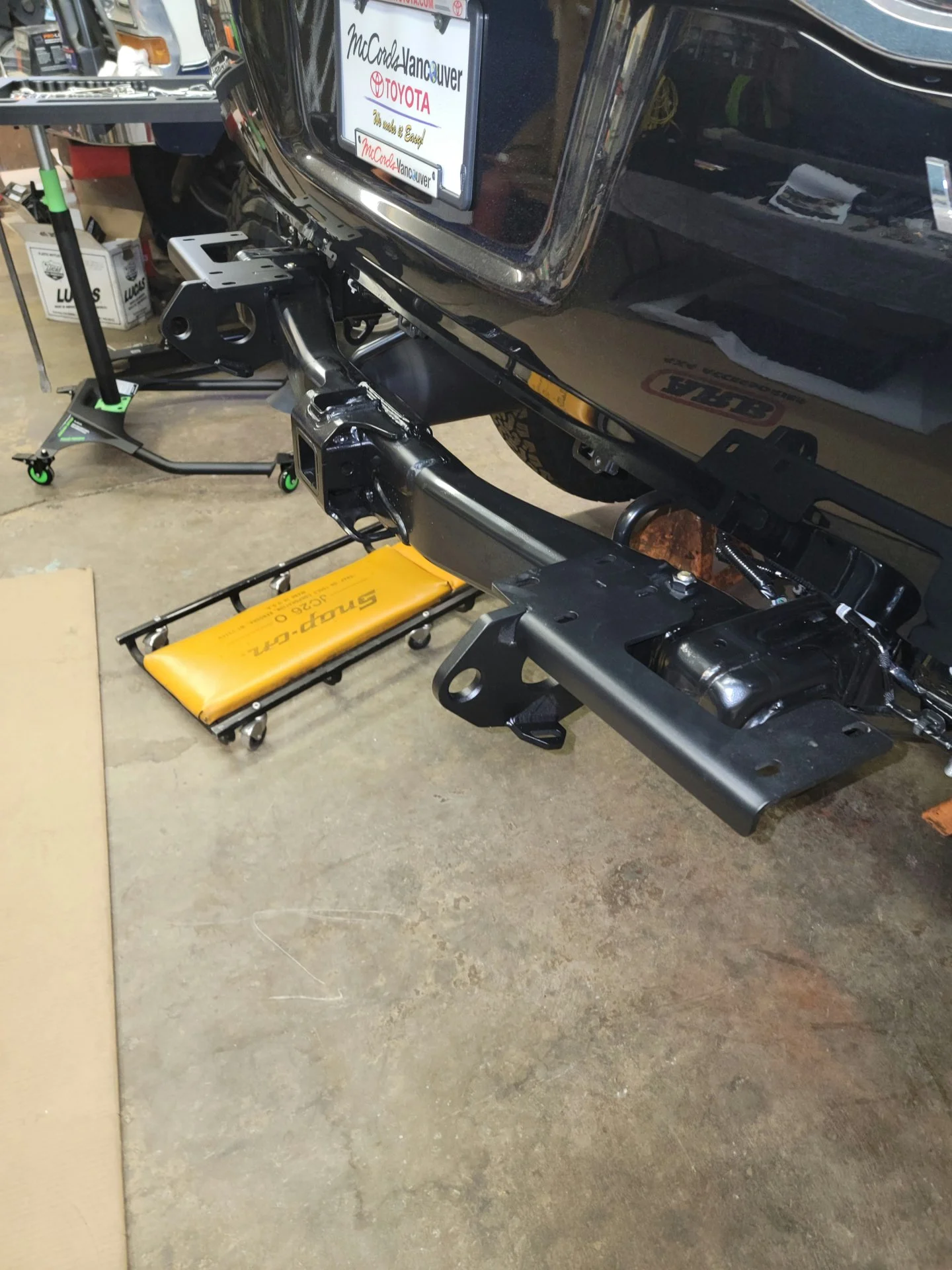

I also have a problem with the clearance issue of the recovery point on the passenger side hitting a welded on bracket on the frame and not allowing me to center the bumper, but maybe everyone else is ok with that. I'm not sure what to do with this problem now because I don't want to cut that bracket off the frame because it may be needed for other items to mount to, I'm just not sure at this point. To clearance the passenger side steel recovery bracket to clear the frame bracket would mean many hours of taking the bumper all back apart to remove the recovery point, grind down the area that is hitting the frame bracket. touch up the paint on the bracket, reinstall and adjust everything again. I could probably cut the bracket on the frame off to clear but its not easy to get to and it would have been much easier to do with the bumper off the vehicle. I'm also not sure if that bracket is needed for other things that I'm planning on installing like a LRA fuel tank and possibly rear BudBuilt skid plate.
Not something we have seen or heard of but would like some more details and photos.
Also if this is a problem on my vehicle its probably a problem on others too. This is something that should be addressed in the directions before the whole bumper is installed. The recovery point bracket probably needs to be changed slightly in their drawings so this doesn't continue to happen. If I was doing another one of these I would know to grind down the recovery point bracket to clear.

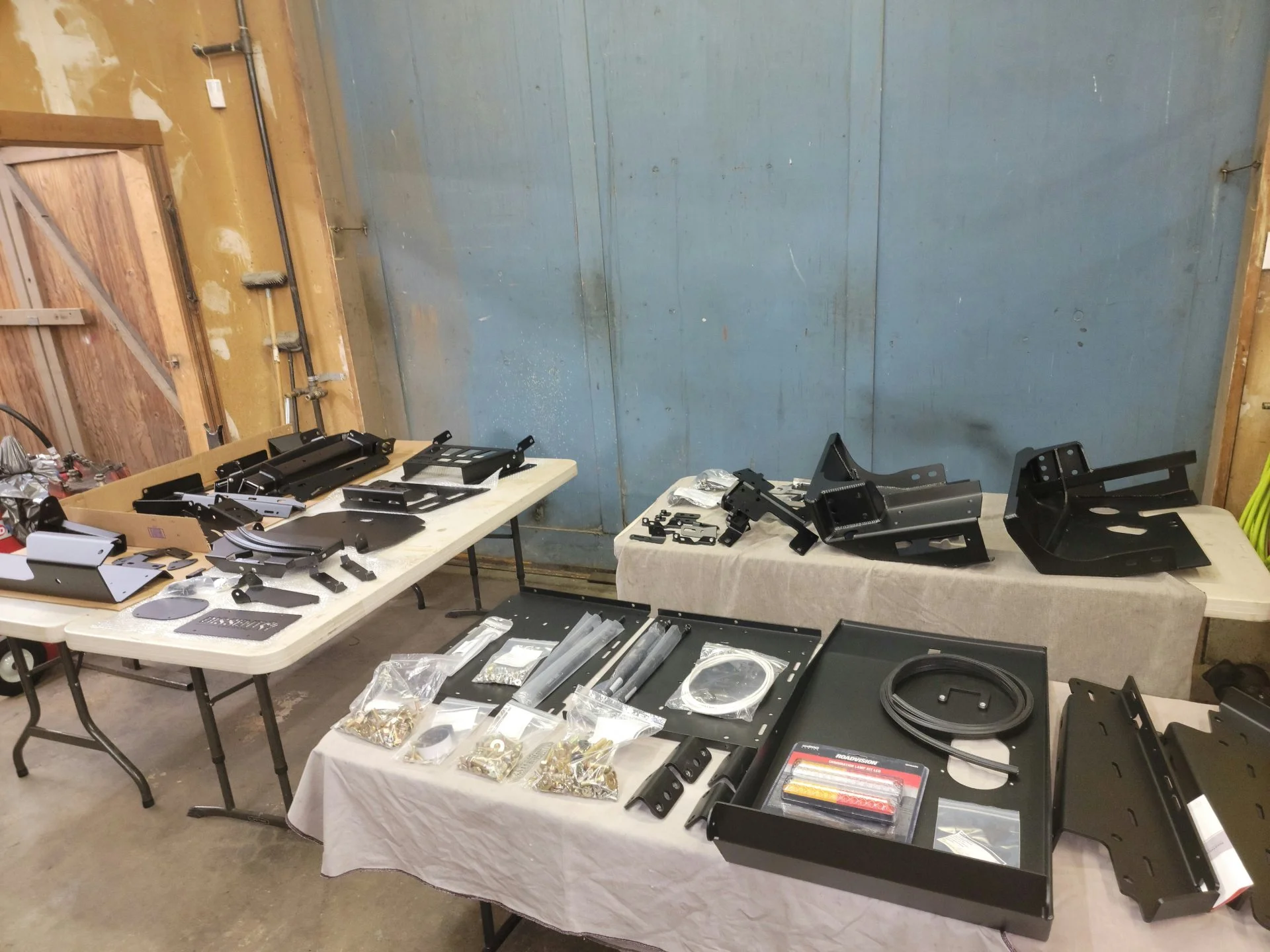

I bought a Dissent Offroad rear bumper with dual swing arms. I'm not very impressed with it. Anyone else have one or tried using the recovery points on the rear bumper? I personally don't think I trust the recovery points for any type of hard pull and will just use the receiver hitch. I'm still in the process of building the bumper because it comes completely unassembled, like an erector set for adults. Its kind of one of those month long project type jobs. I was really wanting to get the Slee Offroad rear bumper but they haven't had any available for over a year so I bought this instead, I'm wishing I had just waited now.
