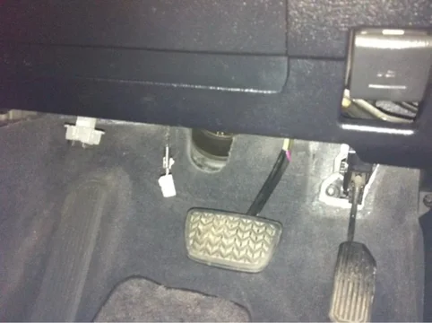

Thank God i found it. Its under the driver dash. Stupid quota i cant post photos. So just look for it near the foot rest pedal. Dig your head in and find a black small box and thats the relay! Thanks all

This is a RHD lc200. To get to the relay, remove the kick panel with 2 phillips screw. Unclip the 4 clips and you're able to see the knee aircond blower. Turn on the flasher and locate the sound of the clicking flasher. You'll see a small black box with 8-pin connector.

Oppss... I forgot to mention that removing the relay isn't an east work. It is locked by a nut which is hardly to be accessed. Probably removing the dashboard? Well it takes me whole day to remove just the 8-pin plug.
