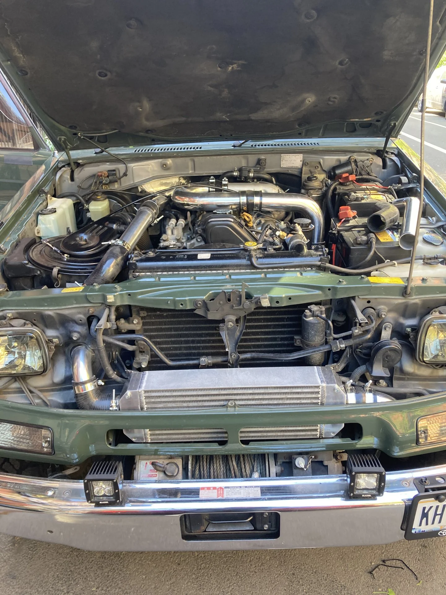

Front mount is definitely more efficient than top mount, and also easier to install I think. Here is mine. Your factory turbo is good up to 18-20 psi so depending on how big of power gains you’re chasing you can still use your factory turbo and increase horsepower quite a bit. Plus I don’t know of any aftermarket turbo that has quite the reliability of the factory one. I’m thinking of grabbing a unichip in the future or posssibly a manual fuel pump conversion. But that will probably wait until I get bored as I’m generally pretty happy with the power I’ve got.

That's really tidy work there. Nice to see it hasn't affected your ability to have a winch, as that's something I'm looking to add in the new year.
Repurposed intercooler from another vehicle, or did you buy something new?

I bought a new Vibrant 12800 intercooler and it fits perfect with some trimming of the grille.
