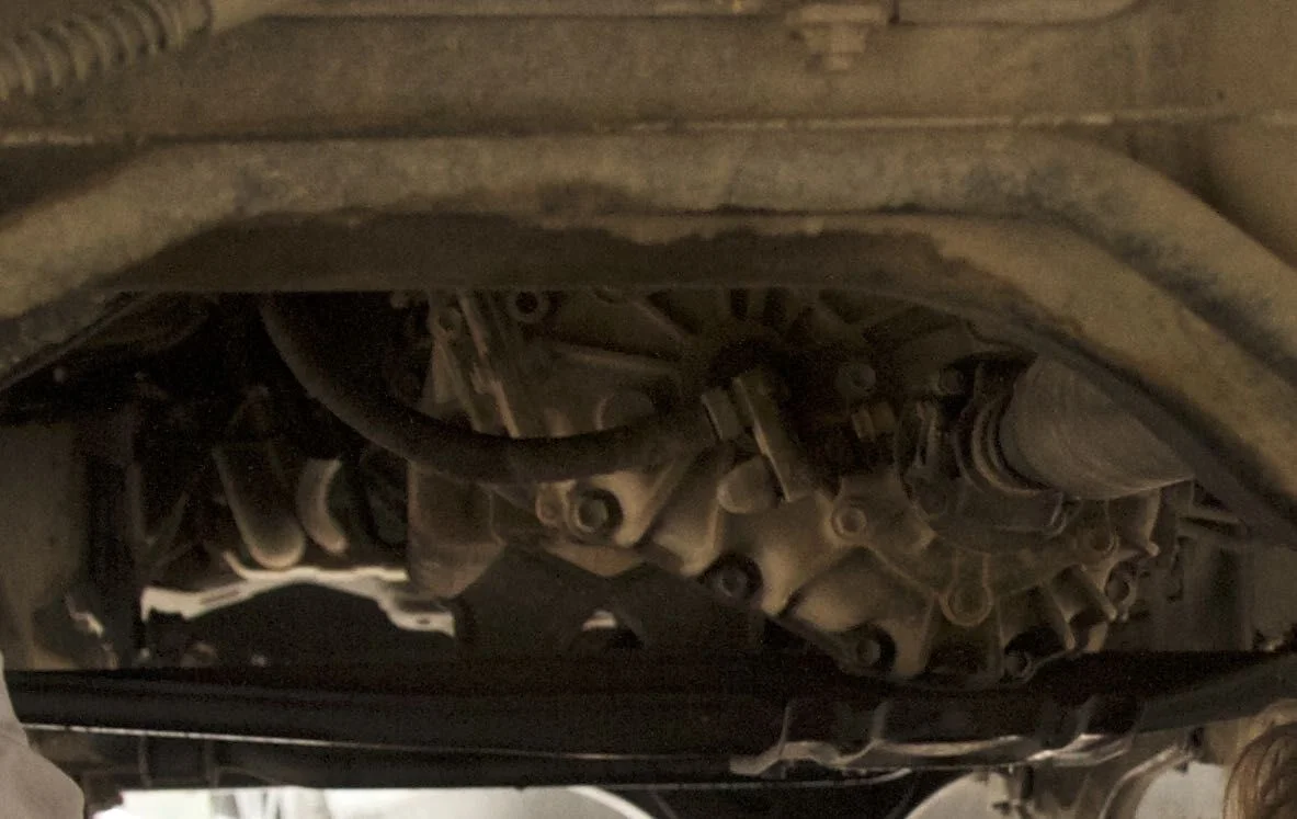

So today I noticed the overdrive off light was flickering, then I saw my speedometer not showing my speed and also not counting miles anymore. saw a forum maybe said speedo cables bad, where exactly is that cable located and how do I tell if that’s the problem?
The speedometer cable runs from the rear output housing on the transfer case up through the firewall and into the back of the gauge cluster. Here is a photo of where it connects to the transfer case on an automatic LJ78:
