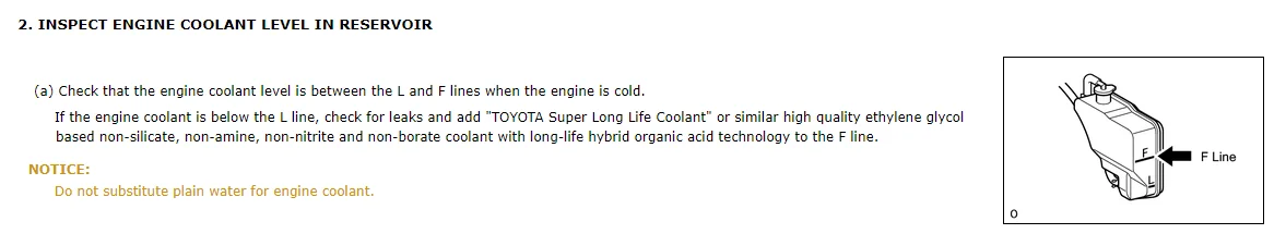

Coolant level can vary a bit in the overflow tank as it expands and contracts with heat/pressure. Between F and L is fine when it's cold.

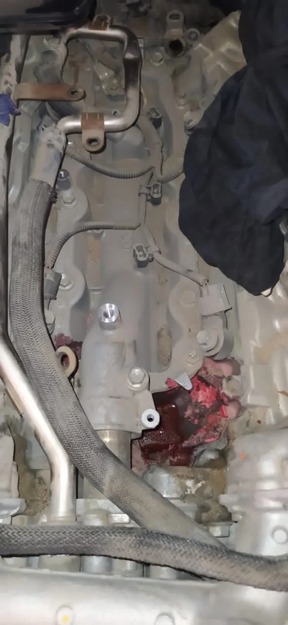

If it drops below L I would lay underneath the front doors and shine a flashlight around the transmission housing. That's how I found my leak.

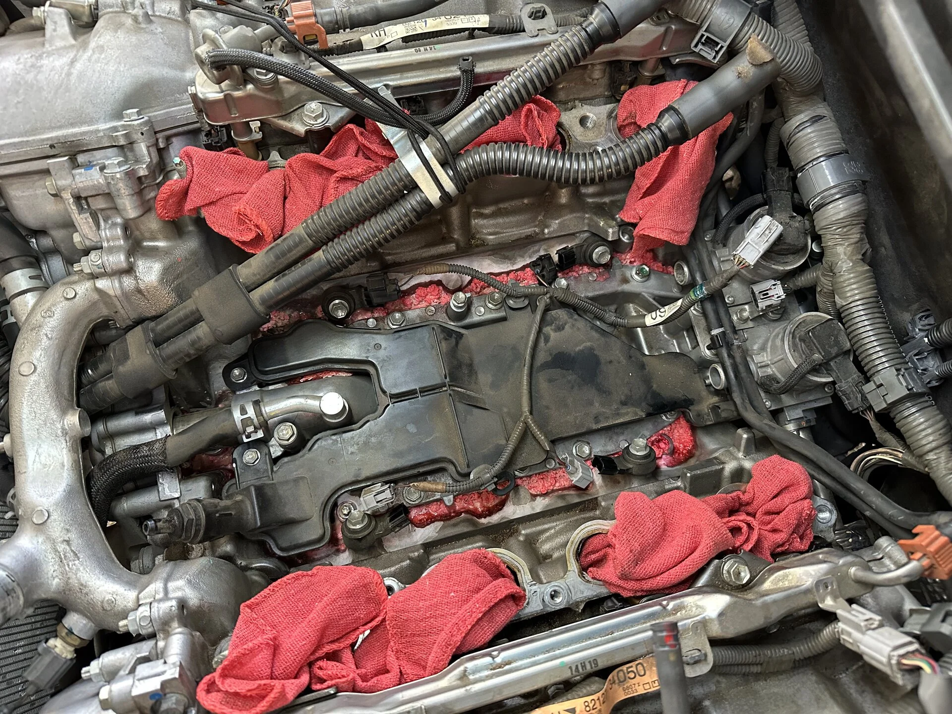

Just did this crap job - id absolutely recommend reinstalling the coolant pipe before reinstalling the plate cover. Generous coolant around the o-rings and it goes in quite nicely.
