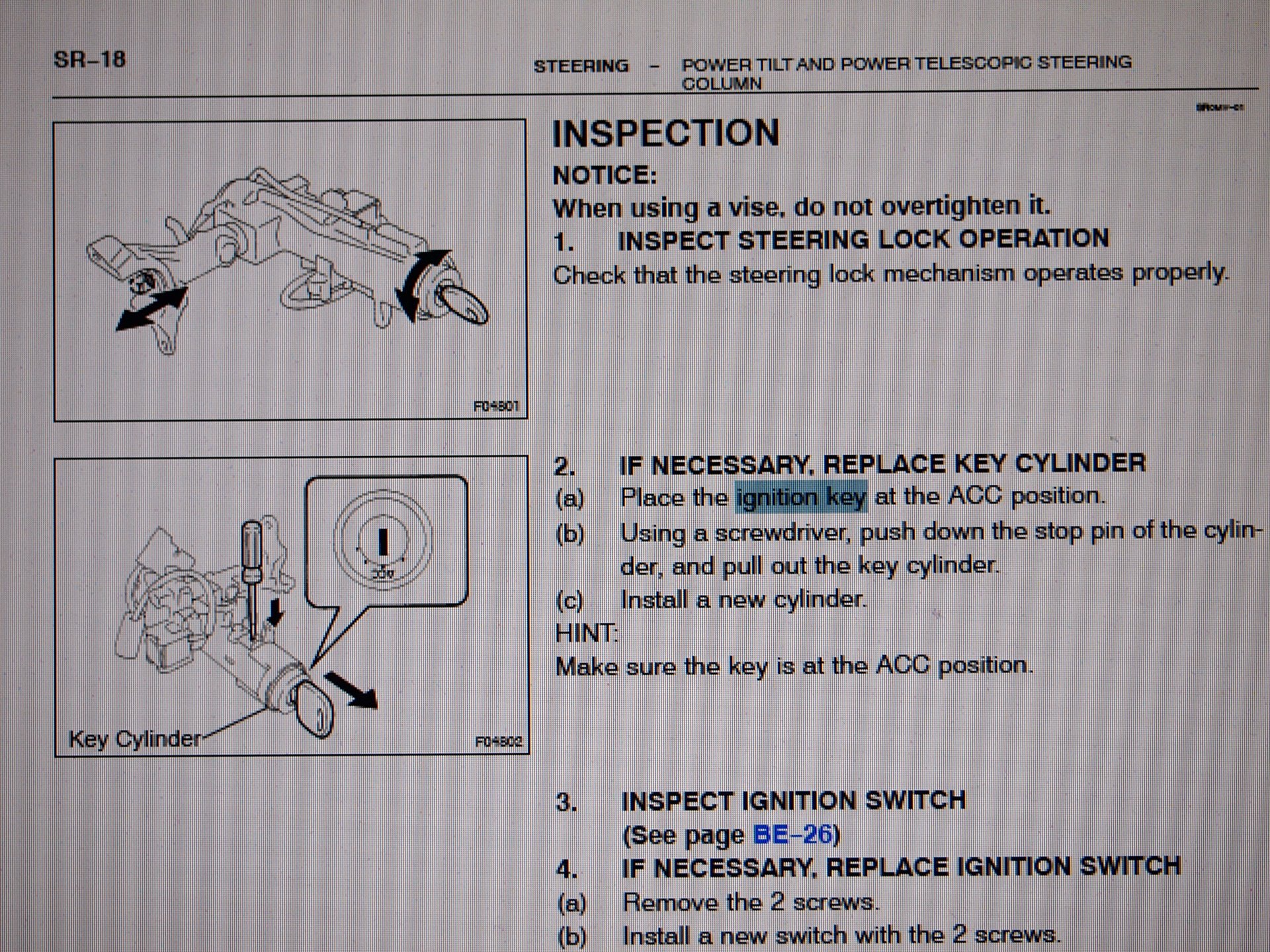

With in ACC, you "may" be able to remove tumbler.
