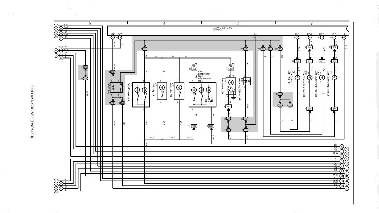

I am doing the mod on the key cylinder light from regular light bulb to led. I accidentally short out the light socket and fried the dome fuse (10amps). Fuse replaced but now the light is not working and the dome light(middle of the truck) works on the ON position but not on DOOR position. Check the key cylinder light and got hot wire instead of one hot and one ground. I know I shorted out something somewhere. Is any one have the wiring diagrams for this circuit? Thanks in advance.
Does not look too good - it seems they are connected to Body ECU ;-(
