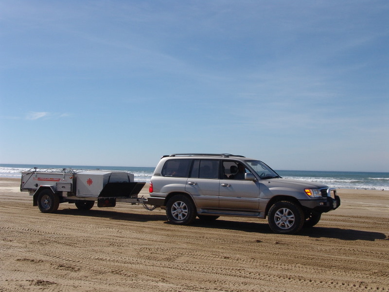

are these bumpers rated for towing? 5000 lbs possibly?
There's length discussion on why they're not officially rated but it boils down to extreme cost. I'll say this on behalf of my slee rear bumper, it's made out of thicker steel and bolted in more locations then my hitch was. It's been tested by mud members to hold up to towing thousands of miles offroad in rugged terrain.
I have to agree, rated or not, these bumpers can tow alot of weight. Spresso is a good example. I just wish Slee would add safety chain hook ups on them.....something that i feel was missing on the first version of the rear bumper.
We don't add safety hooks because that would imply we do rate them for towing. However those are easily added to the inside of the rear crossmember.
I did look into raring the bumper, and even if we did want to spend the money, it is not that easy. There are classifications for receivers that is set by the SAE. One can send the bumper to a lab and they do stress test on the bumper to determine deformation rates and then classify it as a class III IV or V. That is the easy part. However that is still not a rating. In order to RATE it, the manufacturer then has to state that the bumper/receiver can be bolted to the vehicle that is was designed for and GUARANTEE that the vehicle can tow the stated load for the entire duration of the warantee period of the vehicle without incident or problems. That is a pretty big statement for a small company to make.

I think Kaymar and ARB are the only companies that have bumper rated for towing......granted they are much much larger companies
mine has em :flipoff2:
Then again you're the only one that has used my bumper for towing
