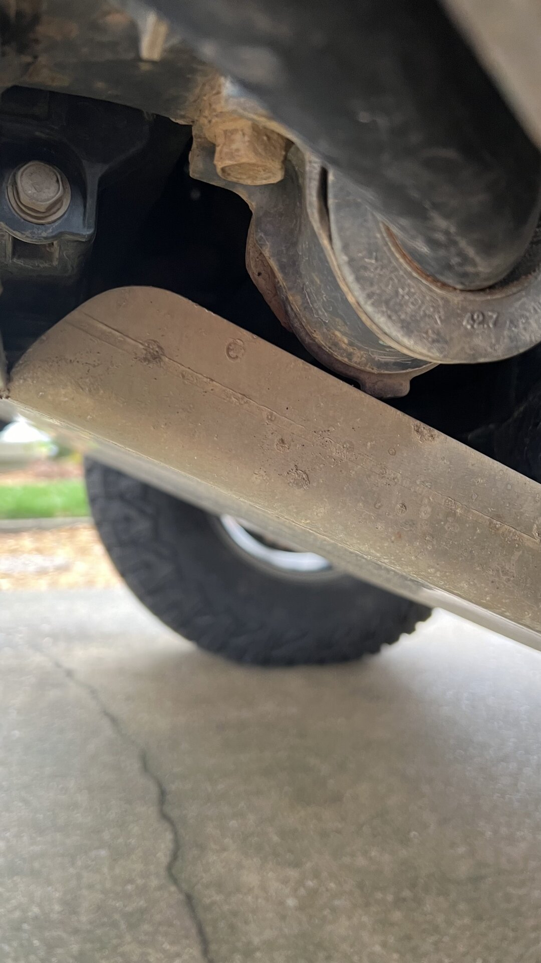

I just went to 34" tires so I have rubbing on the KDSS arm. I need to do the KDSS relocation, so is the sway bar lowered and moved forward a little bit with the relocation kit? The am asking because I am wondering if I will need to make some modifications to my budbuilt front skid? Also does the KDSS arm move some. I am wanting to figure out what I might need to cut before I do it. I have attached pictures of the two spots I have questions about.
Yes it pulls the kdss arm about an inch forward so make sure you have clearance to your bullbar. It’ll pull those swaybar mounts forward too and might require grinding the skid plate. I don’t have budbuilt so I can’t confirm tho.

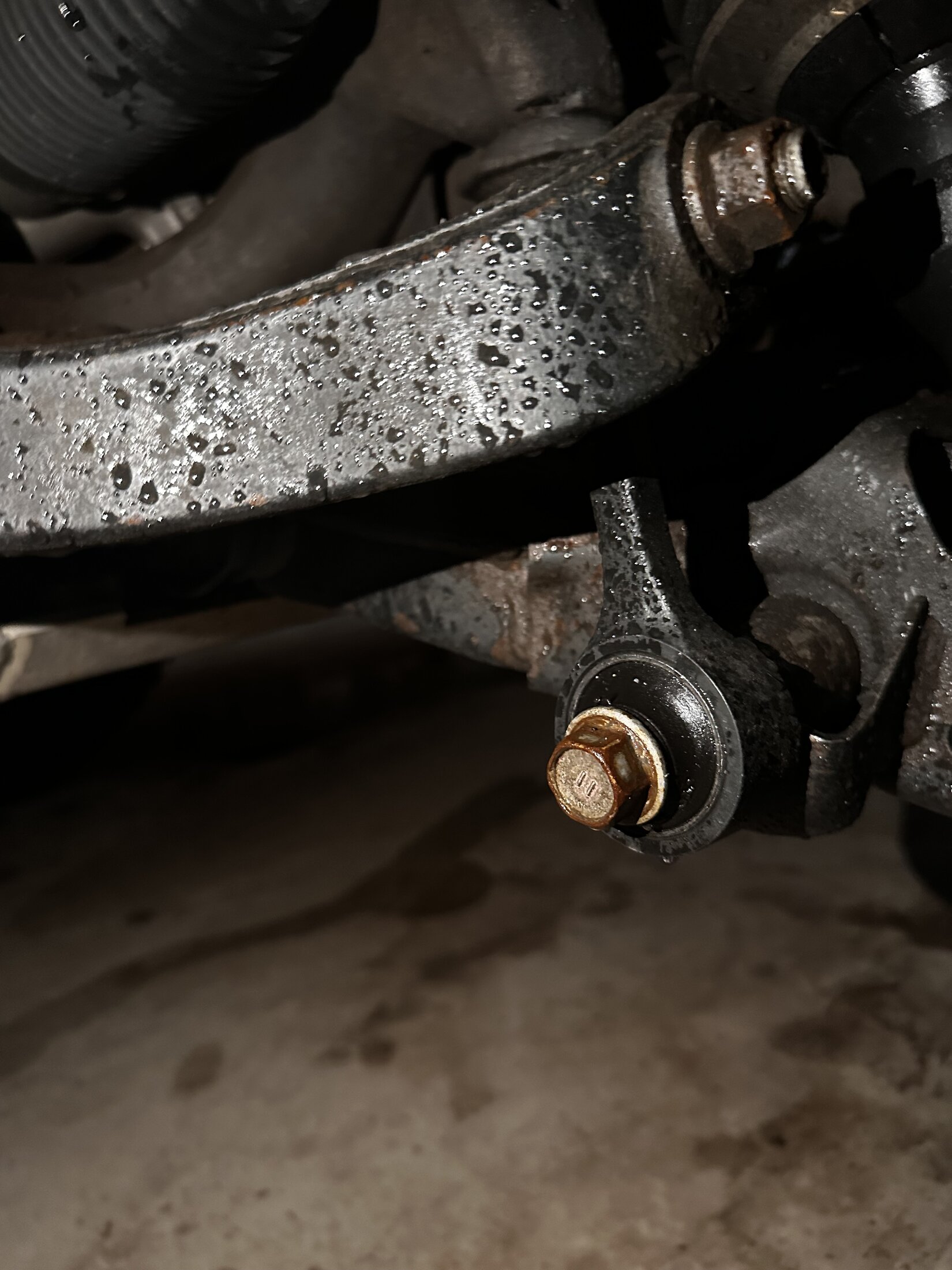

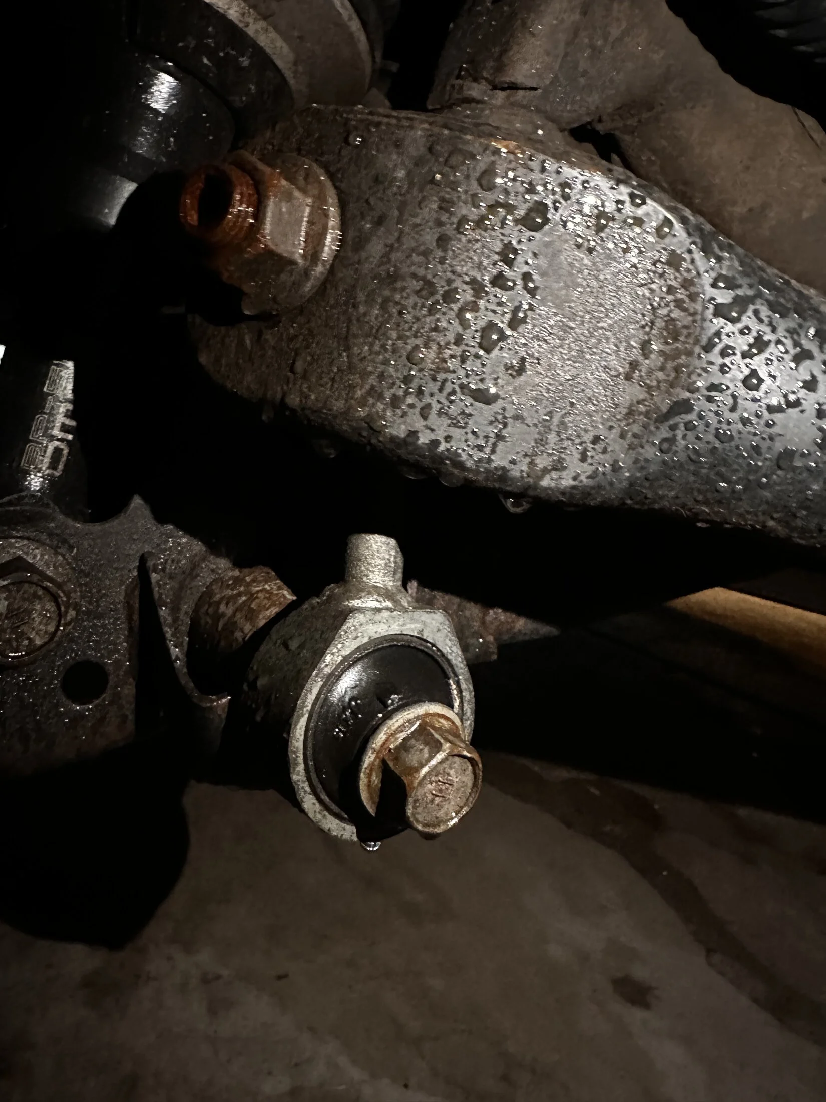

I have pics posted of my setup somewhere around here, but here are a couple I took a while back which are still on my iPhone for some reason:
Prototype of my KDSS Relocation bracket that is 1.5" farther forward.... this will couple with the LCA bracket to bring he end links back into stock position outside of the OEM cradles, and still be in double sheer.
Test fit of the entire system is on track for mid-Dec.. and hopefully an off-road test as well.
if everything goes well, I could have this available in Jan/Feb as a complete kit.

The idea behind the 1.5" is to reduce the angle of the End link bush's back to the stock angle. But right now with the "normal" KDSS Reloc kit I am running no issues with them (that is top one pictured w/ the marks on it)...
