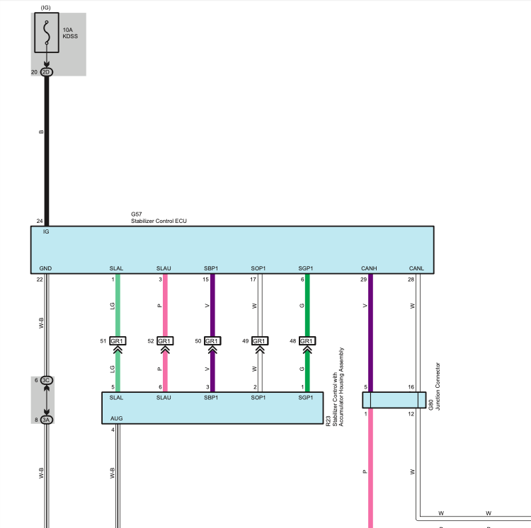

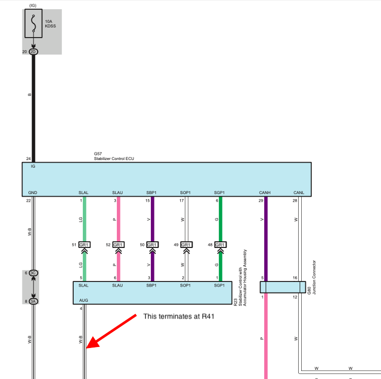

Other available switch solution disrupts this wire (Pin 4-Female side) at KDSS accumulator when activated.

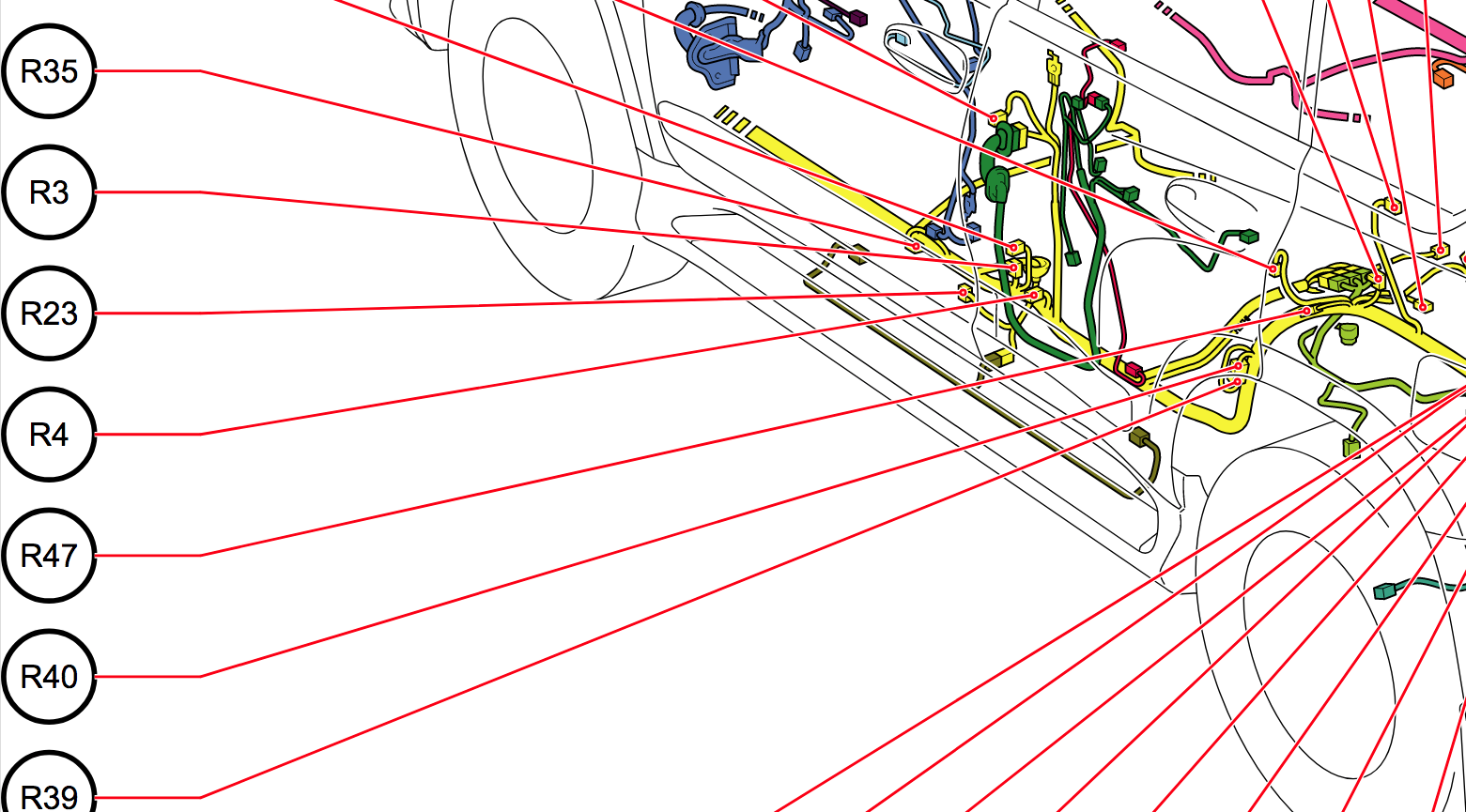

R23 connector is one that attaches to Accumulator

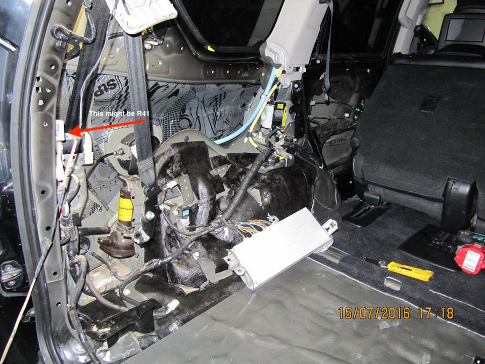

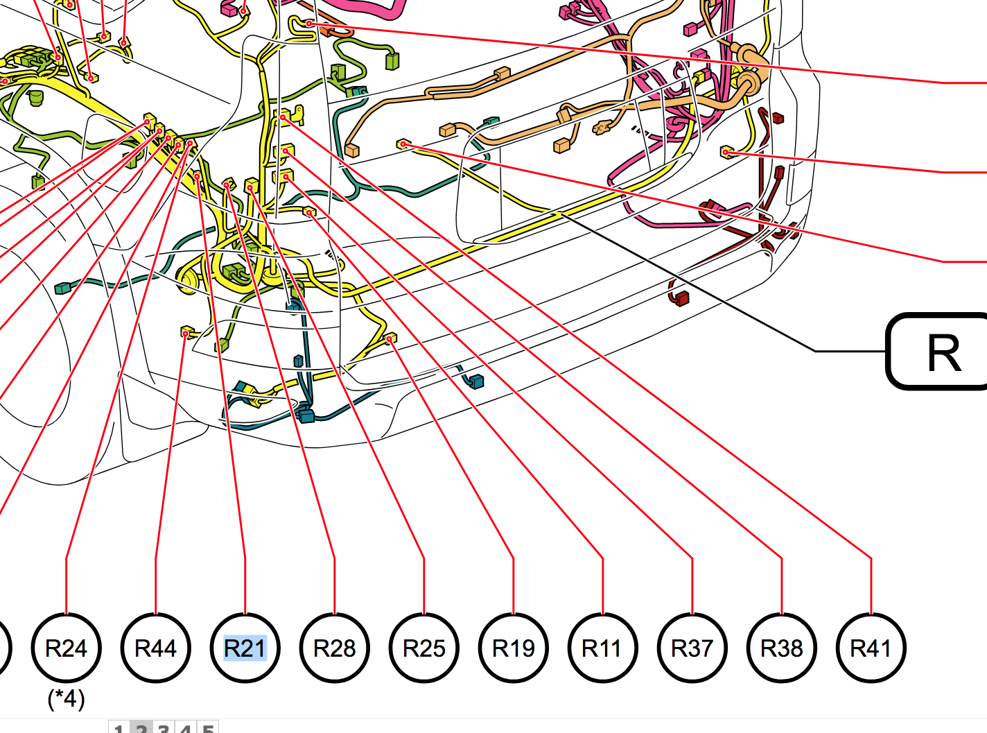

Pin #4 ground connection terminates at R41 in left rear of vehicle

I haven't checked but might be possible to access this plug via the jack area. I still haven't found anything else that terminates at this ground... there could be though.
I'll probably put my borescope up in there in the future to see where it is at.

Frankly not sure if one just couldn't put a toggle switch on positive pin #24 or Ground #22 on KDSS ECU to have the same effect
This will work but I believe it would not gives the indicator on the dash. This module are also connected to CAN, so it might trigger some other fault.
That very well could be. The other other option I posted about temp ground disconnect should work as it is doing the same thing a different product is doing but inside the vehicle. Invasive to setup but another cheap option of some wire and a switch.

That's directly in line with the cargo net mount and the phillips screw.
Probably not easy enough to grab from the jack opening but the panel just pops off there.
The wiring is probably very short to the connector.

Easiest way to know if you have the right ground in that rear driver side tail light area is to disconnect it. This will trigger the KDSS fault light
That white with black stripe wire can be found under the drivers seat (under the carpet) going into the drivers side door sill harness.
I added a switch to that wire to break the ground going to the solenoids. It seems to do what the plug and play harness's do. KDSS light on when the switch breaks the circuit, slightly softer at higher speeds, I find single wheel impacts are less abrupt, when both front or rear hit the same thing at the same time there is no change to "comfort" levels. On street handling isn't really that bad unless there is a hard acceleration or deceleration combined with a hard turn, hard cornering with flat throttle isn't much different than stock.
