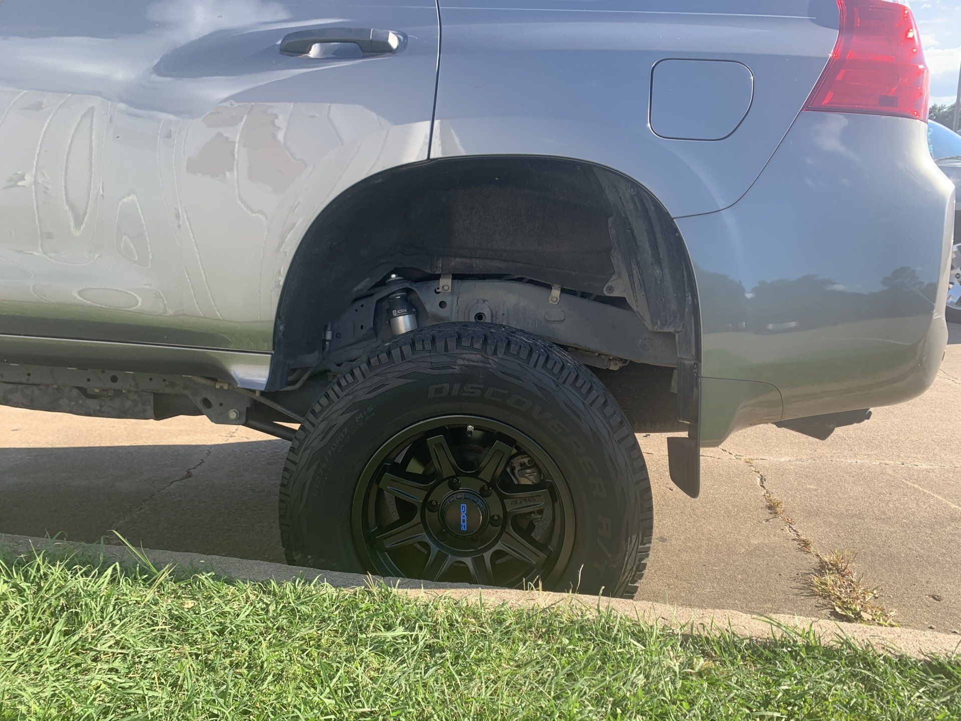

anxiously waiting for a solution. I took the family on a long trip and now my car seems to lean more than usual. my car is lifted now but it was leaning before it was lifted. I really wish the GX460 had basic sway bar instead of the KDSS.
I am one of those that doesn't see any major benefit to the KDSS overall, I too prefer a standard setup. My lean isn't that bad but it's comical that it can vary so much from one vehicle to the next. I am patiently awaiting some of these fixes soon to hit the market.

Seems my truck has now started this issue . Waiting to see the full on fix
There’s a post on the 460 forum where a guy bought a pressurized pump online, bought the same fluid used in the kdss system, emptied the whole thing, and then re-pressurized it all per the FSM. Says it’s fixed the lean and has stayed that way for a while.
Everything I’ve read about the basic adjustment - crack the bleeder valves and jack the left rear tire - suggest it’s just a short term fix. It was only short term for me.
I got the lean correctors from Kyle. I’m trying to see if my system will stay lean free after the full reset. If not, I’m gonna install them.
