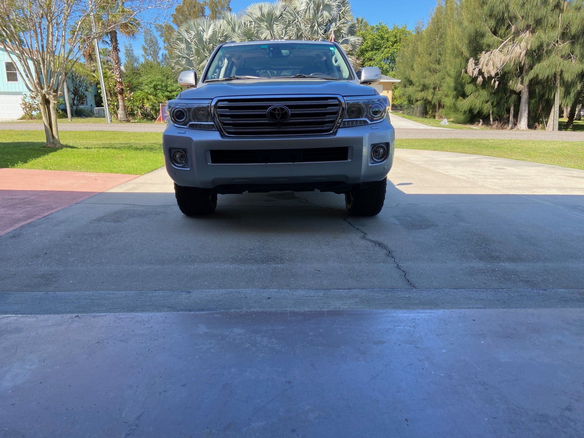

For what its worth, I'm not looking at this from a completely novice point of view. I was an ASE certified mechanic prior to obtaining my engineering degree. So I have a good amount of knowledge both on automotive suspension as well as mechanics of materials. I am a bit limited in the hydraulic department though, so that's more why I'm trying to figure out the KDSS a bit more in depth.
Here is a picture of the truck as it stands today, and yes that driveway is about as level as you can get it.
