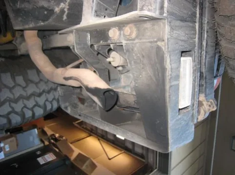

Well, now maybe not bent to some peoples standards, but let's say tweaked. From your activity schedule and description of mods and gear that you carry:
....I go to Moab at least three times a year, and as you know from going to Canyonlands, Moab is just one ledge after another. The difference in trail ratings there is the size of the ledges. My rig is a fat pig (arb w/ M12000, Slee Sliders, Kaymar w/ dual swingouts, 42g long ranger aux fuel tank, AO drawers loaded to the gills with tools, parts, etc., full length roof rack, two kids, a wife, and my modest 220lbs;))....
I'd say you're getting your money's worth out of it.
.....There is no powdercoating left on the underside of my Kaymar from coming off ledges. ......... I've seen bent up ARB fronts, but not a bent Kaymar. That being said, I'd like to see what it takes to bend one (on someone elses rig of course:D).

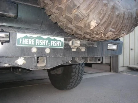

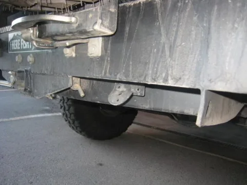

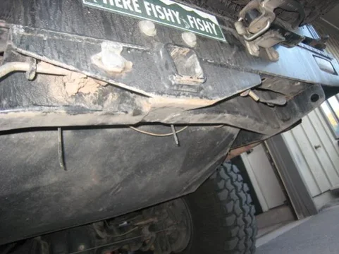

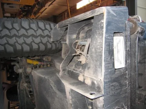

I've got some nicks and dings, but the following pics show how an obviously minor looking hit tweaked the wing up & contacted body sheet metal. No big deal, but this is where I arrived at my opinion on my previous post:
...... and although it held up quite well, you can tell from underneath that the wings are not up to that kind of punishment.
Here's the pics:
The 1st pic shows the (DS) corner ding, 2nd & 3rd show where the brace contacted the body. If you sight along the bottom edge of the bumper, (looking out from underneath the truck) there's a mild stress bend in the metal. I tried a couple of pics, but they don't show this very well.
I've got a similar little bend on that same inner support to the side wing as noted above in that last pic. Those could be stronger than they are.
