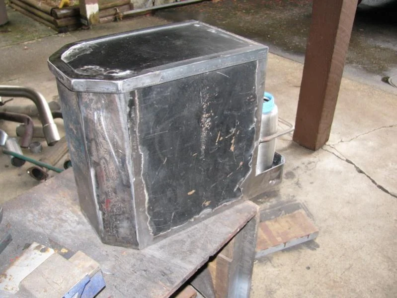

So I am in the process of making a center console/security box. It is kind of like the tuffy and smittybilt, but I am doing my own thing.
Mine is built from about 14 gauge steel, 12 inches high, 8 inches wide, 12 inches long (that is just the box). Going to add cupholders to the rear and possibly to the front. I have a piano hinge for the lid, trying to figure out what lock to use... Was thinking a cam lock? The one on the tuffy looks nice, I wonder where they get it from?
I will try and post a picture or two later today, I know these threads are no fun without pics!
This thing seems pretty large, I was wondering if it is too deep? I might get lost in there trying to dig things out! I thought about welding in a divider, have also thought about cutting it in half horizontally so that I would have one compartment hinge on top of the bottom one (that is a lot more work though and I don't really want to go there right now, bunch of other projects to do).
Anyways, for those of you that have the tuffy and smittybilt, do you find things get lost in there? Do you have dividers?
I thought I could probably put some of my tools in there...hmm

I got the lid basically done, there is angle iron all around the lid except where the piano hinge is, this way the lid overlaps the box and cannot be pried open. Tacked the hinge on, but I have to play around with it a bit more before I weld it on for good.

Trying to decide what to do for a lock still, maybe a pad lock with a cover welded over it so that bolt cutters cannot be used would be best? All the cam locks I have seen look ok, but not sure how secure they are... be nice to get that lock and latch set-up that tuffy uses!
Lid is now welded to piano hinge, rear cupholders almost complete.

Finally a picture! Tomorrow I am going to add a front cupholder and a compartment inside as well as a couple side compartments on the outside, still have to pick up a lock.
Also will be adding one 12 volt lighter receptacle to the front. May add a light to the inside too...

Should have the lock in tomorrow I hope, then I have to weld on a handle for the lid.
Once that is done I plan to prime it then have it rhinolined....
Impressive, certainly looks theft-proof! Will look nice when its got paint. You just gave me an idea

Good question, I had not thought of that...I had my oil pan and battery trays done smooth and they look good. Textured would be cool though, it would hide any imperfections more. hmm...
Another thought I had, I think I will add a slot inside for mapbooks, will have to see if I can make it fit...
