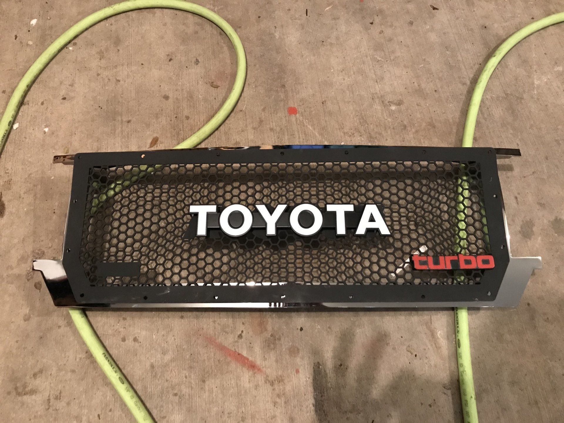

ordered. they’re not stock looking but i think will look cool with my kelly saad grille
