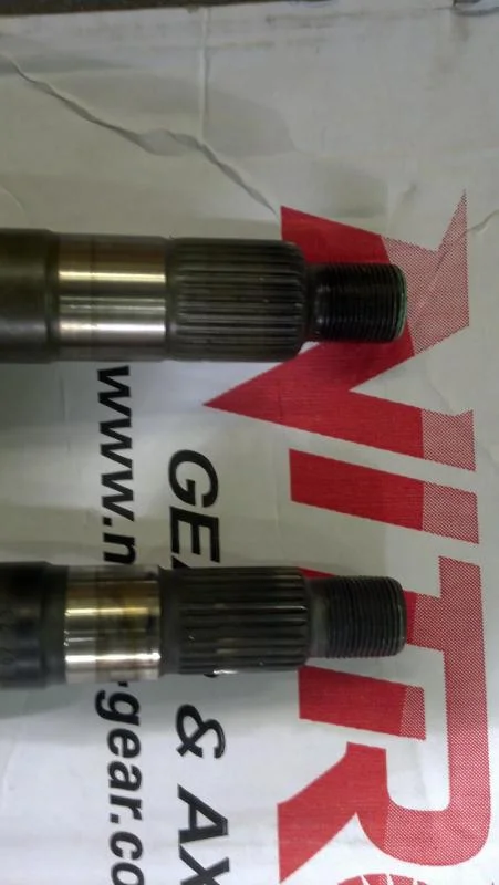

-80 series full float disc brake rear axle with Nitro custom 32 spline chromoly axles, 100 series type 4.88 Ring & Pinion, solid spacer, air actuated locker
- 80 series width hybrid 9.5" front axle Nitro 80 series chromoly birfield kit and custom 32 spline axles, Aisin hubs with chromoly hub gears, nitro 100 series type 4.88 Ring & Pinion set, solid spacer, air actuated locker

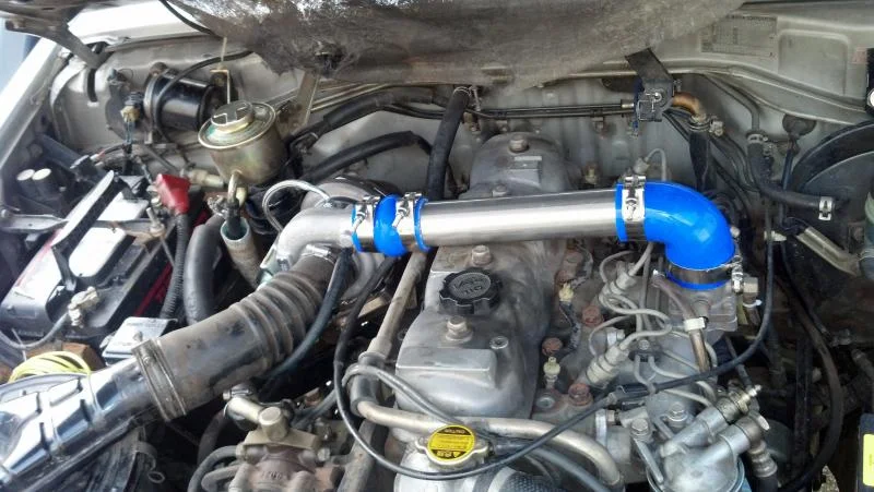

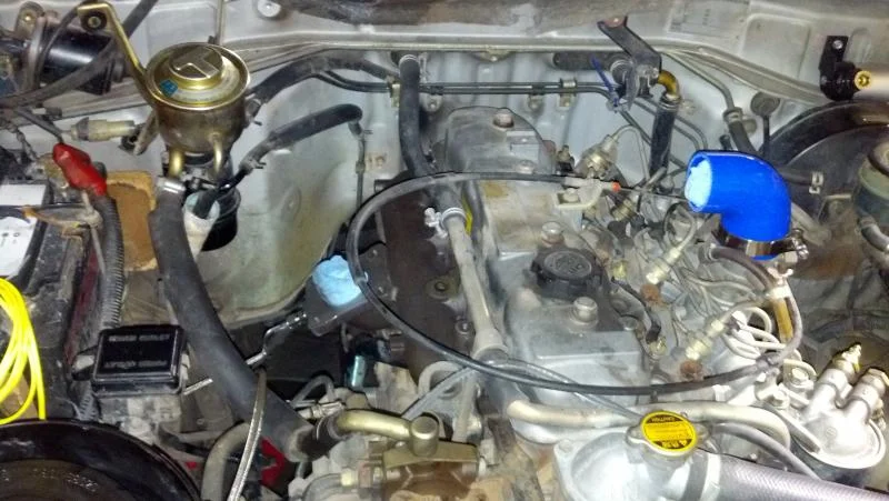

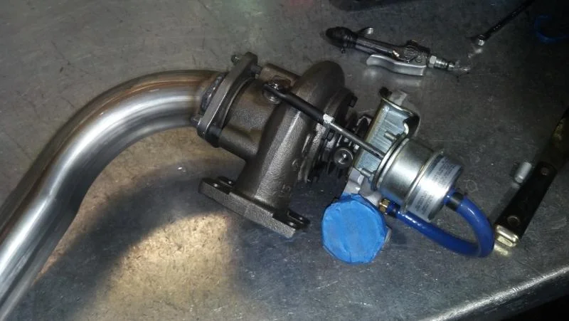

Turbo install Got the Turbo installed Friday.
The kit was sourced from Keith at Jefferson State Machining, he was quite knowledgable, and quick to return my call, and is in the USA. Price is good too, but I told him he should raise his price:)
Link to Toyota 3b Turbo kit
The kit was very nice and features:
-Garret GT Series Turbo
-Oil feed line w/ direct fitting, return line w/ weld in bung for oilpan
-13bt type reproduction Exhaust Manifold, gaskets
-Turbo to Manifold adapter plate.
Not included:
-12" piece of 2" exhaust
-3 bolt flange w/ flare to attach downpipe
-Exhaust
-Depending on your air cleaner tube, you may need to source a 2" 45 degree silicone connecter, and a 2.75-2.0" reducer and another roughly 12" chunk of 2" tube.
Install is pretty straight forward.
Before starting the job:
-check your oil filter, if it points up you will need a new adapter. Ours did, so we sourced the appropriate parts from Steven at EBI Cruisers in BC.
-I'd also suggest picking up a 2' chunk of 2" stainless exhaust pipe to use for the turbo-intake and the air cleaner-turbo
-I'd suggest bringing the turbo to an exhaust shop to have them fab a 3 bolt flared flange with a 90 deg bend and about a 16" downpipe so you can at least drive it to the exhaust shop when finished.
If you do these few things before hand, its no problem to do the job in 1 day.
Results were great. Turned up the fuel about 1/2 turn to stay on the safe side before gauges are in. I then drove about 150 miles accross the state to bring the vehicle to our good freind Luke at Hazzard Fabworks in Spokane,WA for some suspension & cage work. Luke has loads of experience with many high end, high profile vehicle builds and was the official fabricator of the 2012 Petersen's Ultimate Adventure.
More pics to come!

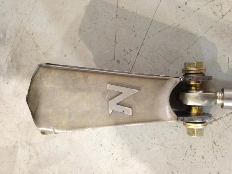

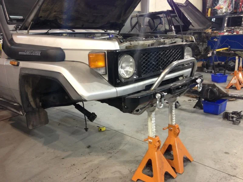

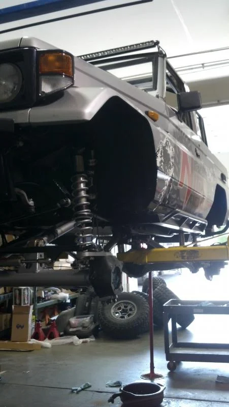

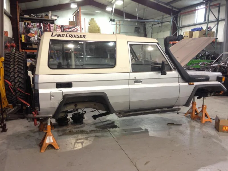

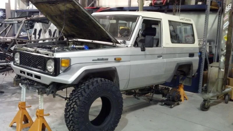

Project Inigo Update, axles are out, hangers removed, frame prepped for link bracketry. Luke having fun with a bit of tire mockup
Thinking the 37's look better than the 40's.

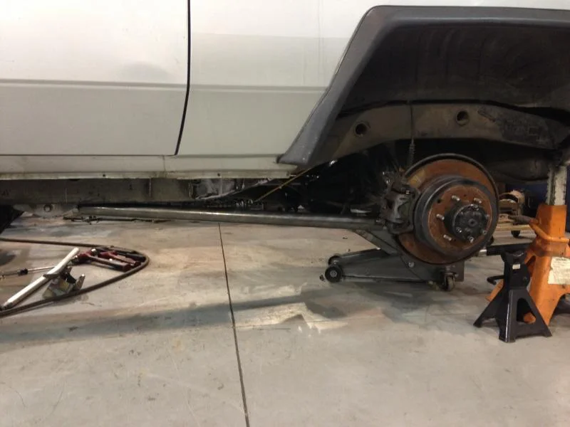

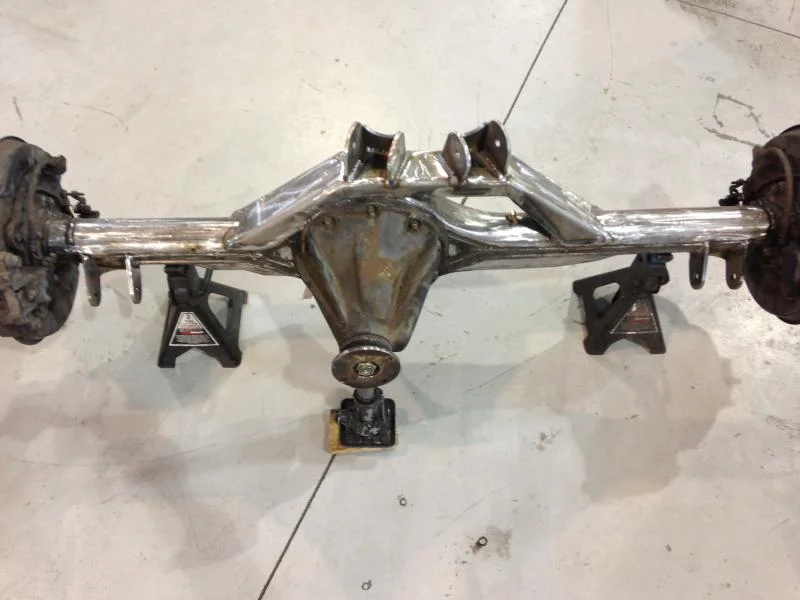

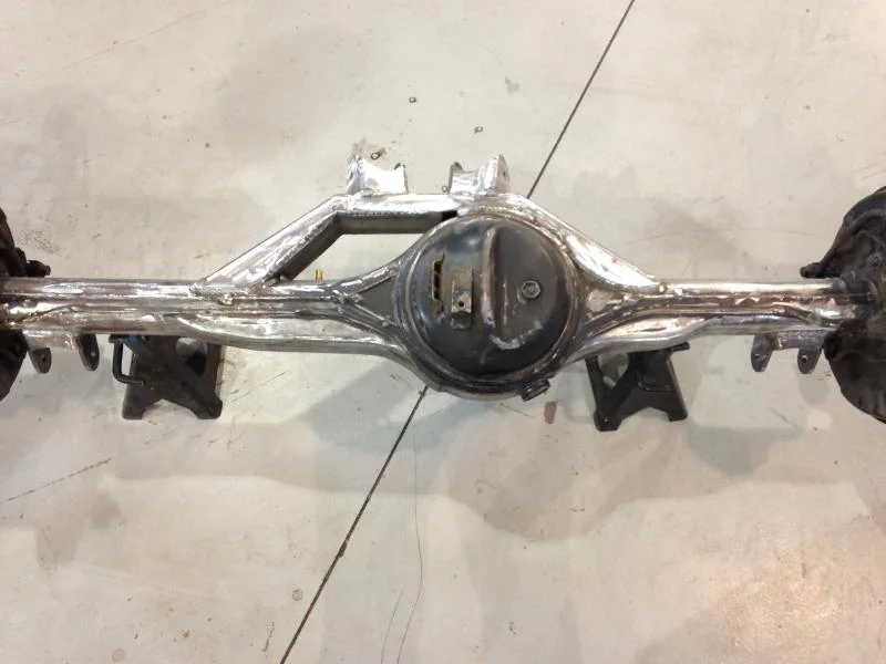

Diffs 80 Series rear axle housing stripped of factory brackets, getting ready for double triangulated 4 link and 12" coilovers in the rear. Lot of work cutting the brackets off, thanks Tacklebox!
attachment.php

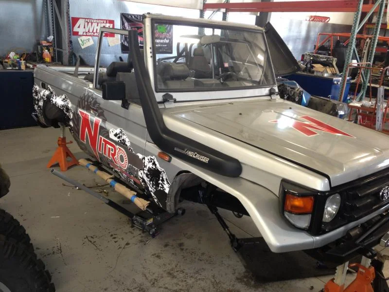

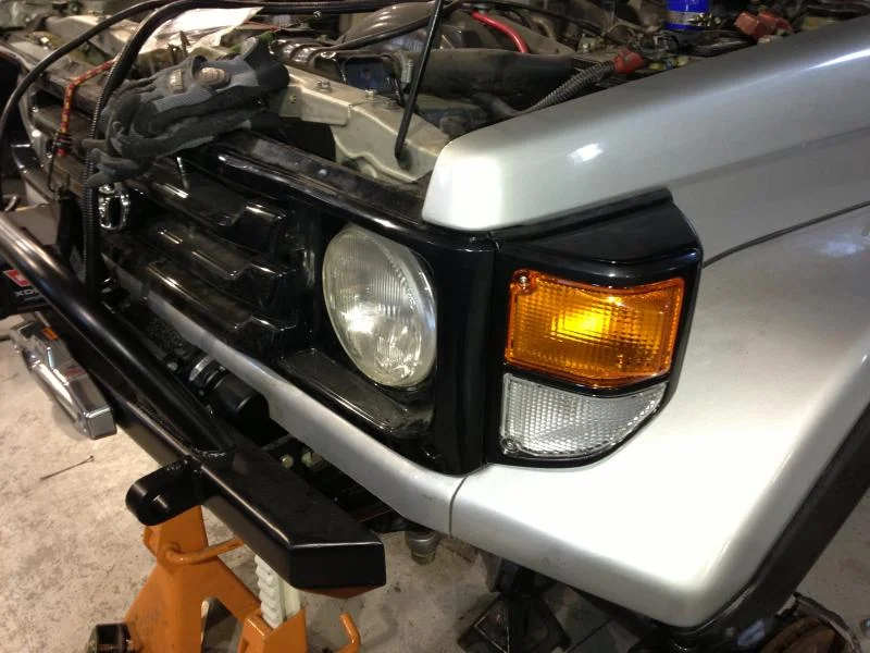

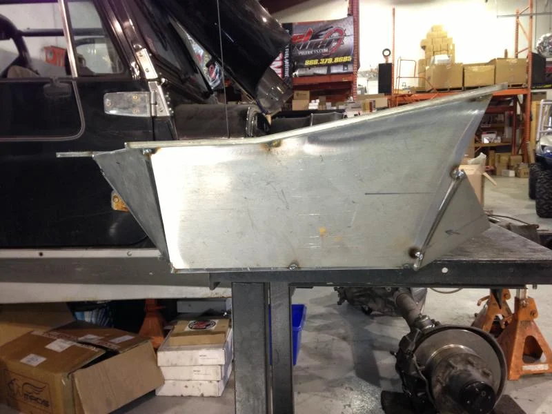

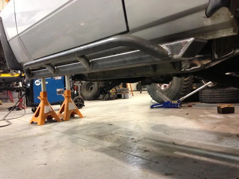

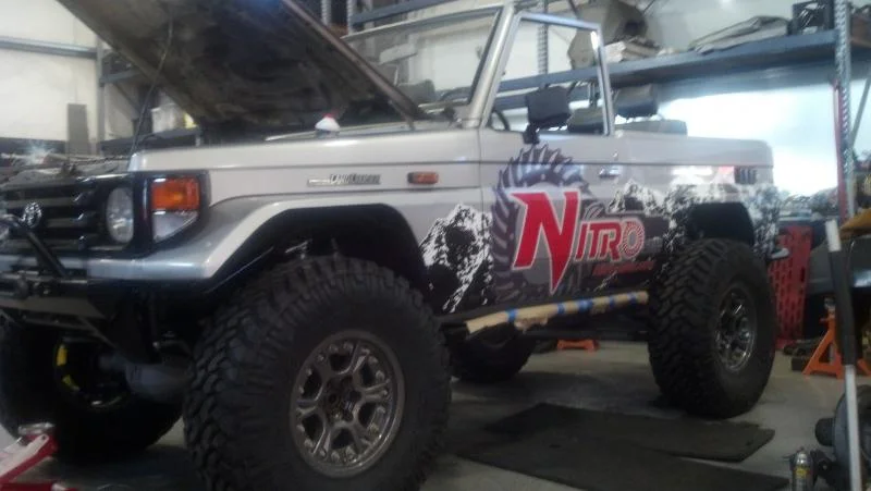

Some Sliders, and a nice start on the front bumper.
Next up Warn XD9000 24 volt winch, Custom roll Cage! Attached Images

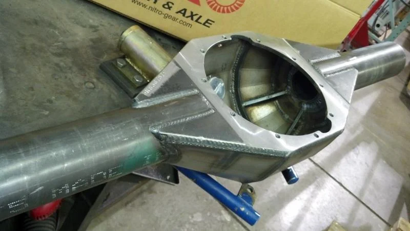

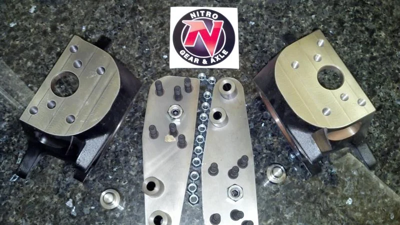

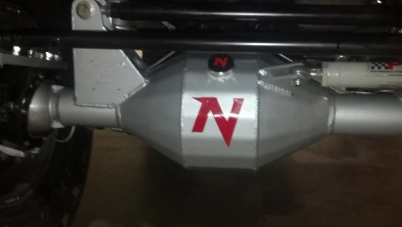

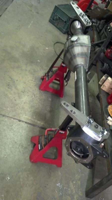

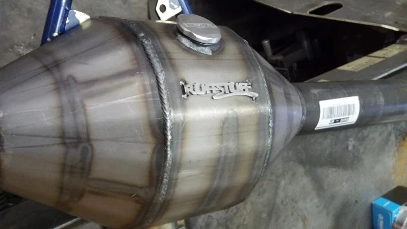

Big thanks to RuffStuff Specialties for getting the axle housing built for us under our tight deadline.

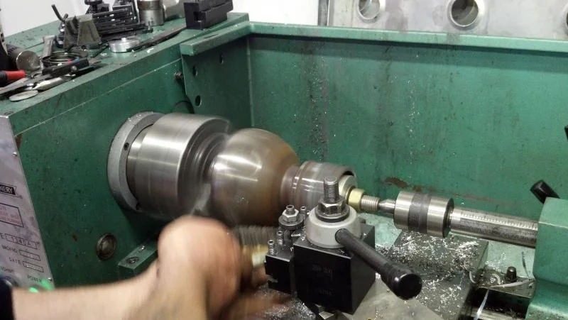

We really didn't want to use the 8" front on this project, so we cut the knuckle balls off to use on the new 9.5" Ruff stuff housing. The housing will except our off the shelf chromoly LC 80 axle kit. We will be using our new 32 spline chromoly Birfield kit and a 100 series style 3rd member and gears Attached Images

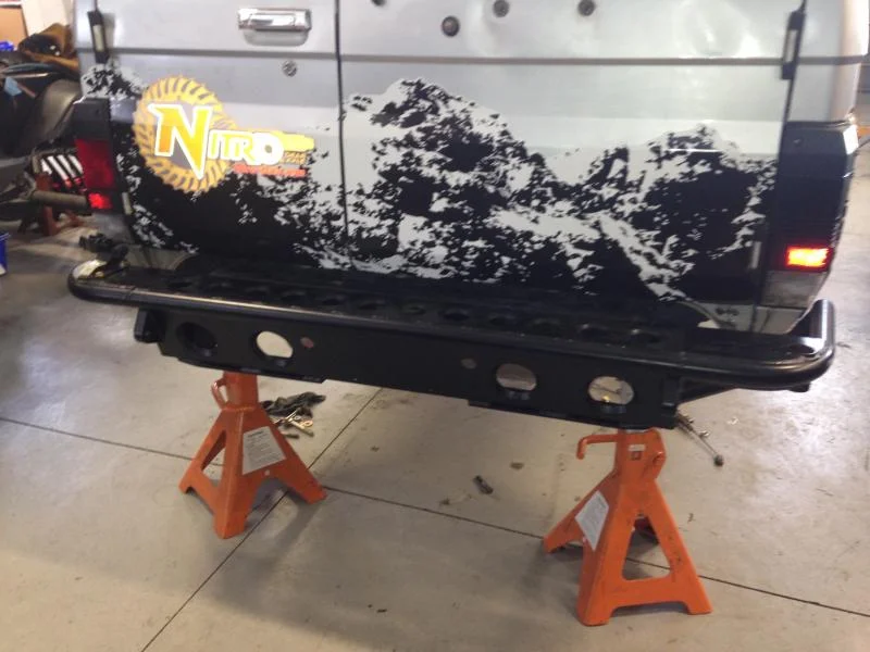

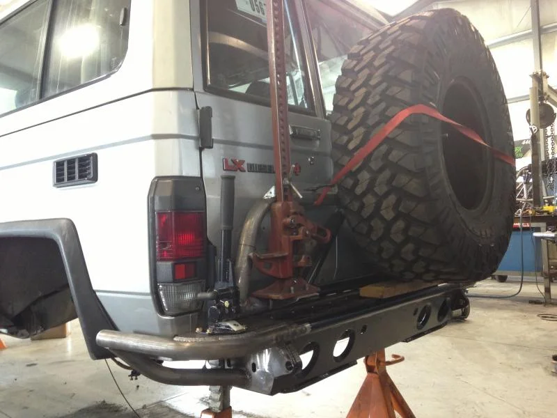

Turns out the Synergy rear Jeep JK bumper was close in width, so we modified it a bit. Turned out to be more work than expected as we had to move the pivot and latch and widen the carrier. Next up is doing the links and axles & some Icon Vehicle Dynamics 2.5"x12" travel remote reservoir coilovers with compression adjusters. Hoping to have it done in time for a shakedown at Cruise Moab. Attached Images

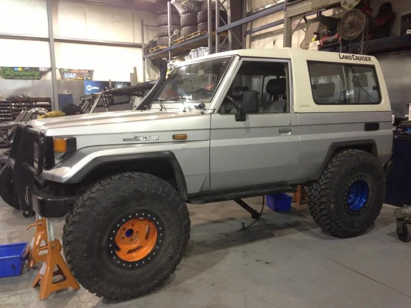

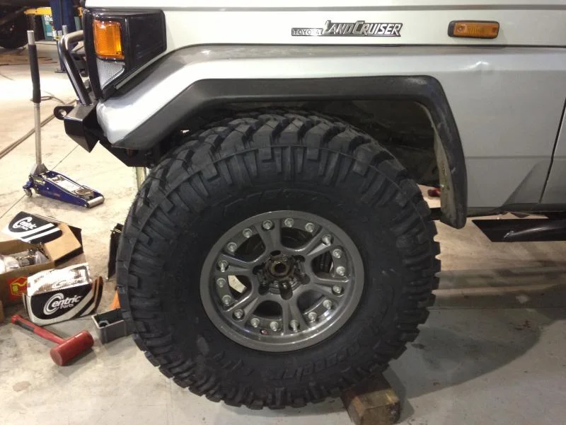

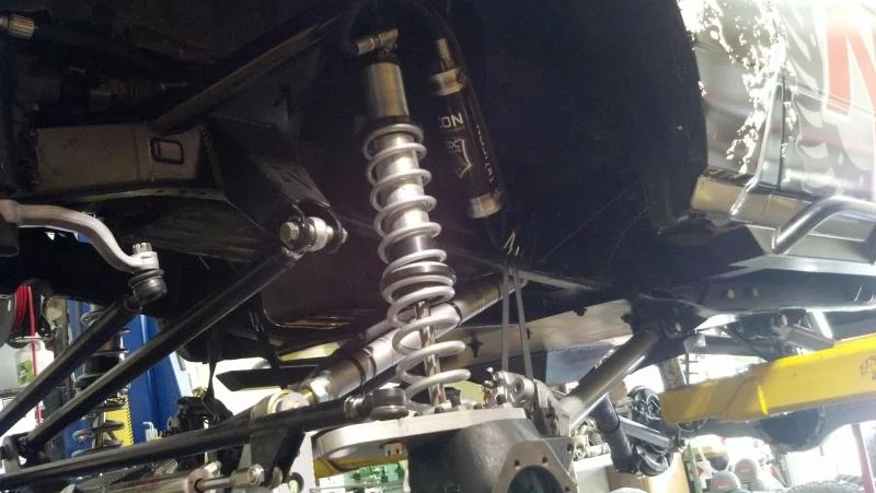

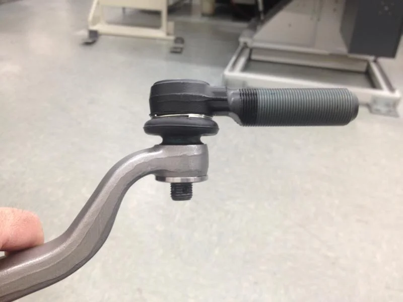

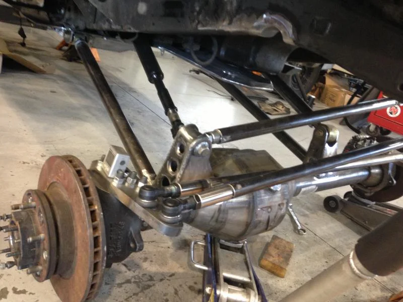

Hutchinson Rockmonster Beadlocks. 3 link w/ panhard & Hellfire knuckles / arms w OEM 80 series tie rod ends Attached Images
attachment.php
attachment.php
attachment.php

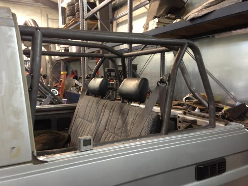

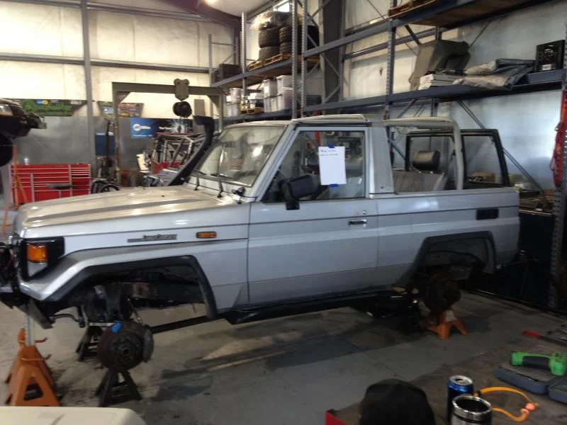

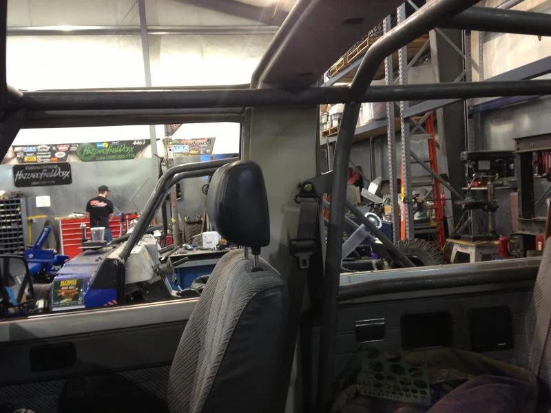

andcruiser BJ73 Top off and building Cage. Attached Images
attachment.php
attachment.php
attachment.php

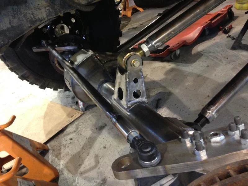

BJ73 Landcruiser Coilovers 3 link & 4 link More suspension pics coming up
attachment.php
attachment.php
attachment.php
More suspension Attached Images
attachment.php
attachment.php
attachment.php

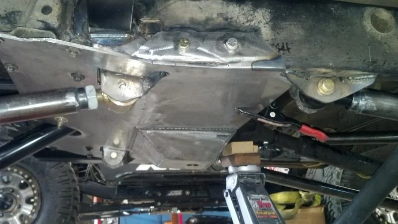

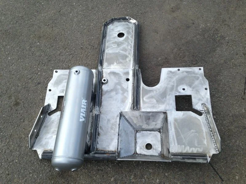

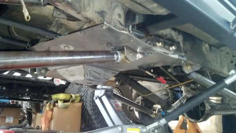

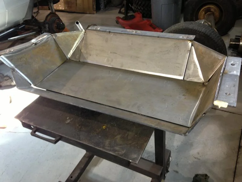

BJ73 Fuel tank skidplate Might as well do a fuel tank and oil pan skid plate. While we are at it lets do the 2006 Grill and turn signal lenses.
attachment.php
attachment.php
attachment.php

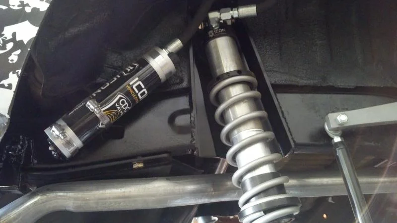

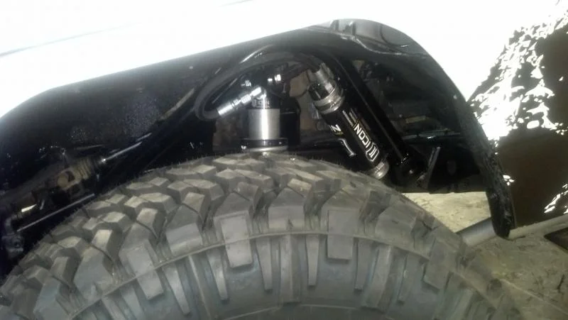

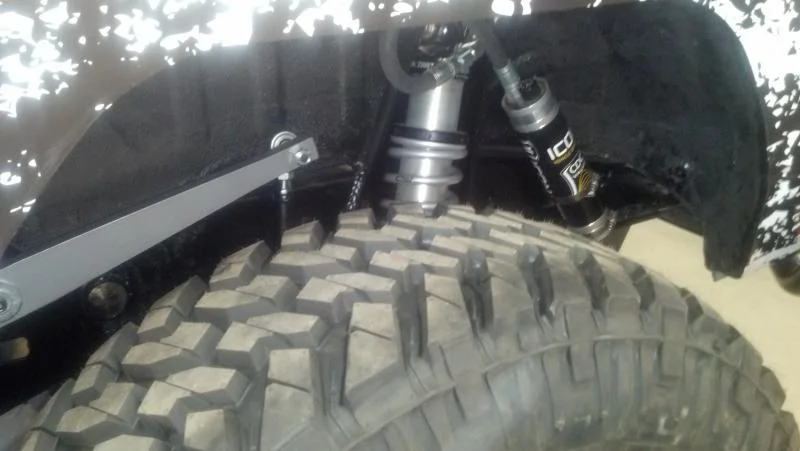

More photos Icon Vehicle Dynamics 2.5" x 12" travel Remote Reservoir Coilovers with compression adjusters - IN had to notch rear frame and wheel wells to outboard the coilovers.

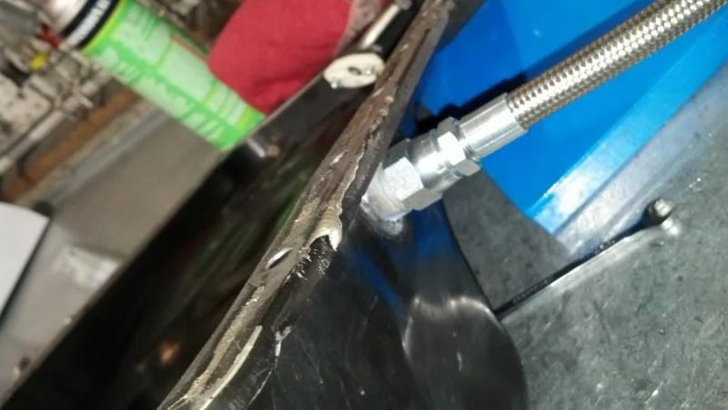

PSC Hydro assist installed, all new brake lines run

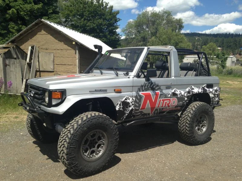

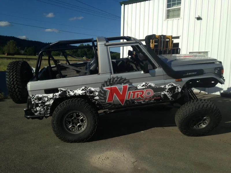

BJ73 Rolling The Nitro Gear Land Cruiser BJ73 project "Inigo Montoya" is driving!

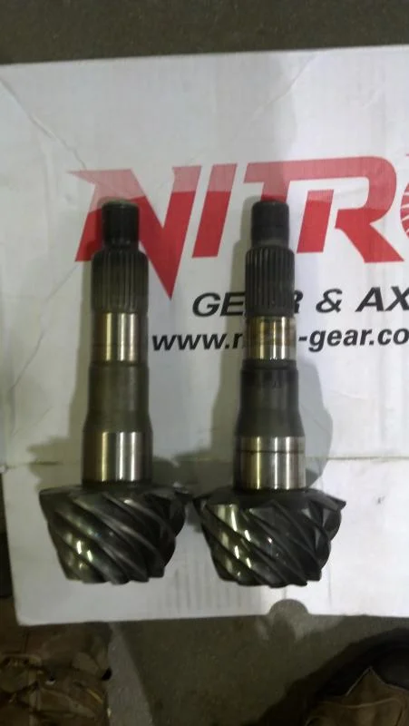

We used some 4.30 Ratio ring & Pinions. these are land cruiser 9.5" in the latest design and feature a 32 spline pinion. This could lead to some future offerings for other models. Attached Images
