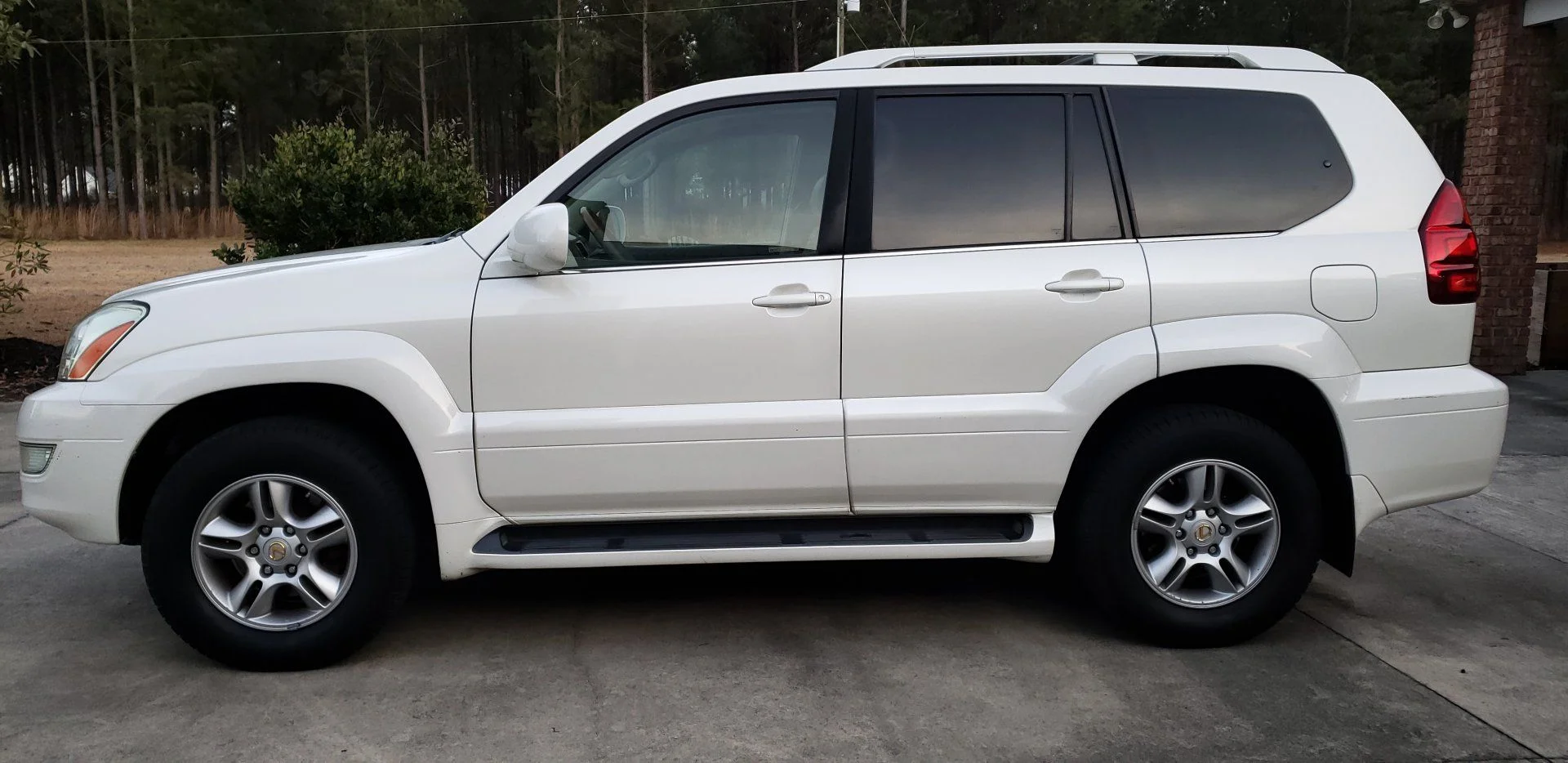

Just picked up 2006 GX470 with 209k miles Blzzard Pearl.
Jan 13, 2021
4
35
Holly Hill South Carolina
45 plus service records, one owner, no accidents. Everything functions properly including center diff lock. Overall very good shape, dash is cracked. Have info on Lexus paying for dash replace due to being defective.
Anyone else read this?
Factory wheels and tires must go. I'm 6'5" and the seat is hard on me. All in great condition.

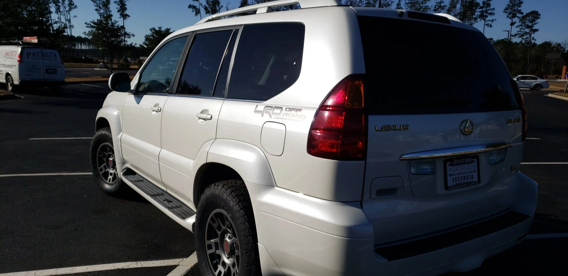

Thanks everyone. I ordered TRD pro rims in matte grey, and Toyo 265/70/17 Open Country AT3, got tpms sensors and took all to local wholesale club. I installed them last night. It's a little taller and rims moved out (offset) about an inch, so bulge in tires are past fender flares by about 3/8"

She's smooth. I named her Kraken because she's unstoppable! My plan is to replace front and rear bumpers, then, running boards with sliders. I'd like led lights in every socket inside and out. I just like the look of the steel bumpers and skid plates, not sure I will ever locate an off-road trail that I would enjoy going down... Nice to know I could. The Tesla style touch screen stereo panel looks awesome, I want it! I need bluetooth. The rear tire mount swing out definitely rocks. Once I determine the best bumpers, I'll order another tire and rim to mount in the rear and remove the mommy rim and tire from below. Those are Michelin with about half their life gone. Anyone want them before I carry them upstairs in my shop to remain sitting indefinitely?

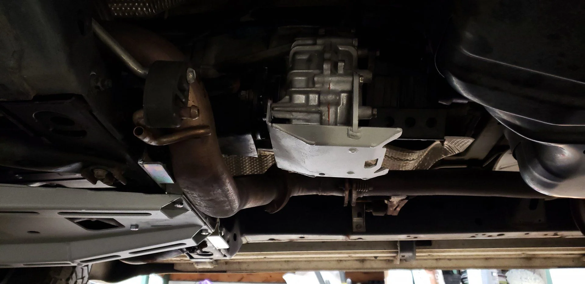

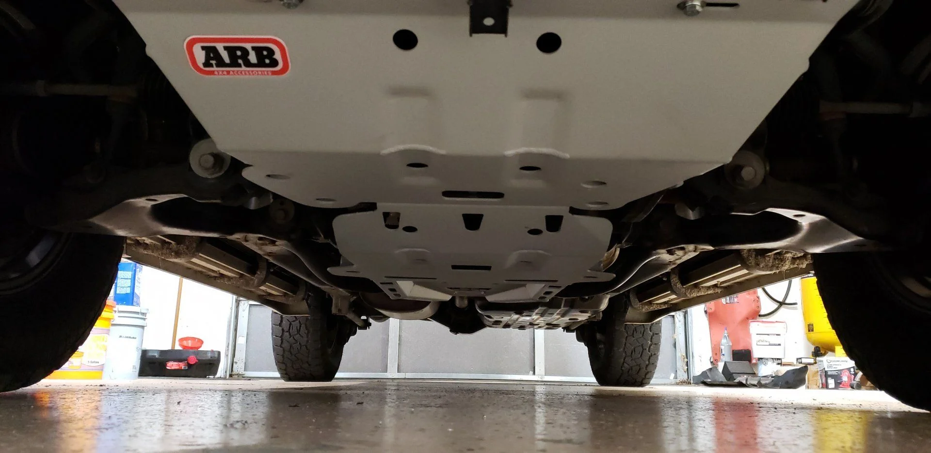

Got my ARB skid plate set and installed. Hate to say but apparently ARB has issues with quality control. I had to drill out 5 of the 6 holes in the transfer case skid plate. Still need to remove to paint. The rest was straight forward excepting the use of holes in mounting bracket (provided) that states my 120 Prado uses middle holes in trans skid rear to bracket. The holes in skid will not reach that point, use outer holes. Overall, I'm pleased with product. Cheap insurance protecting vitals and no need to remove for service.
