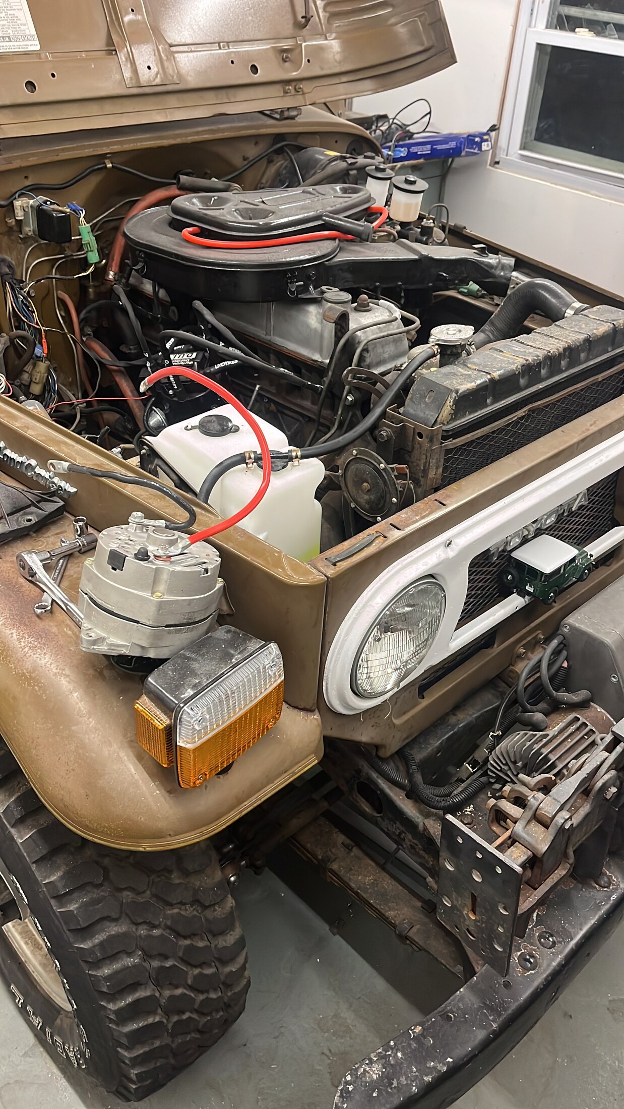

Below are two photos showing how my alternator is connected to the battery.
I’m trying to figure out if I should fuse that red wire that comes from the alternator to the battery.

Old harness is disconnected
The alternator output is over-sized for the existing harness. From the photo, it barely fits the alternator bracket and position of the battery.
