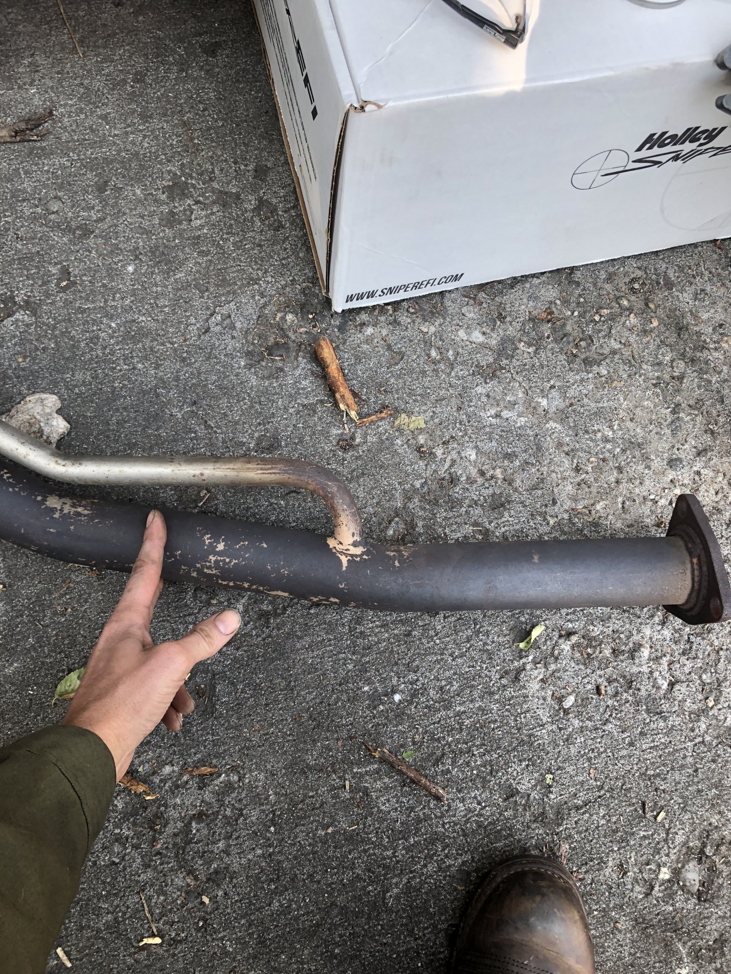

Thanks fellas! How’d you go about connecting the headers to the cat? I’m toying with cutting my OEM down pipe, having a bung for an o2 sensor welded where the bypass pipe connects and using a flex pipe to connect to the collector...View attachment 2786225View attachment 2786226
I have a sneaking suspicion that these headers were designed for a Chevy straight six...
PLEASE do cut this down pipe

I did the cut washer trick on the MAF unit as well. Their "test pipe" fixes cat issues such as restrictions and theft. 😉
I aleady chopped off my cat. What's this test pipe you speak of? Looking at their site, wondering if I need to order anything or if I can just weld the thing to my downpipes.
Thanks,
Dan
It's just a piece of pipe with flanges on both ends that fills the section where the Cat' used to be.

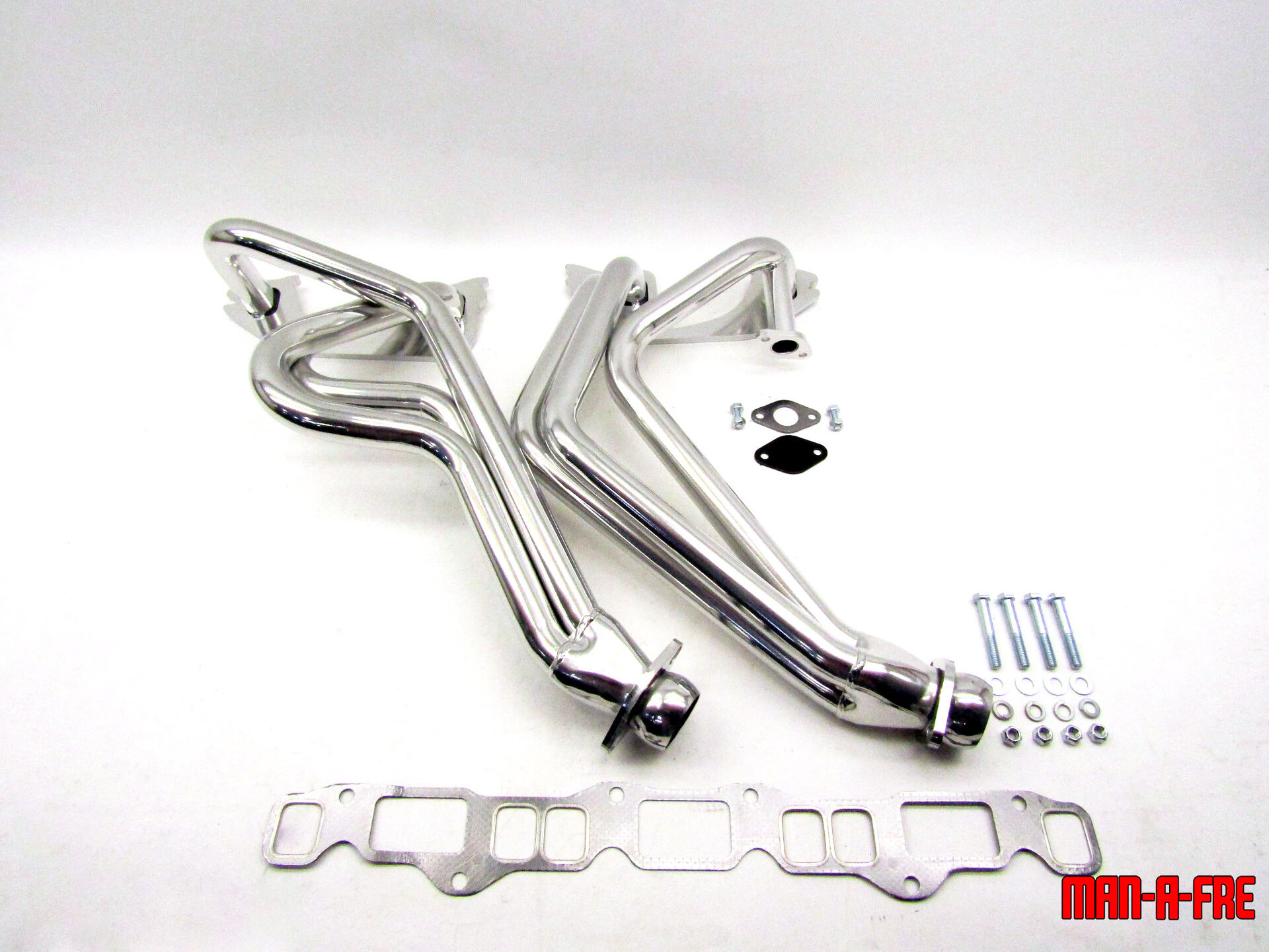

Got my 60 a few months ago, and was having a hard time starting. Took 4-6 or more attempts to get it to fire and run. Took it into a local cruiser shop, since I knew nothing about cars, and they said it was the Carb, and to take it to a Carb shop.
The PO was from sea level and I am up in the mountains so I figured there was some truth to this but....
I had a gut feeling it wasnt fully the carb as everything ran fine once I got it warmed up and I dont know sh*t about cars, so I tried the old "spray carb cleaner" on the intake trick that I saw on youtube (lol), and sure enough the engine fire up when I sprayed it.
I then hooked up a vacuum test (after installing a port on the intake) and found pulling less than 10 mhg.

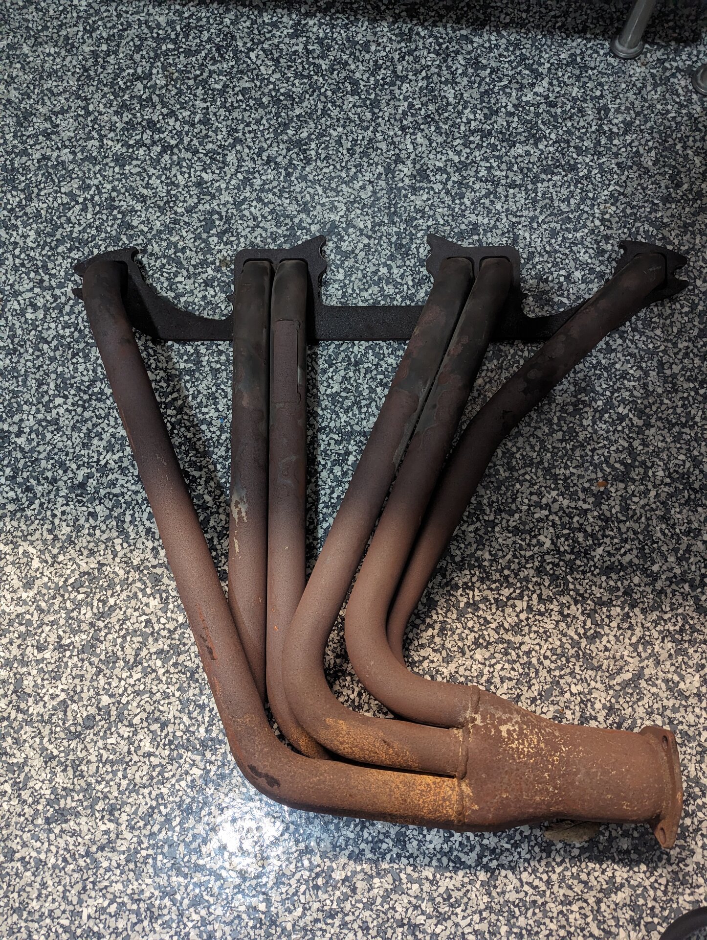

While doing some research I found a youtube video complaining about JT Outfitters headers, didnt think much of it.
Went out and took a closer look at my intake and realized I had these damn exhaust headers on my vehicle too, and it hit me, that the problems are all related.
Note To Self: Avoid JT Outfitters moving forward
Exhaust header removed

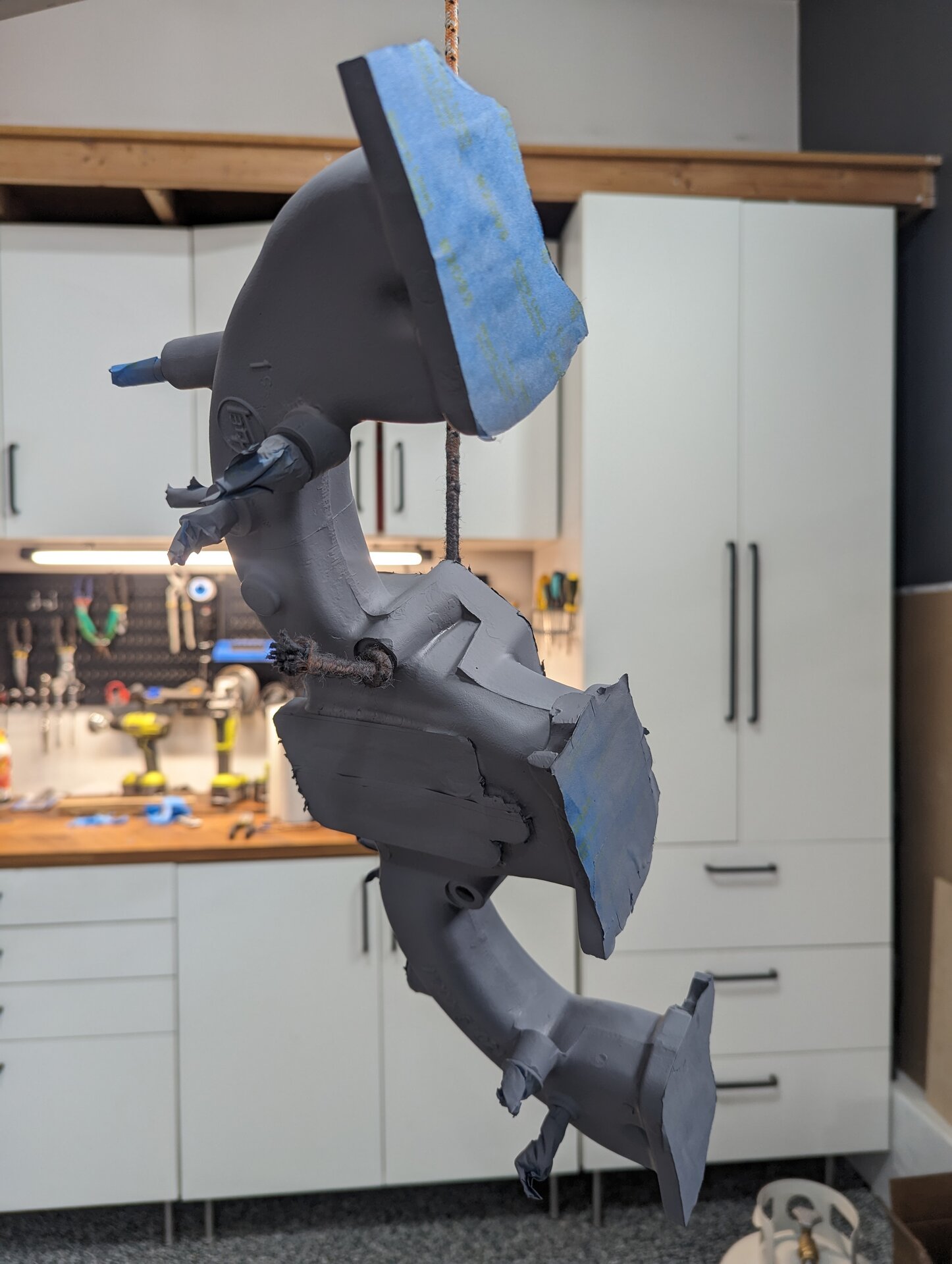

Again without knowing much about cars, I decided to dive in and remove the intake/exhaust, and quickly realized I bit off more than I could chew as a newb, but kept going....its only money right?

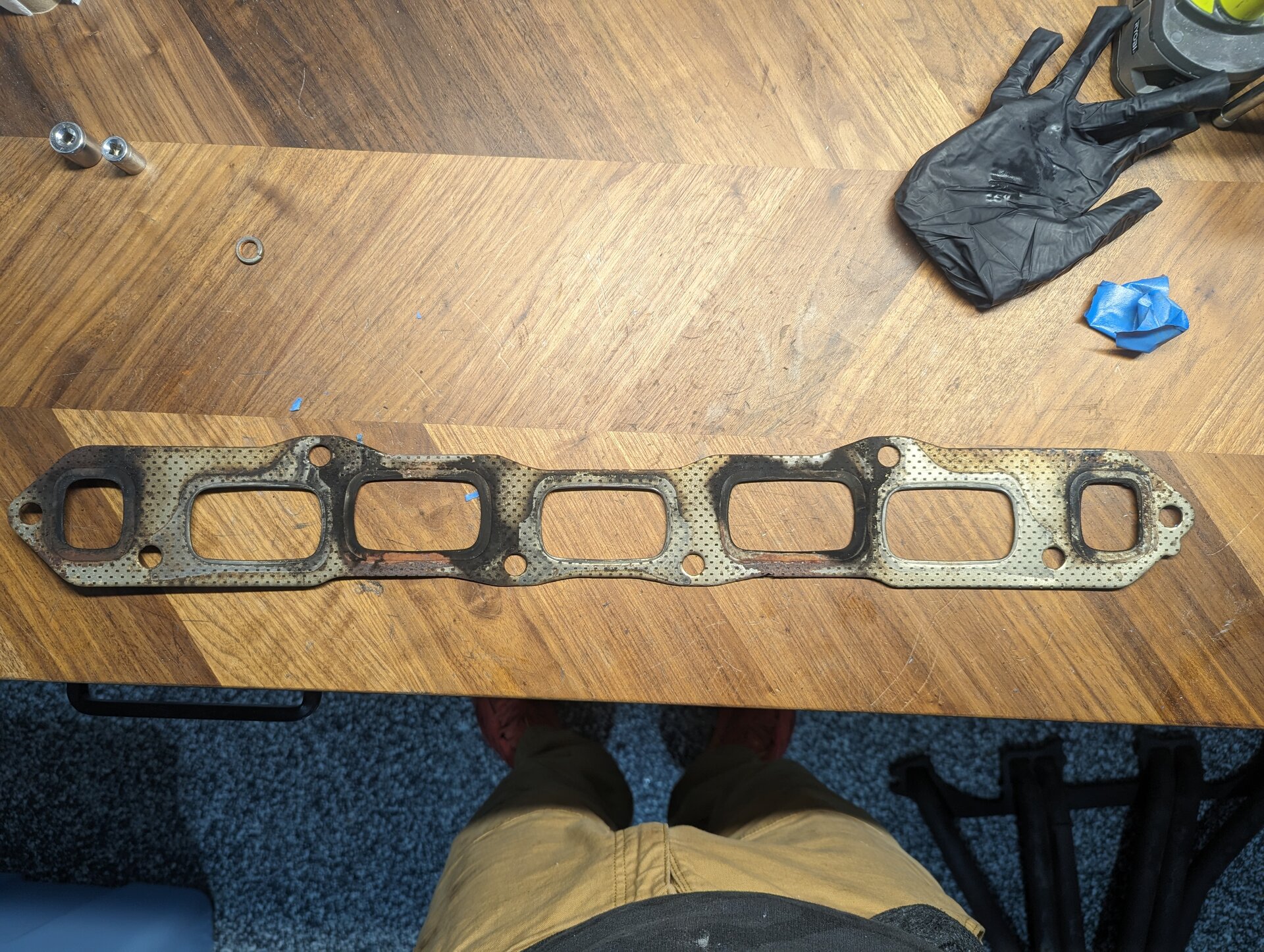

I got the gasket off and it was clear that I had a major intake leak.
Bought the Man-a-fre ceramic coated exhaust header kit, and re-installed it all.

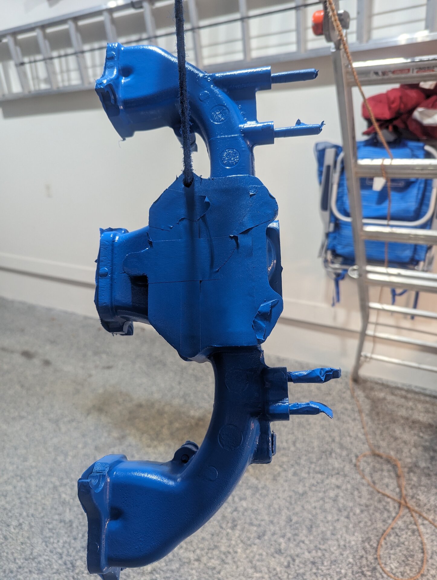

While the intake was off i decided to clean it up, and paint it the same color as the rig.
BAM she starts like a champ!
Vacuum reading is showing 20mhg which I am not sure is true, but regardless now I need adjust the carb somehow.

How did you align the mounting flanges? I used some washers that I cut on mine and it's been problem free every since.
My JT heaters have been running great since installation a few years ago. No issues at all, my OEM manifold was leaking all over the place before replacement. @wngrog recommended them to me, and whatever he says goes IMO! The Remflex gaskets are great too.
The intake was warped badly...forgot to mention that I took it to a machine shop and they machined it flat. The intake and the new exhaust header were very close in width so it hooked up just fine using the gasket.
I threw the JT Outfitters header out
Interesting. The flange on my Man-o-fre was much thicker than the intake.
almost positive that is what I am running. I also did split washers and I have had to replace the gasket once or twice.
why did you have to replace? Just not sealing well or was it a crappy gasket? how many miles before it started pooing on you?
mine developed a leak and it caused a clicking that sounded like something way more serious. Seems like it happened after about a year, but I would have to go back and check. Replaced the gasket and it has been good for a few years. Every now and then I hear a small pop release of air so I know there is a leak, but no clicking noise. Nothing that bothers me enough to address.
