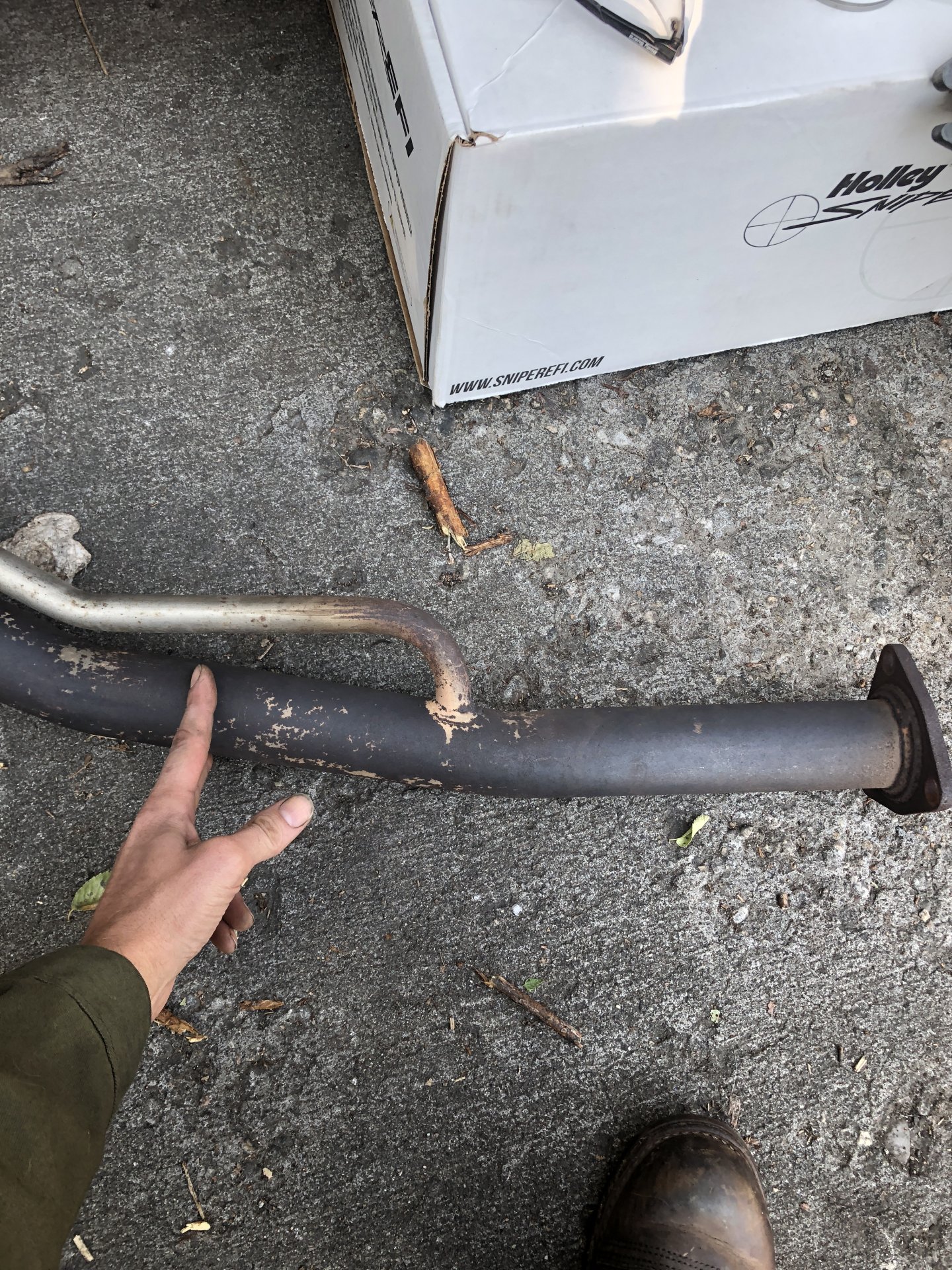

Thanks fellas! How’d you go about connecting the headers to the cat? I’m toying with cutting my OEM down pipe, having a bung for an o2 sensor welded where the bypass pipe connects and using a flex pipe to connect to the collector...

Don't cut the down-pipe. It's stainless and you can sell it if it's intact to get back some of your costs.
Once the header is installed, easiest is to drive to the nearest Exhaust shop (your neighbors will hate you) or have it towed and let them do the rest of the exhaust. A cheap $100 CAT can be welded in so you don't have to worry about those funky Toyota flanges or flange gaskets. If you still have the original CAT, they are VERY restrictive (worse with age) and should be replaced with a free-flowing one anyway or you defeat the purpose of the Headers. Man-a-Fre sells a bolt in kit, if you're interested.

Easiest then would be to concentrate on making the new setup leak-free and let the muff shop do the header-back exhaust. Being in CO, I'd ask for 11ga 2.5" Aluminized pipe. That's what the MAF kit is. They can weld the O2 bung into the pipe just after the collector.

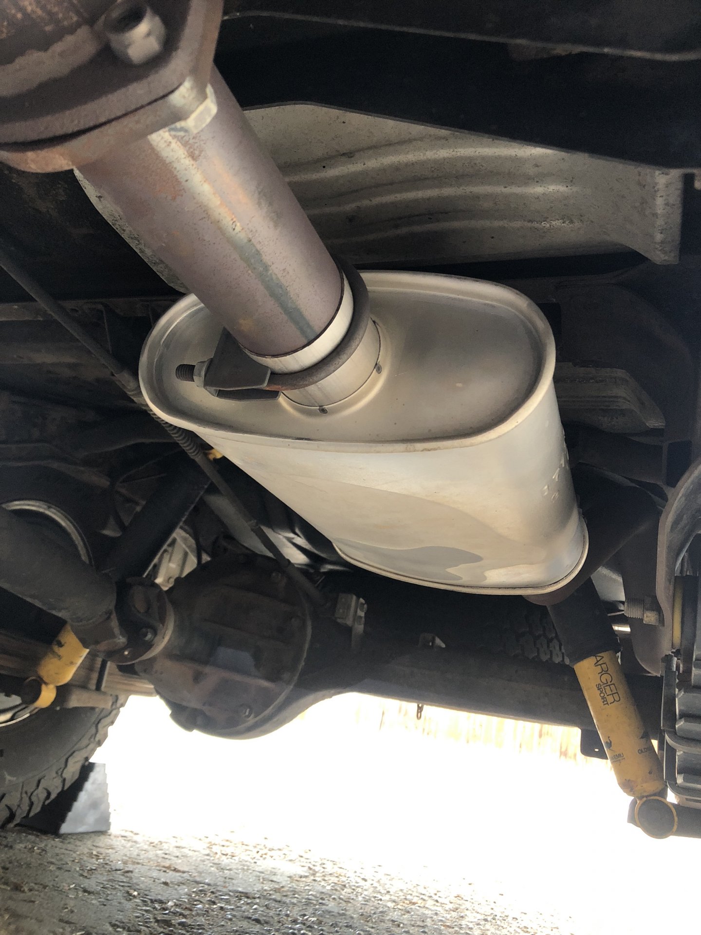

I just installed a new cat back exhaust a few months ago.
the muffler is aluminum but the pipe is regular old steel...

So seems like all you have to do it just get the header collector connected to the CAT and have an O2 bung installed. Should be easy and cheap.
