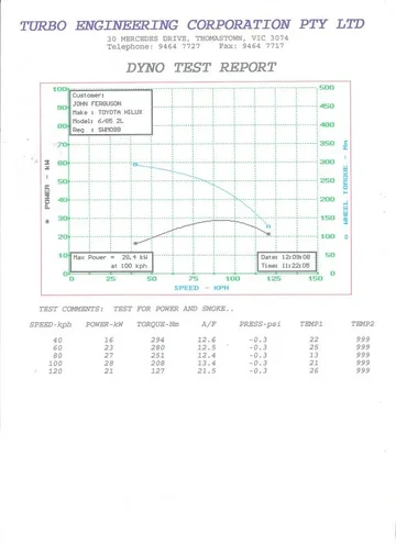

Saturday, 13 September, 2008
sierrajim said:
so it's 38hp before or after the tune?
It wasn't tuned, only the Ignition Timing was adjusted.
