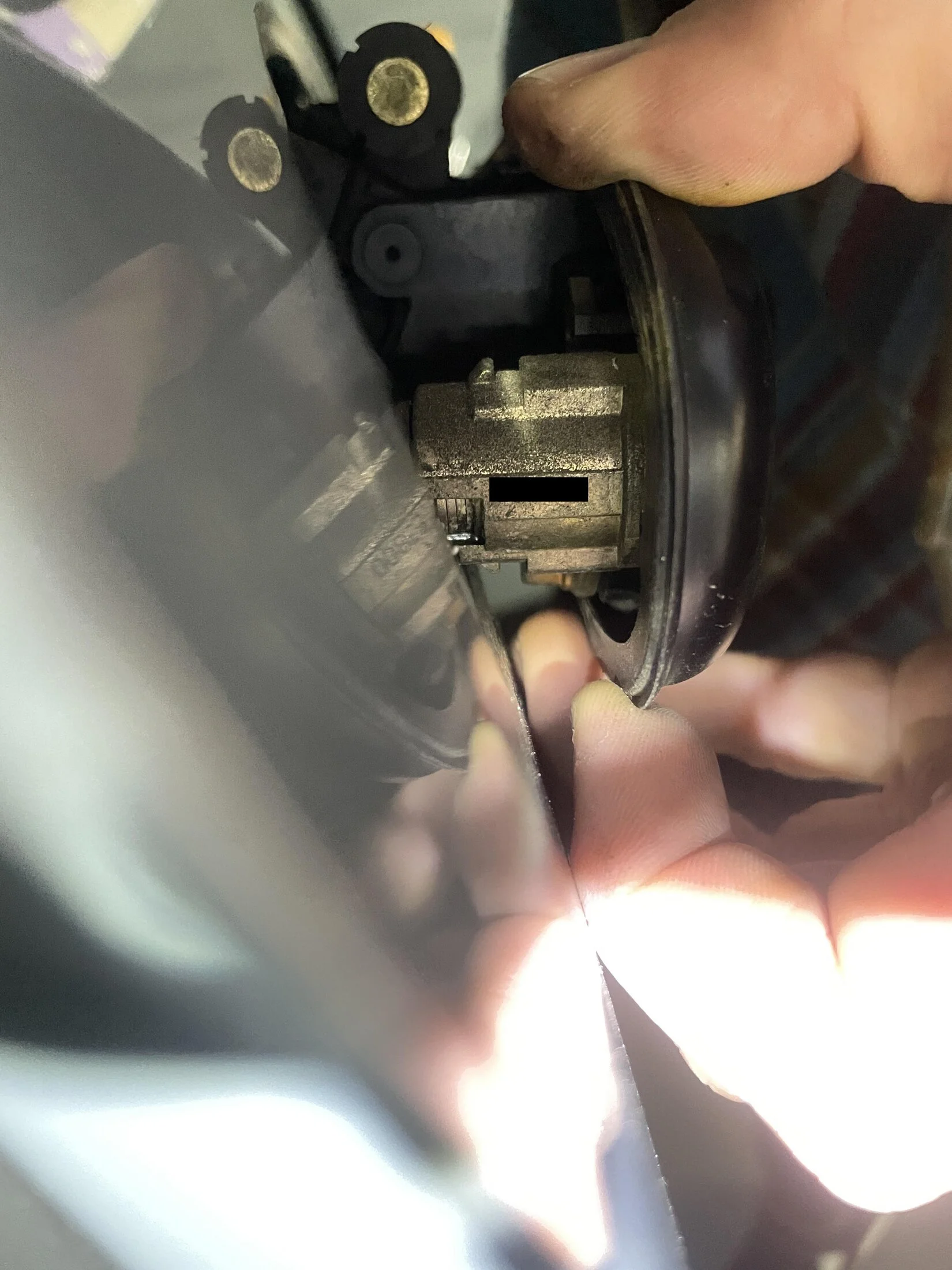

Yo I've got the same truck ('98 HDJ101) and went through the same thing. I have a friend in Japan so I was able to order OEM key from a Japanese dealer, and it worked right out of the box. They quoted me 11550 JPY for a plain key, 26730 JPY for a remote - I was told the car does have an immobilizer, idk.
I had to pull the driver door handle to get the lock code off the cylinder - 5-digit number. Pop the driver door panel off, undo a few screws behind the handle, and you'll be able to just pull the handle out enough to see the cylinder. For me the number was printed upside down.
If you give that and proof of ownership to a dealer, they can make you a new key. I imagine they can do a non-remote key at a US dealer.
Good luck
You may want to obscure the reflection of your lock number too :D

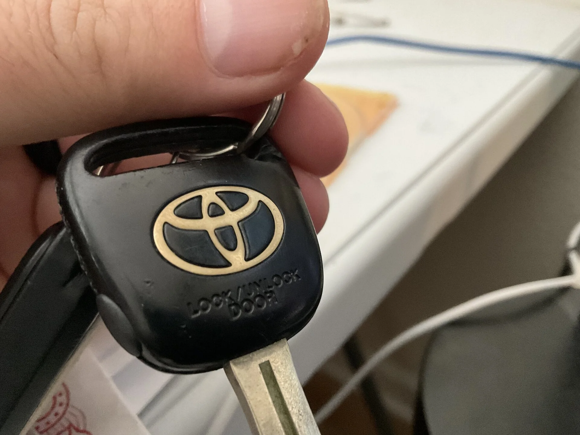

Hi Guys i have the same issue on my LC 100, its a Japan Spec. The key works manually only, the buttons dont work to lock and unlock. I wanted to change from this key to the newer model keys with the 2 buttons, is that possible? Any ideas please?
Have you tried replacing the battery in your current key?
For anyone with this key, if your issue is a broken plastic case, you can order part 89742-24070, cut the key blank to match yours and swap the electronic guts from your current key into your new Lexus key fob shell.
The Lexus key uses a different radio frequency than the JDM key, so find a friend in Japan if you are looking to add an additional key fob, but if you're just trying to keep your current key alive and the plastic has broken and your resorting to whatever is happening in the pic above (JBWELD?) there is a solution for you.
