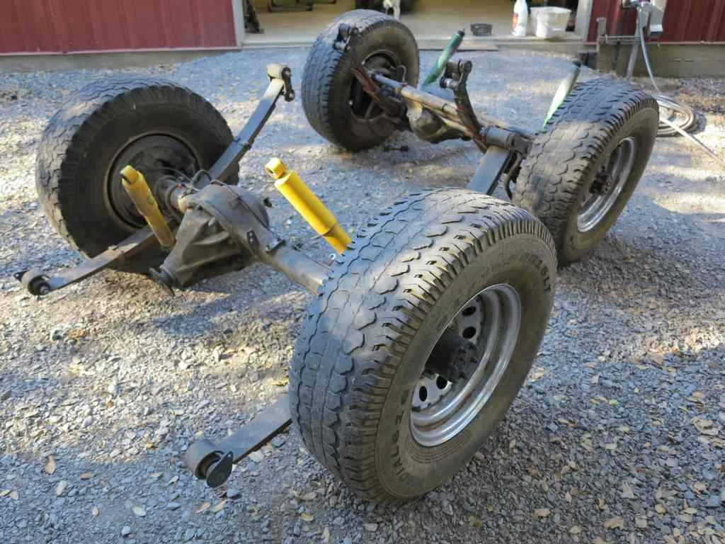

I had a pair of FF 70 series axles I sold awhile ago. LHD from Europe even! Could've sent it back your way! 🍻
