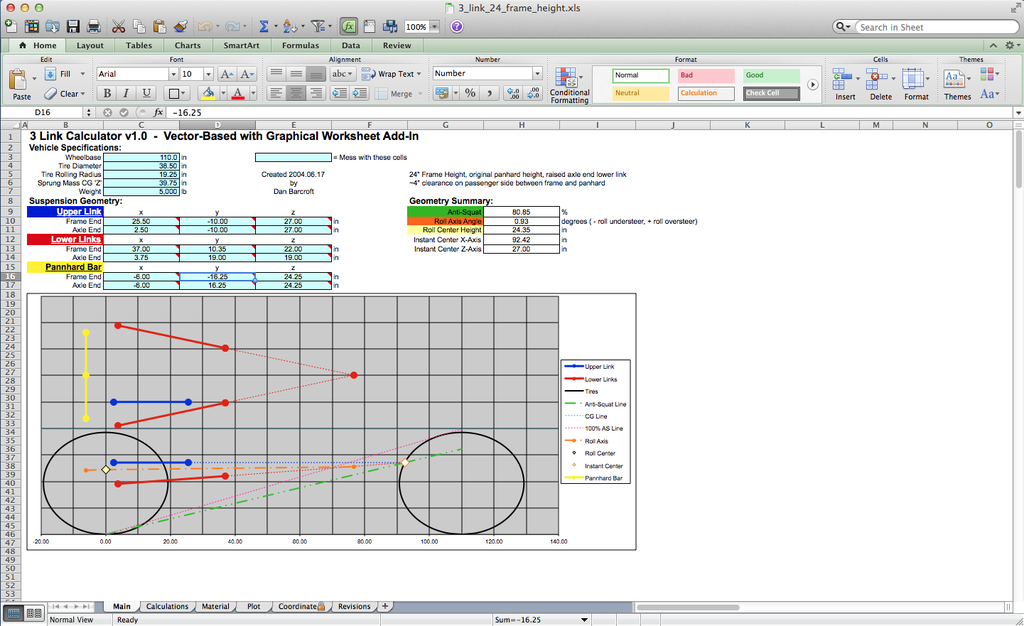

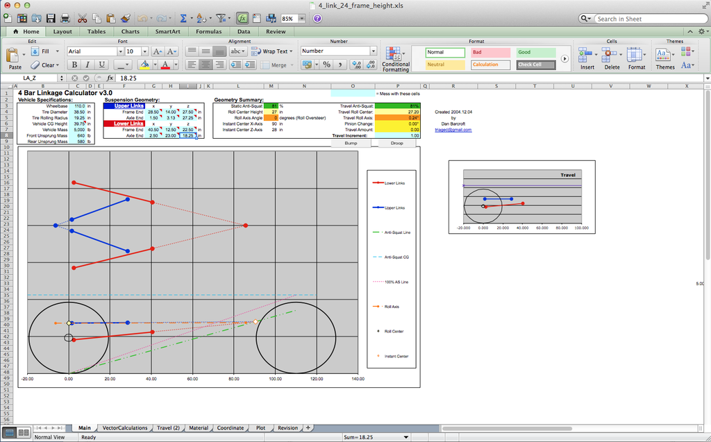

Yesterday was spent crawling around underneath to see where various link brackets could fit. After a lot of measuring, marking, remeasuring, and after several iterations of the spreadsheets, we came up with these first drafts (hopefully they are legible):
And:
