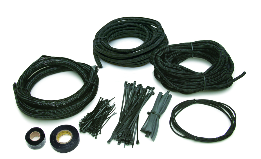

Wiring Harness After. I used Tesa Wire Loom Harness Tape for the wrap and purchased the Painless Power Braid Kit for a really clean look. Link below:
