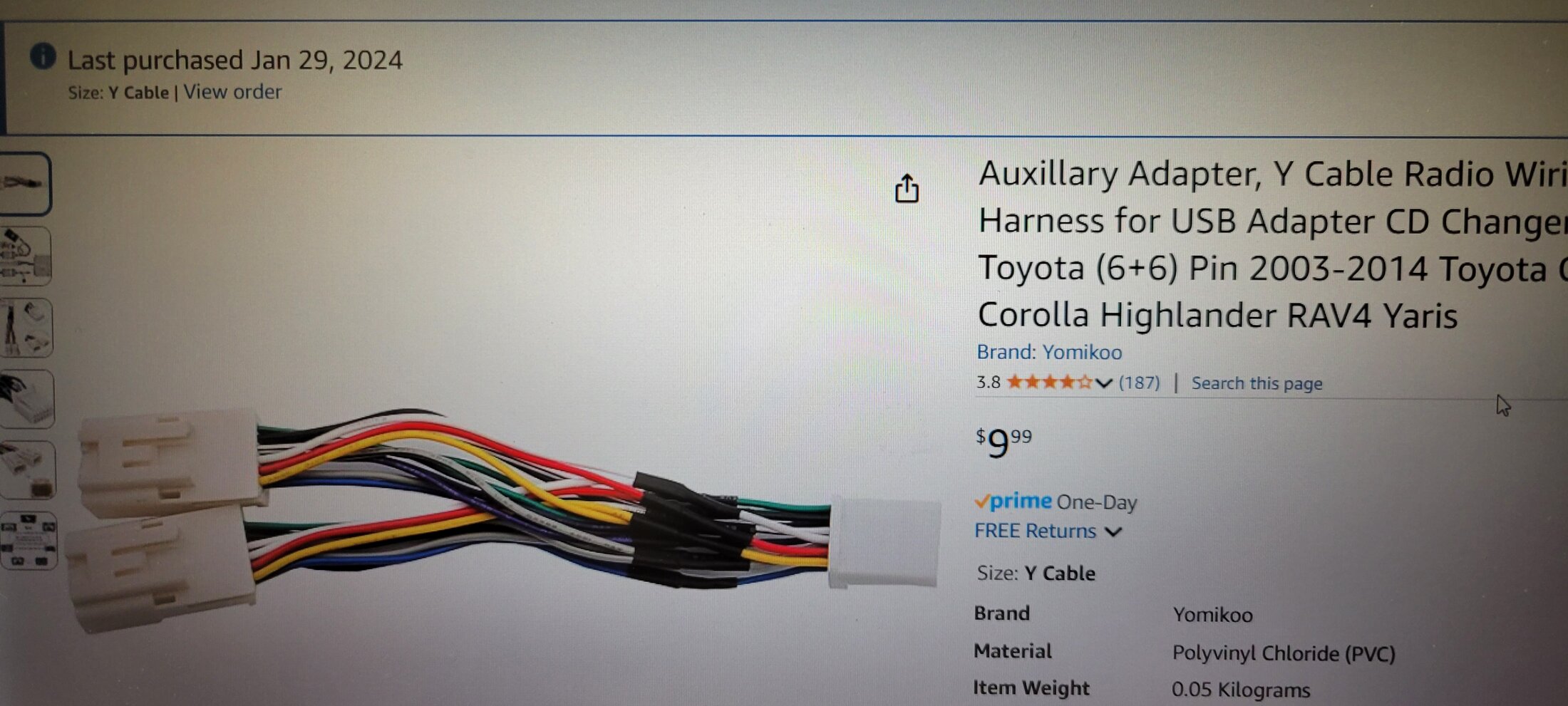

Hi, I just received the same bluetooth adaptor and plugged it in the CD changer port. I can get the bluetooth to connect to my iPhone but the head unit displays "external unit not connected" when I select the CD option on my head unit. I did not get the Y adaptor to keep the CD changer plugged in as well. Do you think that could be the issue? I'm glad to order one but just trying to make sure that is the problem first if you happen to know.
Unfortunately I don't know for sure. That would be my guess but I don't know. Sorry.
So do you have they Y adaptor installed or not?
Yes
Update - I installed the Y adaptor and the bluetooth does work! Sound quality is great. The only downside seems to be the volume level using this device is maybe 1/2 of sound volume compared to the old tape adaptor I was using. Cranked to max is fairly loud and will suffice most of the time as needed I suppose. Is this also your experience?

Update on my low volume issue. Did some digging around and saw someone post about a similar problem. Apparently the OEM bluetooth phone system can cause this problem if the volume is turned down for calling. So I paired my iPhone and started a call. Sure enough the volume was set to about 50% so I adjusted it up to max. The only way I know to access this feature is while making a call. It greatly increased my volume output to the stereo but not quite as loud as the tape adaptor. Close enough for me.
EDIT - sorry, just saw which Y cable I needed, ignore this!
Received my YATOUR bluetooth kit today, picked it up off ebay unused, and ordered a Y cable to retain use of CD changer.
