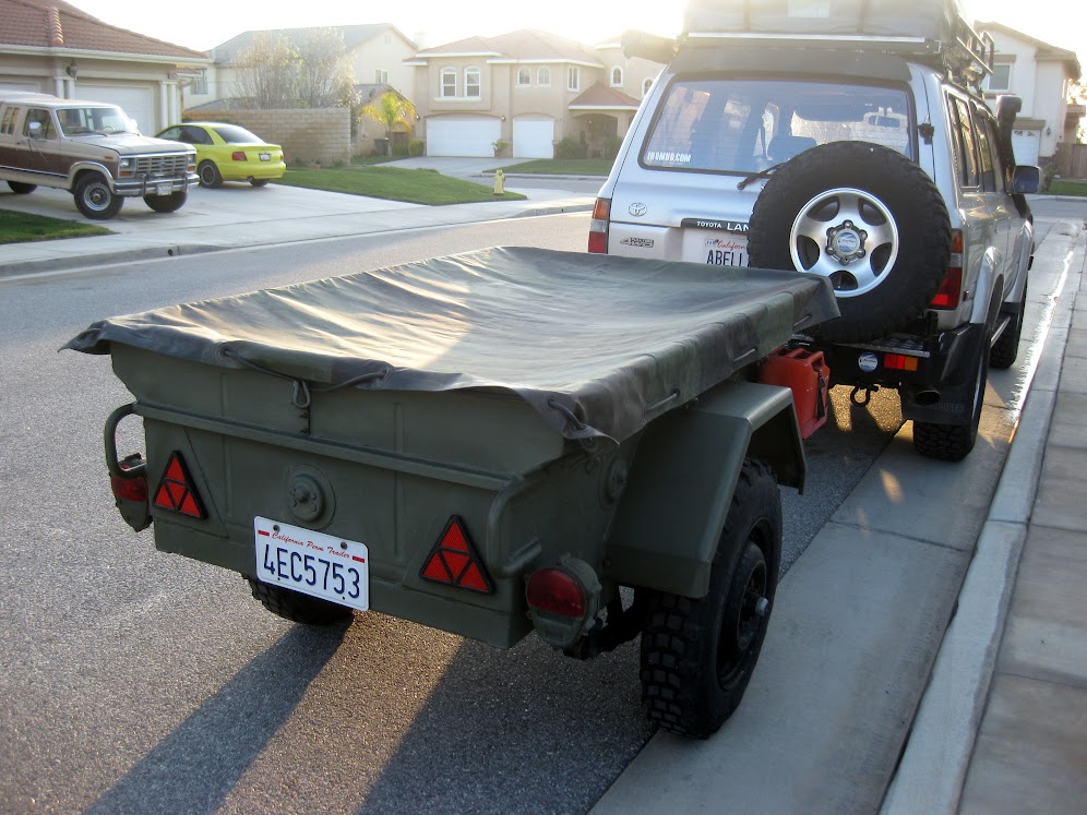

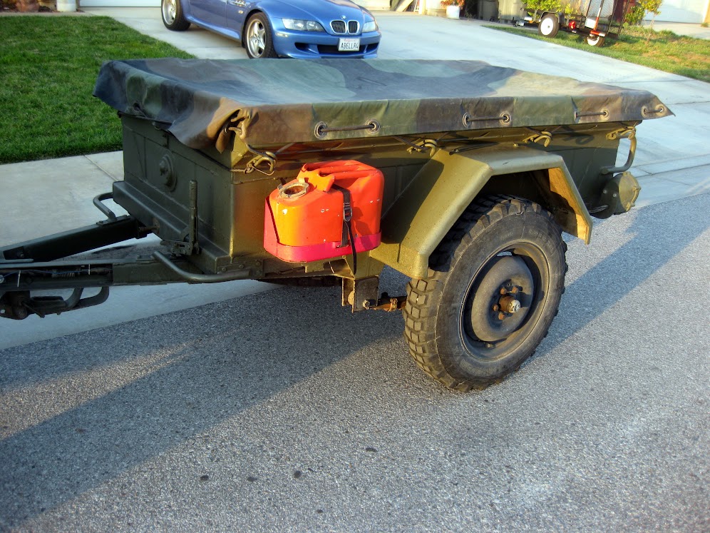

As many people might have seen from the Desert Rendezvous thread I'm now the proud owner of a M101 CDN trailer. I never got around to making any kind of build thread for my 80 and it just appears at different trips with random new modifications :hillbilly: so this time I'll try to at least document the build up on my trailer.
I've been searching for a 1/4 ton trailer for the last 2-3 years on various sites including my favorite Craiglist :grinpimp:. I've contacted a bunch of people and seen a lot of 1/4 tons in various conditions, mostly banged up, rusted, and overpriced. The last year or so I've been searching heavily looking multiple times a day on different sites. Late February I managed to find a post on Clist for a M101CDN located out in Bakersfield within hours of it being posted. The price was a little on the higher end of what I wanted to pay but it was exactly what I've been looking for. got pictures of the trailer (ad didn't have any) to find out that this thing was in really great condition. Owner promised to give me "first shot at it" since I was traveling from Menifee and was genuinely interested so I ran out to Bakersfield super early in the morning with cash in hand and pintle hitch attached to the truck. This is what I ended up pulling home.

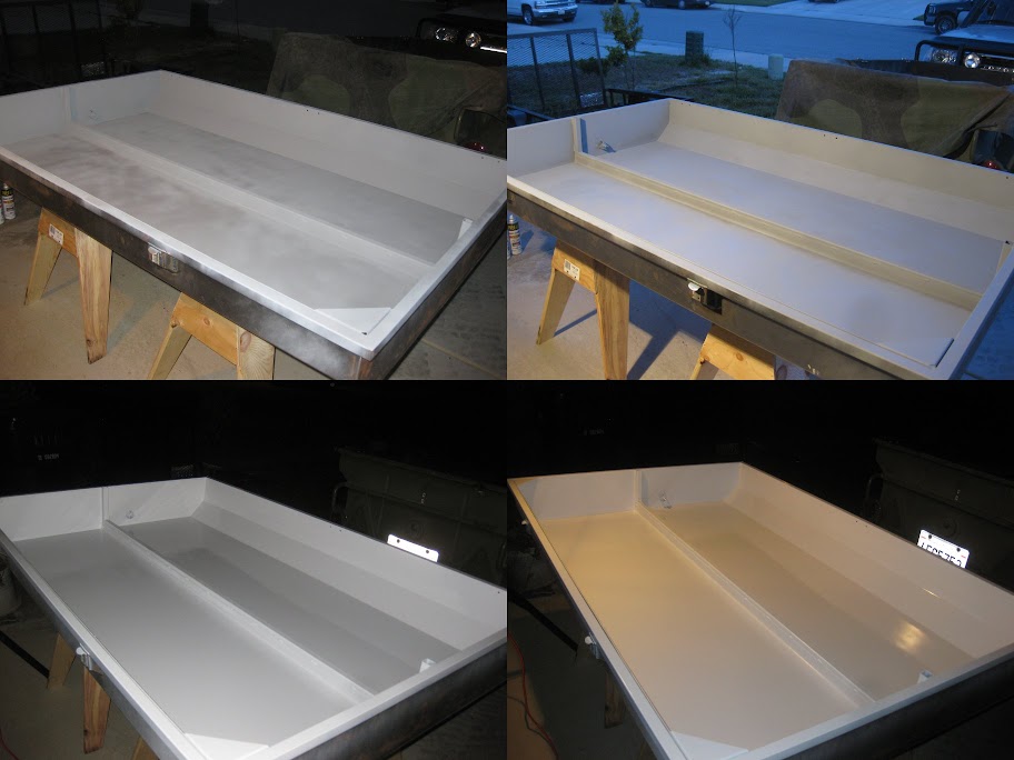

Was putting off painting the trailer until the lid was made so i wouldn't have to repaint the sections that get ground down and welded to.
Thinking of spray bombing the trailer to match the cruiser somewhat. Found two colors Krylon Khaki, and a Rustoleum "Dark Taupe" that fit the bill.
Leaning towards the rustoleum because its not as common and I've seen a bunch of Khaki military trailers and I'm not really a fan of flat paint.
Painted a couple tools i had laying around to compare it to my truck HERE . Thinking one of those colors and Black fenders/tie down / Frame/Tongue.
Maybe even copy how Brent painted the reinforced sections. I really dig the way his came out.

Just finished spraying the lid. fingers crossed that it comes out half way decent. sprayed the inside of the tub a couple days ago. white made the most sense.

What did you end up using for the interior of the tub?
